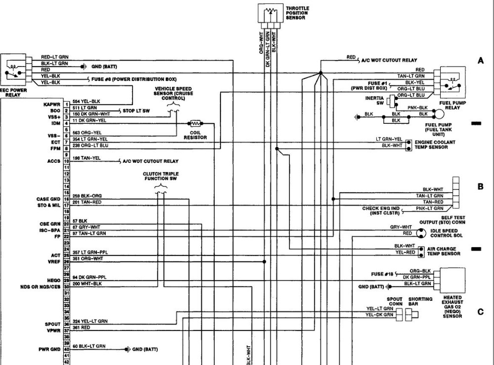

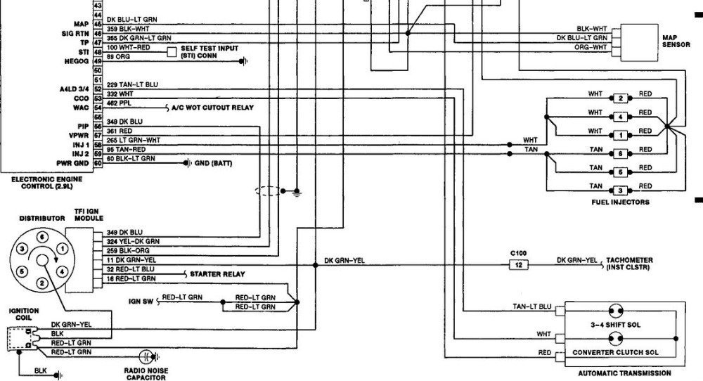

I have a fuel pressure gauge --what kind of tool are you talking about?? I saw one of SC,s video done on a GM with a fuel pump test plug and a tool -- mine does not have a test plug-but I could use the key on -off. I saw a schematic on another problem answer but can't seem to find it again--I need the color codes.
I also have another slight problem--the person who owned this before tore loose the main harness that contains all the injector and other sensor wires and is just laying on the hot lower manifold--I need to see something to show me where this was routed and to what ??

FIXED---took to garage and had it scanned --#5 fuel injector not pulsing correctly.
brought it home -tore off upper manifold -fuel rail, and injectors--went on U-tube saw how to make a fuel injector cleaner with just a 9 volt battery and a can of carb cleaner. cleaned all injectors put everything back and it runs really good now.
