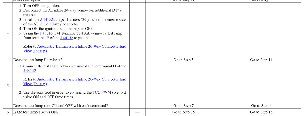

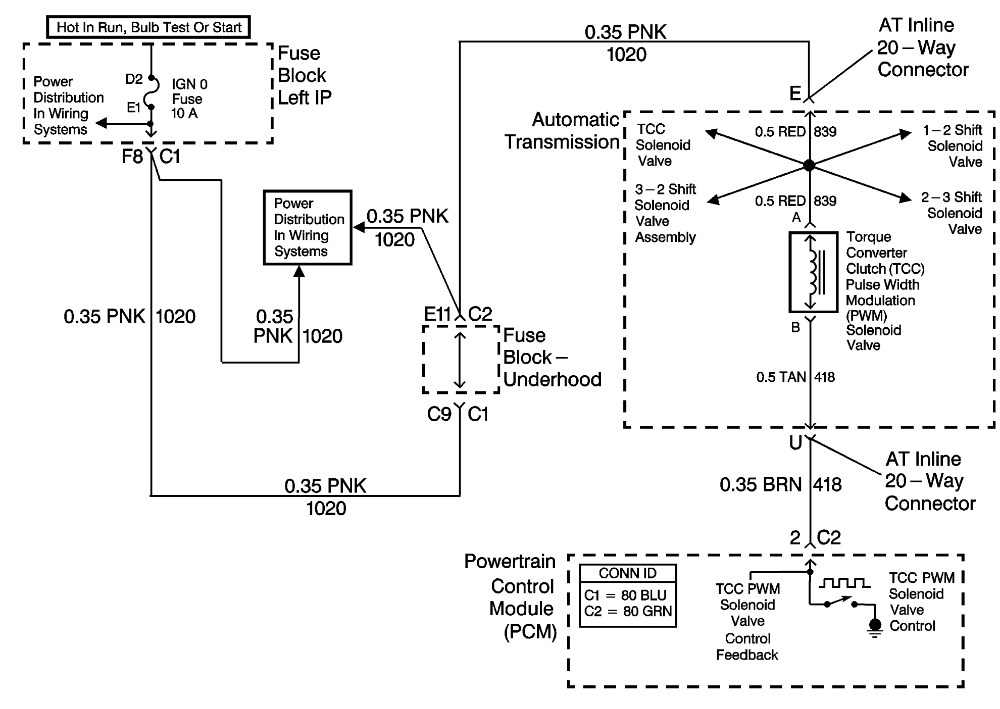

Hey lsstag! I grabbed the relevant wiring diagram for reference so others can follow along:
You didn't specify the donor vehicle for your custom car, so I took a guess at a 2003 Silverado SS. Service info for P1860 is specific about code set criteria:
Condition 1 The PCM commands the solenoid ON, 90 percent, and the voltage feedback remains high, B+.
Condition 2 The PCM commands the solenoid OFF, 0 percent, and the voltage feedback remains low, 0 volt.
To answer your question about the circuit, you'd need a scan tool to see what the TCC solenoid command is while the fault sets. My guess is it's gonna be condition 2, but it's worth checking the scan data anyway.
There's some steps in the P1860 flow chart that I think are worth following:
You probably don't have the special J-tools, and that's fine. All we really want to know is:
1.) Does pin E light a test light to ground? I know you already checked voltage, but we're looking for a loaded circuit test.
2.) What does a test light between pin E and U do during a bidirectional test?
Let us know what you find!

I took a look and my scan tool does not do bidirectional, but it looks like I can do it in HPTuners. What I have done so far was 1. disconnted the 13pin connector and used a test light (not LED type) between pin E and ground and I had light. 2. while the connector was still umplugged I put my test light between pins E and pin U on the harness side of the connector and cycled the PWN Solenoid from iside HPTuners. The test light stayed on all the time. 3. I became a parts changer and swapped out the PCM for another that I had and still the same code. 4. With the connector still disconected I did an OHM test beteen the two pins E and U on the transmission side to check the OHMS of the solenoid which read 10.2 OHMS. I am going to do a little more research today on the HPTuners side to make sure that what I was doing was indeed a bidirectional test. Thanks for all the advice and help.
1 year 10 months ago - 1 year 10 months ago #74976 by Tyler
Well damn, that sucks! Kinda what I was afraid of.
Don't sweat it. If you follow the flow chart in SI for 'light stays on', it ends in PCM replacement.
 Service info specifies 10-15 ohms for the TCC PWM solenoid, so I'd call that good.
If you were doing it with the engine running the first time, try key on engine off. Otherwise, I bet you were probably doing it right.

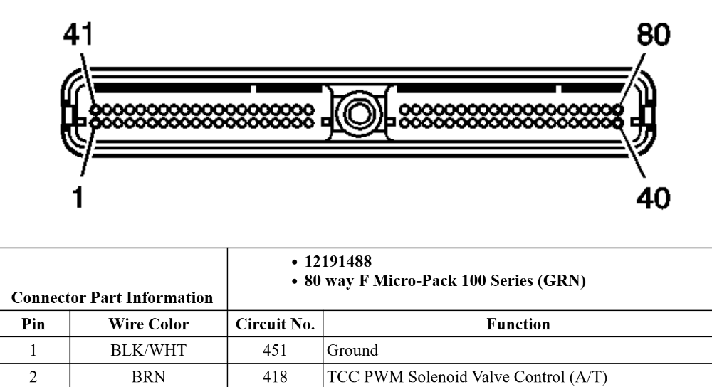

At this point I have to question the harness. Circuit #418 for the TCC PWM control goes from pin U at the transmission to pin #2 of connector 2. It sucks, but it may be time to ohm between pin U and pin #2 of C2. We want to make sure that circuit #418 is going to the correct pin at the PCM.

1 year 10 months ago #74977 by lsstag
HI Tyler,
Thanks for the response. Here we go...
The harness is a completly custom hand built harness I did. The power to the transmission has its own relay and fuse and is seperated from all other systems (actually each system coil, injectors , sensors are all on their own fuses and designated banks) using 18 AWG wire throught out. I do like your thoughts of doing an ohms test between the two pins just to see what I get, that is very easy to do. There was no doner car. The engine is a GM create engine and the transmission came directly from a transmission shop. Everything is based on a '99-'02 P01 Gen3 PCM which has the blue and red connectors.

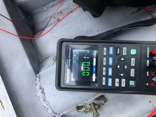

1 year 10 months ago #75971 by lsstag
Attachment not found
Hi Tyler,
I did more testing and this time I took screenshots. The first is the resistenance between the trans connector and pin2 of the PCM . The second was with the scantool you mentioned above and running the bi-directional test. Everything we have done all points to a bad PCM. I also manually activated the solenoid and I could hear it cliniing on and off as I pulsed it.
I am out of ideas here now other then PCM.
I would like to know the theroy and parameters that all go with how the PCM decides when to turn on and off the solenoid if you have that.
Thanks again for the time
Mike
1 year 10 months ago #76010 by Tyler
To be clear, you're still not seeing the test light flashing off and on while doing the bidirectional test? Isn't that frustrating...

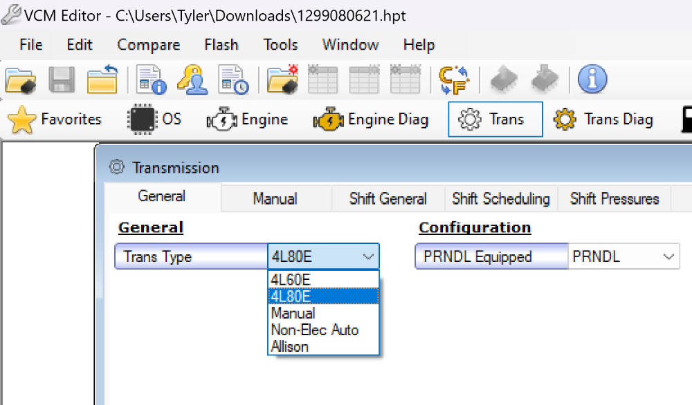

Good point on the PCM programming, I was also starting to look that way and do a deeper look into both the PCM and the transmission.
Thinking along those lines, I downloaded a 2000 Silverado 6.0L stock file from the HPTuners Tune Repository, just to have something to work with. I found the 'Trans Type' option under Trans -> General:
I don't know how comfy you are with VCM Editor? But I'd be interested to know which option is currently selected.

1 year 10 months ago #76456 by lsstag
Hi Tyler,
That was a good thought. I had already checked that out and its set to 4L60e
