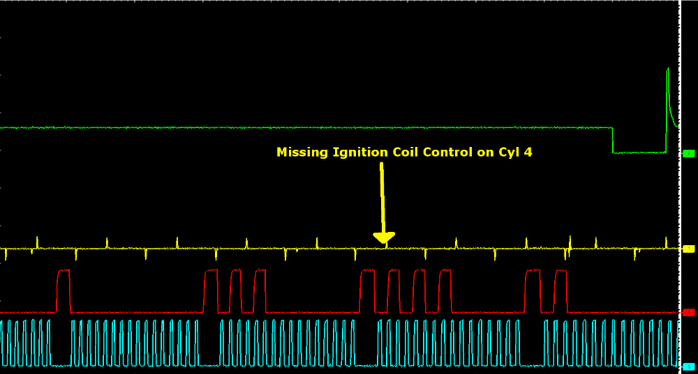

SYMPTOMS
Initial Cold Start, Normal Crank time, After initial startup, engine surges for a few seconds and then smooths out and runs great with no issues. This surging is actually a complete engine cut as if the crank sensor crapped out for a split second. NO CODES regardless how many times I duplicate the issue.

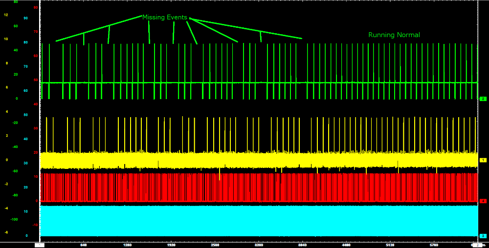

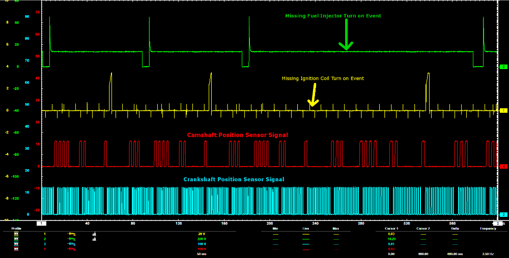

For the first few seconds of engine run time after initial startup, at random times the PCM doesn't send control to all 4 coils and all 4 injectors. According to the waveforms I attached, the cam sensor and crank sensor have no problems. I grabbed the cam and crank signals at the harness sensor connector and not at the pcm.
I have not tested 5v ref for consistency yet nor have I tested for consistent signals at the PCM
What do you guys think could cause the PCM to not send control? Remember, after 2-5 seconds of random no control, PCM eventually controls everything normal and engine runs great the entire time. This also seems to be a temperature related problem. As the engine heats up or after starting the car about 10+ times, the problem goes away but returns as everything cools off.
The ignition coils look like they have been replaced at some point recently. They are numbered and don't look factory. I need more background information on that.
All Cylinders, 1,2,3,4 show same problem at same exact moment
GREEN: INJECTOR CONTORL
YELLOW: COIL CONTORL
RED: CAM POSITION SENSOR
BLUE: CRANK POSITION SENSOR

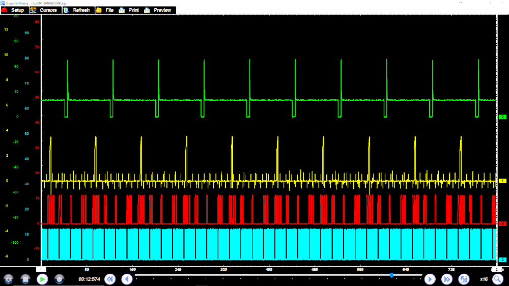

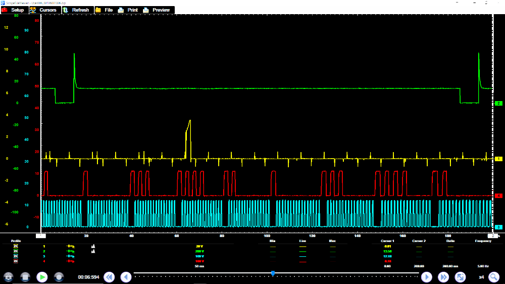

Waveform capture of Cylinder 1
All waveforms below are of cylinder 4.
Close up of missing ignition coil control, previous missing fuel injector control not shown and is off the screen to the left

Hmm.. So, if I understand what you have presented in that you're missing coil and injector control yet have good waveforms at the sensors.
This only occurs on start up? So, after a while everything starts to function correctly? If this is the case, I'm curious if there is a solding issue that gets better after the circuit warms up. Just brainstorming.
Assuming this, I would do the following:
See if the scan tool indicates either of these sensors are periodic. Sometimes the PCM will have a PID indicating it is operating with a good crank and cam sensor.
I would backprobe at the PCM to see if there is a wiring issue(s) are between PCM and sensors.
I would backprobe the PCM at the injector and coil controls to see if there is a wiring issue between PCM and actuators.
This is a good one that could eat up time, so I would try to find the macro issue first before going micro. I would try to determine if it is a wiring issue or is PCM having issues inside it. i find it interesting that after things warm up, all is good, meaning it sounds heat/vibration related
I'm so curious as to what you find out.

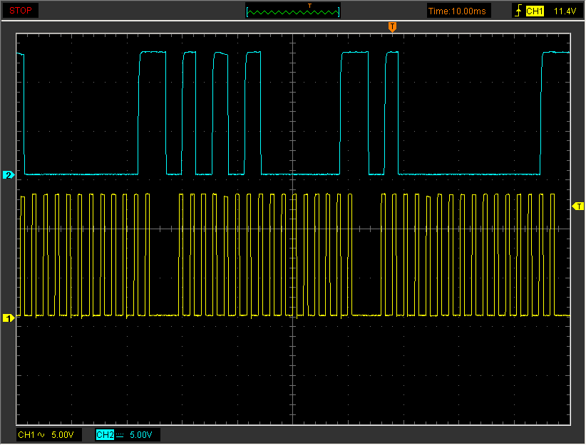

TESTs so far;
1. Cam Sensor Signal @ PCM 5ms Time Base (Close up view) = GOOD - No Irregularities, Square waves all look the same width and height.
2. Crank Sensor Signal @ PCM 5ms Time Base (Close up view)= GOOD - No Irregularities, Square waves all look the same width and height.
3. Knock Sensor Signal @ PCM 500ms Time Base = GOOD - 2.5v During Events
4. Checked 3 PCM Ground Wires = GOOD (Loaded)
5. Checked 3 PCM Batt+ Wires = GOOD (Loaded)
6. Disconnected PCM and plugged back in couple times, problem still persisted.

1. Look at all 4 coil control signals at the same time to confirm all drop at same time. I know they do, I just need reassurance.
2. Same test as above on injectors
3. Look at 2 coils and 2 injectors at a time of same cylinders to see when both drop out.

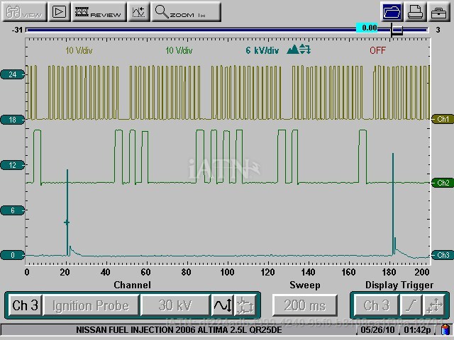

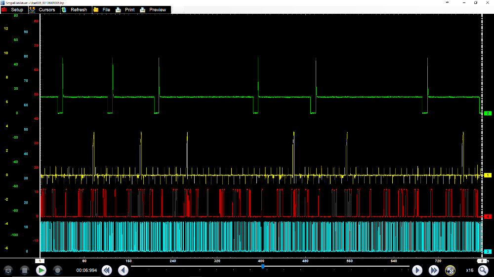

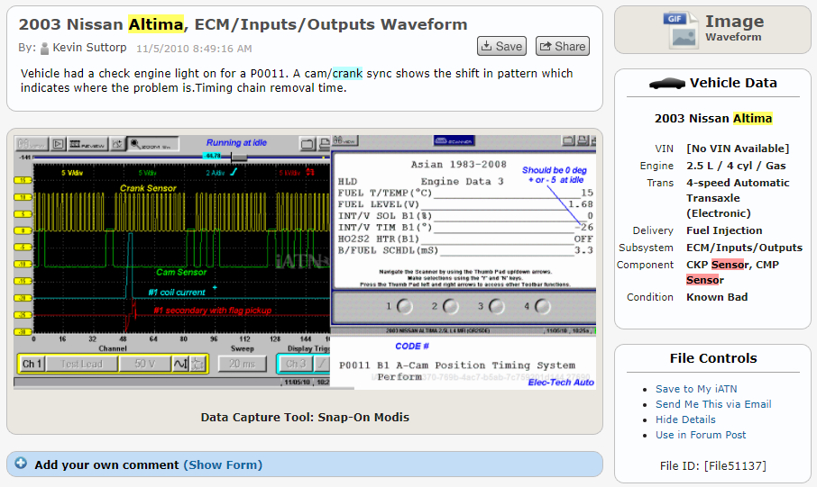

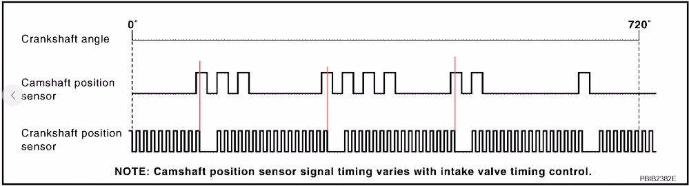

So I am leaning heavily on Crank and Cam Relationship. I missed this before and I did a test that seems to verify it as well. The oil is topped of as well as I do believe the tensioner run off oil pressure
Now I didn't decipher the PIDs very well in the scanner so it looked like there was no cam/crank relationship type of PIDs but according to a picture on IATN, there is and I noticed those pids just don't know the values. What I do know is my relationship is off compared to Nissans relationship waveform.
There other rough test I did was unplug the cam sensor and start the engine. Not knowing if it would actually start, it did. Long extended crank but smooth startup with no issue. Plug in the cam sensor and start it up and problem cam back. Now I already know the waveform integrity of the sensors are good so I wasn't confirming a bad sensor. Just the fact that it couldn't correlate the cam/crank sync and probably used some algorithm.
The other question is why does it cut control signals only for a few seconds, only during cold startups. After everything is warm there is no issues starting. Could this still be related to cam and crank relationship?
ALLDATA NISSAN GOOD WAVEFORM
IATN KNOWN GOOD
IATN KNOWN BAD
MY WAVEFORM

I haven't touch it for a couple days. The INT/V TIM DEG parameter at idle is -24 deg to -36 deg. I read this is supposed to be between -5 to +5 degrees. At 2000 rpm the same parameter is around +16-20 deg.
Could the idle timing be caused by a stretched chain and if the timing is that far off could it cause the computer to stop sending control?
When the engine runs good, the timing doesn't change much. maybe a few degrees difference. The -34 degrees is where it spikes to, it doesn't sit there.
The part of this only happening during cold starts is what is really throwing me off and especially for it to drop control. Since after it warms up timing is roughly the same. - 24 degrees
Last edit: 8 years 9 months ago by graywave.
  • graywave
8 years 9 months ago #16713 by graywave
Got approval. Timing Chain and all the components are being replaced next week. I will keep you all updated.
I did open a case with AllData and they explained if the timing is off enough, the computer gives up and stops sending control. We agreed that it seems this car is on the edge of being a crank no start situation. After sending them all my waveform files and gave them all the information I had, they too are leaning on the timing chain. Taking the cold start situation out of the equation and looking at the timing, its off and needs to be fixed. If it gets off any further, this is when a crank no start situation happens. Plug the cold start back in and it might be a oil priming situation on the hydraulic tensioner or the tensioner is fully extended since the timing does come back from -36 degree to -24 degrees after about a minute or so.
Also with these cars, I learned if it is a crank no start due to timing correlation, you can simply unplug the cam or crank sensor and the car should start after some extended cranking.

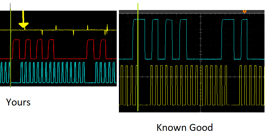

I was having a hard time comparing yours to the known good, so I cut this together real quick. Hope you don't mind.

I don't mind at all. Honestly I completely missed the timing portion of this problem in the waveform when I first scoped the engine strictly due to the fact that at a quick glance, the known good and mine are very close. So I at first thought the engine was in time. I also skipped right over the Intake valve timing PID in the scanner. Decided to take another look when it was mentioned by a forum member earlier in this thread.
