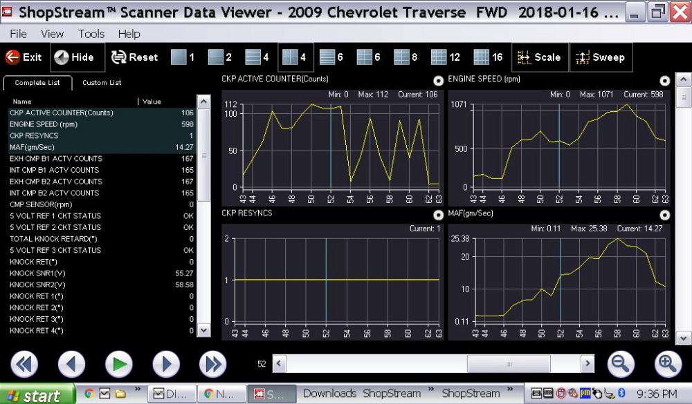

Got two new vehicles in the shop for diagnosis in the morning.
First a 2009 Chevy Traverse with a 3.6L GDI engine
DTC's
P0336 ckp performance
P0102 MAF low frequency
p0300 random misfire
Symptoms
Died on customer while driving, start and stall, loud rattling noise under hood when running, poor idle.
CKP active counters drop out and are erractic in live data, will attach screen shot.

So got them both diagnosed,
The Chevy, checked the ckp signal at the senor, was good. Checked at the PCM, good. Stopped my flow, checked relative compression with low amp probe and ckp signal, good. Took and oxygen sensor out on a hunch, ran better. Bank 1 converter was plugging the exhaust further downstream at the 3rd converter. The CKP performance code threw me off a little bit. Ha.

the traverse make sense with the maf code. it isnt seeing the right amount of air flow past the maf due to the clogged cat. had an s10 with a maf coode ended up needing a converter
