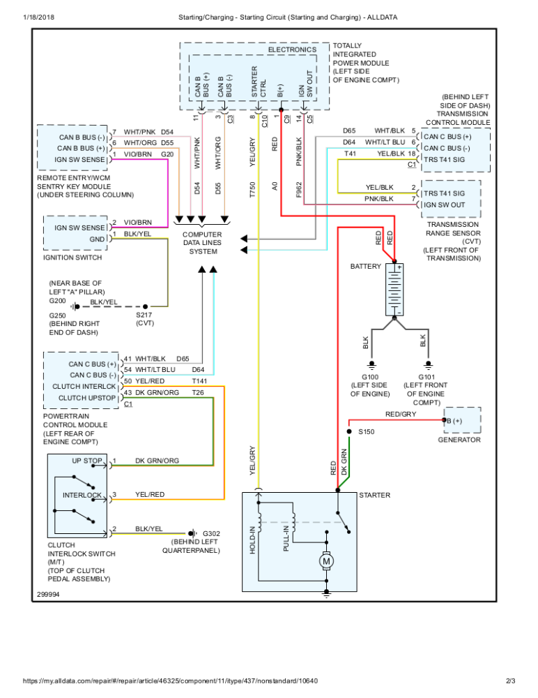

8 years 9 months ago - 8 years 9 months ago #16983 by Hydo
Hello i have been watching you vids for a few years now,been working on cars all my life.
2009 Dodge Caliber2.0 sxt umph..
About a month ago my daughter car wouldnt start intermittently unless we removed the ground cable and put it back on well one day it wouldnt turn off with key removed or remote starter.
I got car shutoff with unplugging the immobilzer bypass,now it wont start or turnover at all but all dash lites and head lites working fine,checked relays under drivers side fender,I removed the remote starter,checked all fuses all good.
Fuse #21 on the Tipm dead period.Its for the IOD Feed Intrus Mod/Siren (If Equipped).Almost forgot battery and starter working good.
Any help would be awsome.
Thanks

8 years 9 months ago - 8 years 9 months ago #16985 by arbez
Your going to have to do some electrical troubleshooting. Here is a wiring diagram:
www.revbase.com/BBBMotor/Wd/DownloadPdf?id=169820
It has that evil, 4 letter word (TIPM), in it that causes all kinds of issues.
Do you have a starter fuse and/or relay in the TIPM? If so, we can do some testing from there.

8 years 9 months ago #16991 by Hydo
I jumped the starter started but stopped asap,starter relay i beleave is behind fender and fuel pump relay is built into the TIPM.

8 years 9 months ago #16997 by arbez
Let's pretend that I'm not standing there, looking over your shoulder.
I think you should elaborate on what you have disconnected, disabled or bypassed. Likely that this is at least part of your problems.
I would chase the no crank first & hope that is related to your other issues. Once we get it cranking, than we need to see why it wont stay running.
Please verify if you have a independent starter relay. Then we can go from there.

8 years 9 months ago #16999 by arbez
AllData says that the starter relay is integrated into the TIPM also.
I'm pretty sure I've done starter relay bypasses on these also. Not necessarily a Caliber, but some Chrysler or VW car/truck/van/thing/it.
Check & see if yours has a separate relay. AllData could be wrong (that never happens).

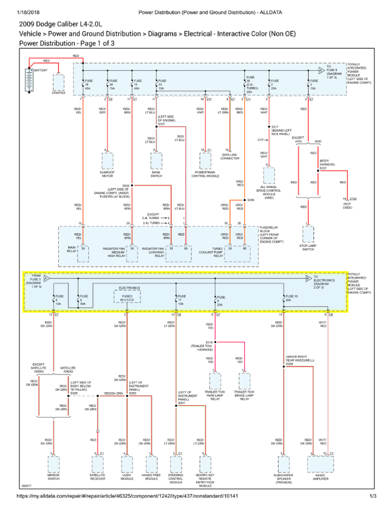

8 years 9 months ago #17004 by Hydo
What is this ?

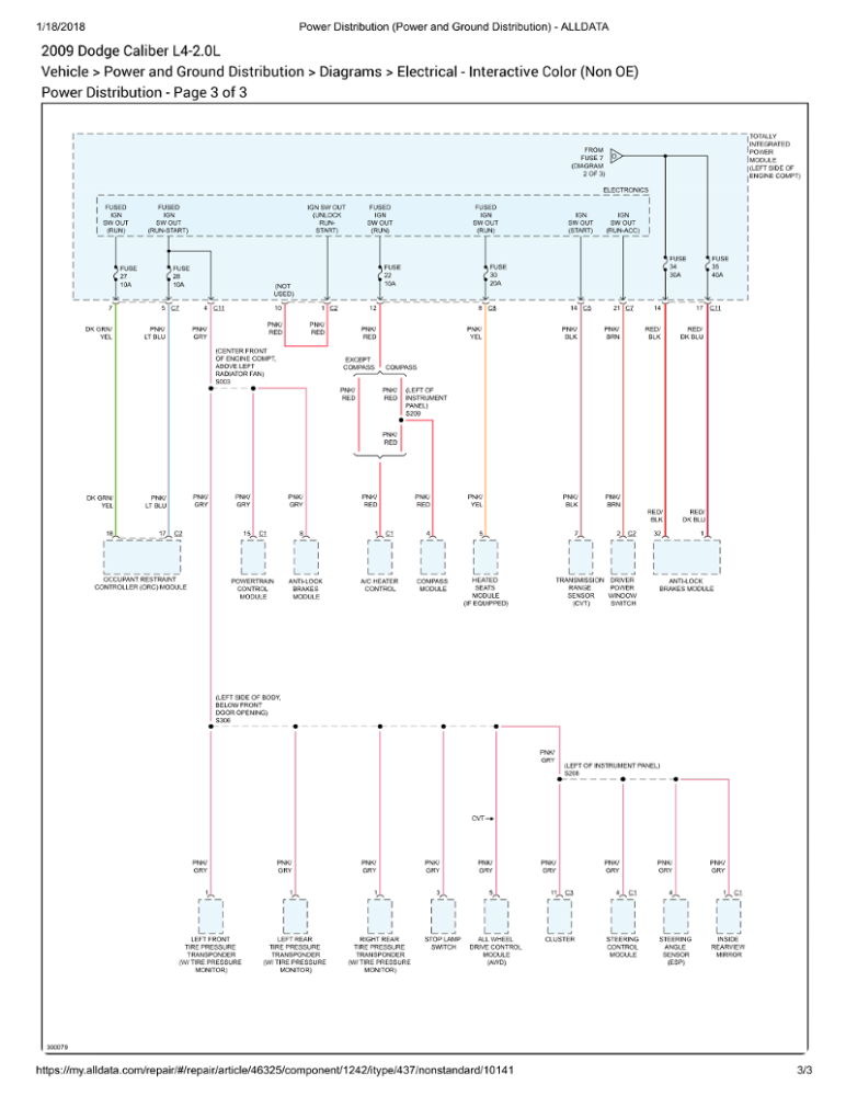

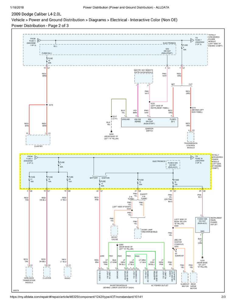

8 years 9 months ago - 8 years 9 months ago #17009 by graywave
If you are not getting any power on Fuse 21 than I would check Fuse 7. You could also check all other fuses being supplied power from #7.
IOD is the Ignition Off Draw circuit. Used to supply power to many different modules. During shipment fuses 7 and 8 are removed to reduce battery drain.

8 years 9 months ago #17010 by graywave
Any cheapo scanner should work. You just want to know if the computer is setting any DTCs that might trace back to your problem. Does your blue tooth scanner have live data?
When you turn your key on to the RUN position, does the engine light turn on? If so, at least the computer is technically powered up, if not could be a power issue.

8 years 9 months ago - 8 years 9 months ago #17011 by graywave
The starter relay should be located in the TIPM. If it is not accessible behind the cover, than its internal and can not be tested physically.
1. Check ALL Fuses with Key ON Engine OFF and let us know which ones do not have power.

Hello thanks for your help,I found a few things out today.
The obd scanner isnt reading any data,I also found a a power wire from battery to TIPM rubbed thru near metal.
I also unplugged plug from igntion switch,got power from the red wire.unplugged ecu couldnt find power there.
