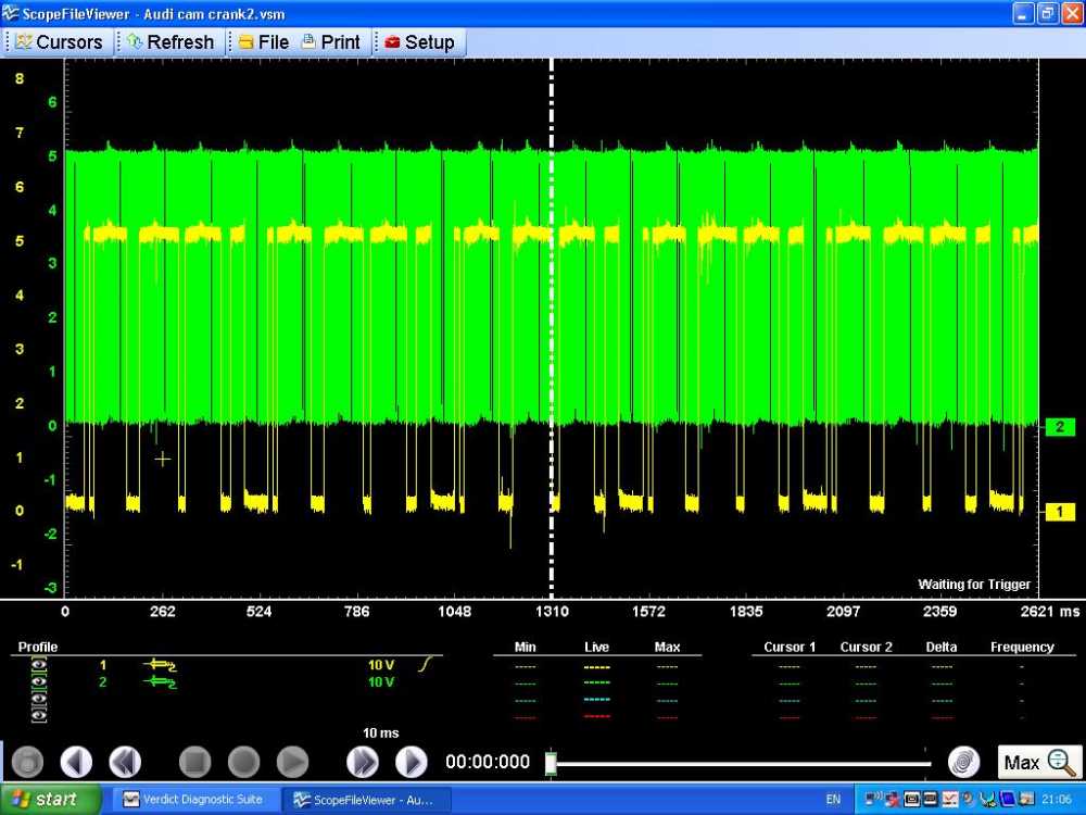

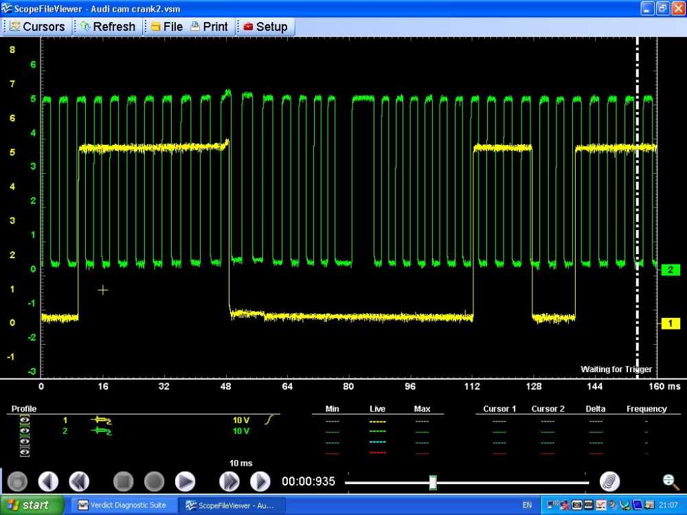

Hi everyone.
Does anyone have a known good cam/crank waveform for a 2.0 diesel Audi A4. Might be same a 2.0 for VW?
Thanks
Thanks

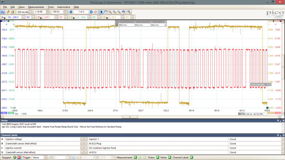

9 years 11 months ago #1819
by Doc
Replied by Doc on topic Audi A4 2006
Hi Mark, do you have an engine code?
Cheers
Cheers

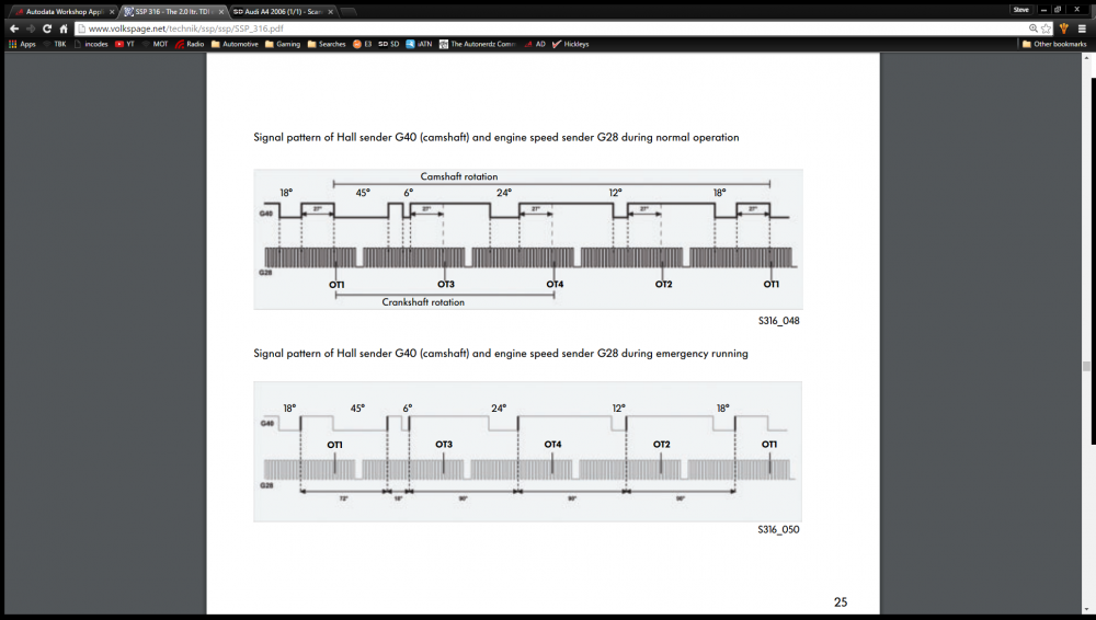

- Doc
- Sharing the little I know
- Posts: 58
- Thank you received: 12
9 years 11 months ago - 9 years 11 months ago #1822
by Doc
Last edit: 9 years 11 months ago by Doc. Reason: added hyperlink

- Doc
- Posts: 58
9 years 11 months ago #1836
by Doc
- Markm6164
- Posts: 10
9 years 11 months ago #1837
by Markm6164
Replied by Markm6164 on topic Audi A4 2006
Thank you Doc for posting this waveform.
