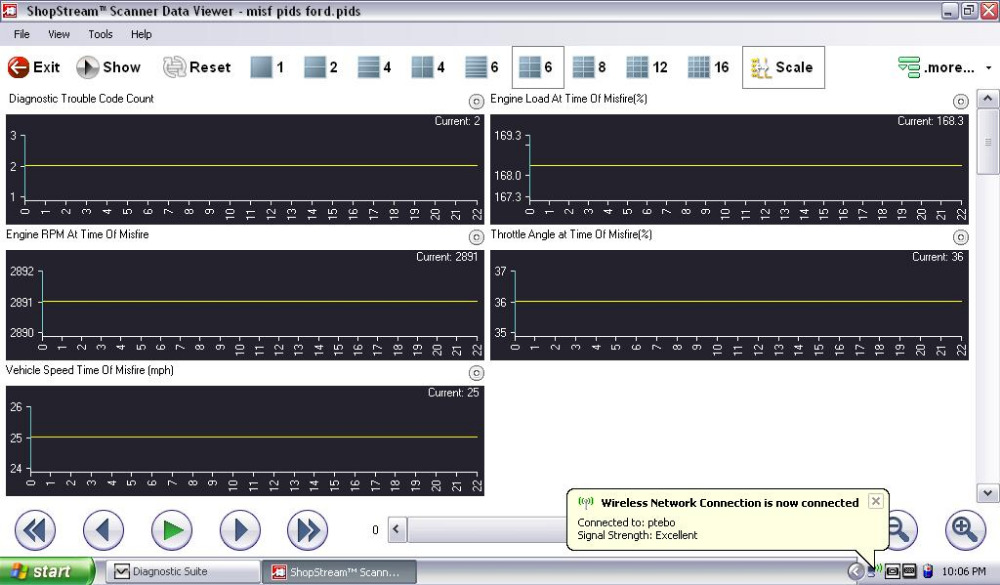

Hi guys. I need some direction with this one. The truck is setting p0302 and p0305 under heavy acceleration. data shows primarily cylinder five misfiring. Only history I have is the truck has had all six ignition coils replaced and all six spark plugs for these same two codes. I`v inspected spark plugs and coils for carbon tracking cracks gap etc. I performed the fuel injector flow test with scan tool and it is 158 normal is 160 +/- 15 Engine cranks like it has good compression and also performed ford`s relative compression scan tool function and found no problems there. Im really not sure where to go next. I`v tried the wiggle test on the wiring harness and found no issues. I need some direction. The only way I can duplicate it is to drive it and heavily accelerate once already going about 25 and i can feel it misfiring badly. Not sure what to do If I should run wires through the hood to scope injector or secondary ignition under load... three wire coil so cant look at primary side. only related technical service bulletins I can find dont REALLY apply. I`m in Arizona and the one bulletin says if its not humid / damp then the bulletin does not apply. But it also addresses the misfire under load symptom... TSB 13-08-01 - Effective Aug 5 2013

Hey ptebo1! I've seen that TSB before... Has something to do with replacing the charge air cooler with an updated version, correct? I always consider it when I have one of these misfiring, but have yet to see it genuinely apply.
I'd suggest a few things. First off, use the scanner to perform the crankshaft variance relearn. It's under Functional Tests, and will have you snap the throttle several times in Park. Then, clear the codes and go for another test drive. See if the same codes come back. It's been my experience on the 3.5L EcoBoost that the misfire monitor will easily flag the wrong cylinder, which gets resolved with a relearn. Chased my tail with this before. :silly:
Second, depending on which codes you get back after the crankshaft relearn, I'd suggest moving plugs and coils around. I see that they've been replaced, but the high cylinder pressures made these very sensitive to ignition problems. Plus, the 168% Engine Load at the time of the misfire says there was some boost at work.
I also saw that you inspected plug gap. I really don't mean to nitpick, but did you actually measure the gap with a gauge? Been there before, too. :lol:

Ok you were right Tyler. I went over tonight and the first thing I did was remove the intercooler expecting to dump out a bunch of water from it. I was thinking that under load the turbos put enough boost to push enough water to cause the air/fuel mixture not to ignite. Not even a drop of water came out of it. I looked up the spark plug gap with ford tech info spec is .028 - .037 - I pulled cylinder 5 spark plug to check the gap and found that it was gapped at .050.. ((
The guy also told me that the auto zone guy looked up spec. and gapped them all for him
)) almost double factory spec. So I re-gapped all of the plugs to .028. I re-installed everything. swapped #4 and #5 ignition coil - performed the misfire monitor neutral profile or whatever ford calls it procedure. test drove the vehicle under the same condition which I was able to duplicate the misfire before and it is completely gone!! I cant reference them off the top of my head but I know scanner danner has some great secondary ignition videos where he explains higher cylinder pressures making it harder for the spark to jump the gap. That explains why this engine has such a small gap size at .028. Honestly I dont even think I would have brought my spark plug gapper had you not responded to my post. Thank you very much Tyler. What a co-incidence that the same two codes popped up before and after plug and coil change though right?
