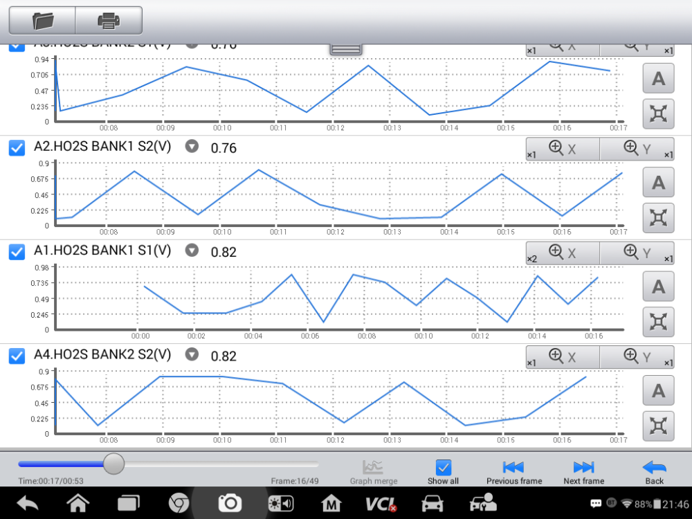

Recently, i've changed both upstream O2-Sensors because the heater was broken on both. After few days, the P0431 came up (Warm Up Catalyst Efficiency Below Threshold- Bank2). The car has 213'000 Km (133'000 miles)
How can i check if the catalytic converter is bad or the Downstream-sensor at bank2?
In the attatchment, i have stored the freeze-frame datas and recorded live-datas from all 4 O2 sensors.
Can somebody help me?

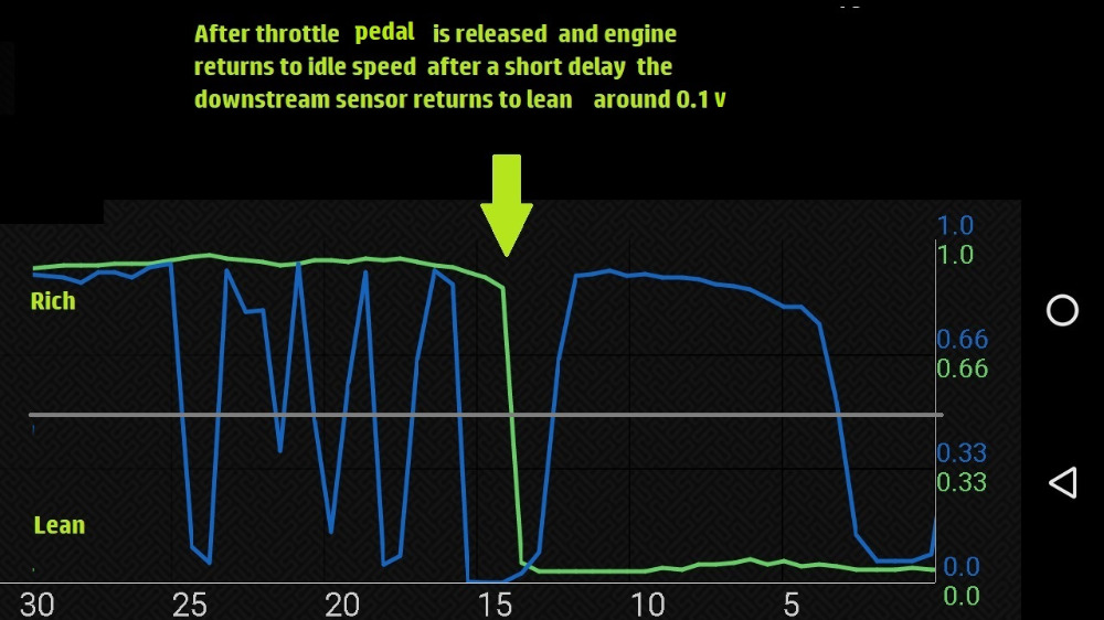

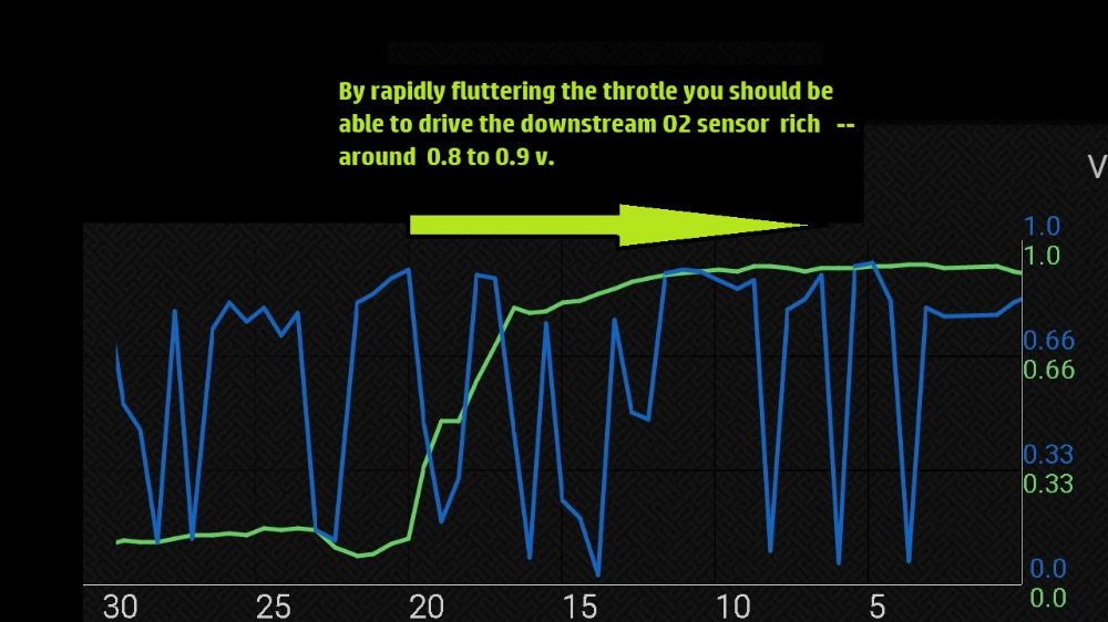

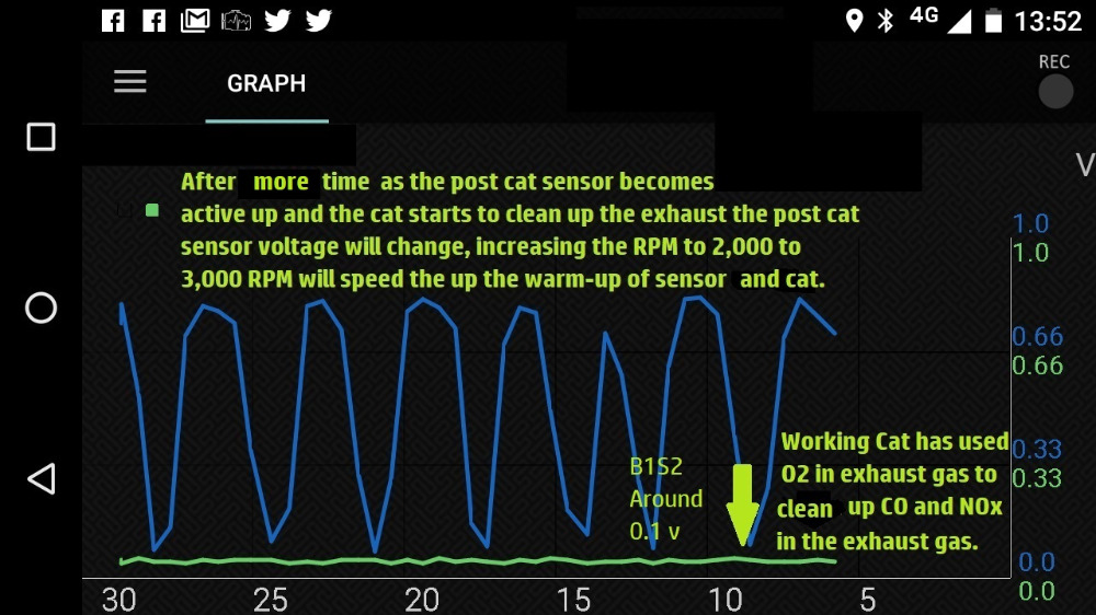

The post cat sensor B1S2 looks a bit too Up-Down active to me which likely explains your catalyst efficiency codes,
At normal idle engine fully warm I would expect the pre-cat senors to continuously go up and down between about 0.9 and 0.1 volts and back to 0.9 volts in just over a second. To put another way upstream sensor should look like the Alps -- very "jaggy" mountains. The downstream sensor should be relatively inactive more like flat land with high plateaus without the " jaggies".
The first screen capture below is normal idle from a known good high vehicle with 120,000 miles on it which gave excellent tail pipe test results.
But to test the cats properly you need to use propane added into the air intake force the fuel air ratio rich for long enough to drive the fuel trims lean then suddenly stop the propane to allow it to go suddenly lean and watch how the post cat sensors B1S and B2S" respond. You can do this by introducing propane into the intake
For the full procedure see this video from the Scannerdanner Youtube Channel.

Definitely do the testing that Andy suggested. If the catalyst is truly bad, you'll see a noticeable difference in the oxygen storage of bank two.
This doesn't look like a bad downstream sensor to me, but it's possible. In addition to the O2 storage, I'd also suggest clearing the codes and rerunning the catalyst monitor. If you can now get it to pass with no codes, then that would suggest a component is just on the borderline of failure.
Depending on where the downstream sensors are located, you could also try moving them bank-to-bank and see if the code follows the sensor.

Hi all,
I did the test with propane today. as far i can see, both past-cat sensors reacting nearly identical (almost no storage-time of the propane). But it's hard to say with my Autel diagnostic scanner. I don't have a picoscope right now and with my bench-scope i can't record signals.
Without propane and at idle (engine is fully warmed up): the past-cat sensors showing almost the same signals as the pre-cat sensors. But i've noticed, that both past-cat sensors showing fully rich at idle, after the engine was running at higher rpm for a few seconds. after 2-3 minutes at idle, both past-cat sensors starting to oscillate again. I whould say, this vehicle Needs two catalytic-converters. What do you say?
BR Matthias

8 years 9 months ago #17345 by Andy.MacFadyen
Replied by Andy.MacFadyen on topic P0431 2004 Mitsubishi Outlander 2.4 Mivec
Looks like you opened the box and the cat is deceased.
The captures in my reply were taken with a cheap eBay Elm327 clone and the Car Doctor Pro Android app.
