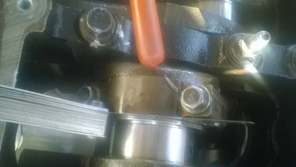

OK so i'm trying to put this engine together and i'm having problems with the connecting rods at first it was the bearing clearance had to take it back to the machine shop. Now its the side clearance when i torque it down its tight question is am i doing this right. I need to know if the feeler gauge is in the right spot or do i need to check it where the orange handle is .
