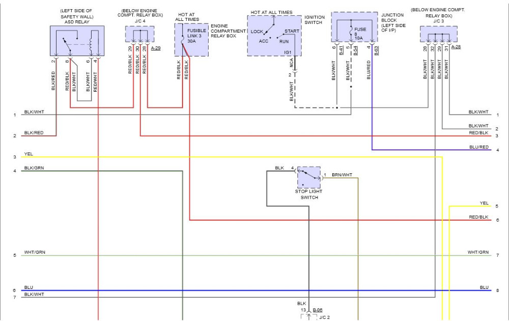

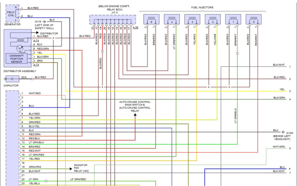

What engine (8th vin digit)? Coupe or Convertible? (edit: Never mind, it must be the 2.5L Vin N , correct?) I will post Schematics, soon.
Seeing positive (battery) voltage on both injector wires is normal. This video will help you understand why. Time Marker 17:30 draws it out. You will see battery voltage on both wires until the computer pulses a ground, to activate the injector.

Great video I've downloaded the schematics and put them together and mapped out all the components that would come in to play but donthave the knowledge of knowing the flow to chase any possible bad wires etc. Where next. Is there a video that would talk me through diagnosing from here. Thanks
