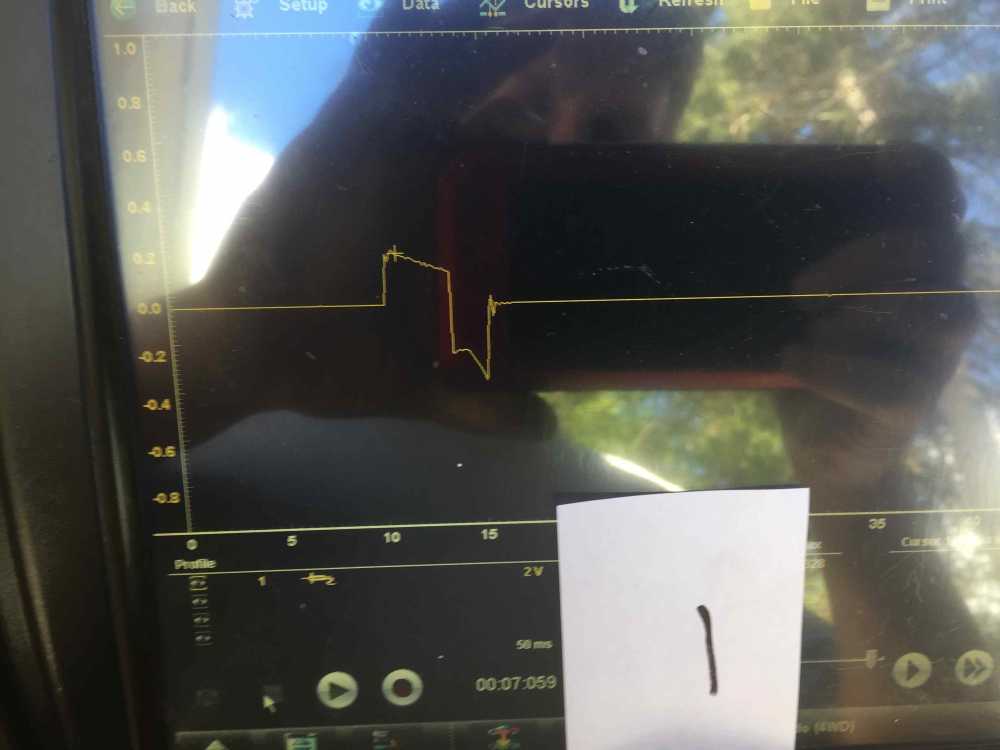

Hey guys I have a 04 chev truck 5.3 engine vin T with p0300 random misfire code. Most of misfires are on cyl 1-5-6 fuel trims are +or- 5%.
Misfires both cold and hot..
idle and under load
Maf G/s 5.5 @ idle
Map i think it was around 18"
fuel pressure 49 psi running
plugs & wires 4 years old not alot of miles since changed all AC Delco parts
Did injector balance test. they all passed
I dont remember all of the freeze frame data but it was under a load at 195 temp any other data that you may want I can get
Give me some direction please. I am at a fork in the road and not sure which way to turn. :ohmy:
Any help is much appreciated
Experience doesn't cost it pays

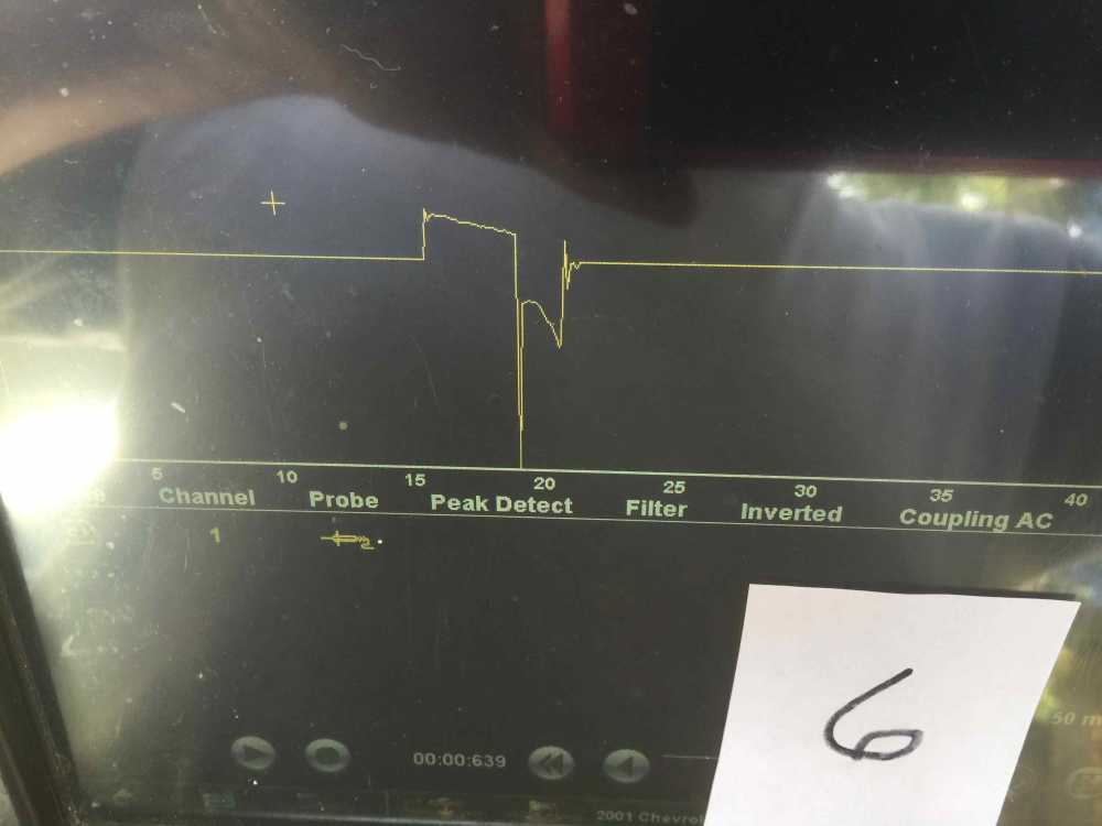

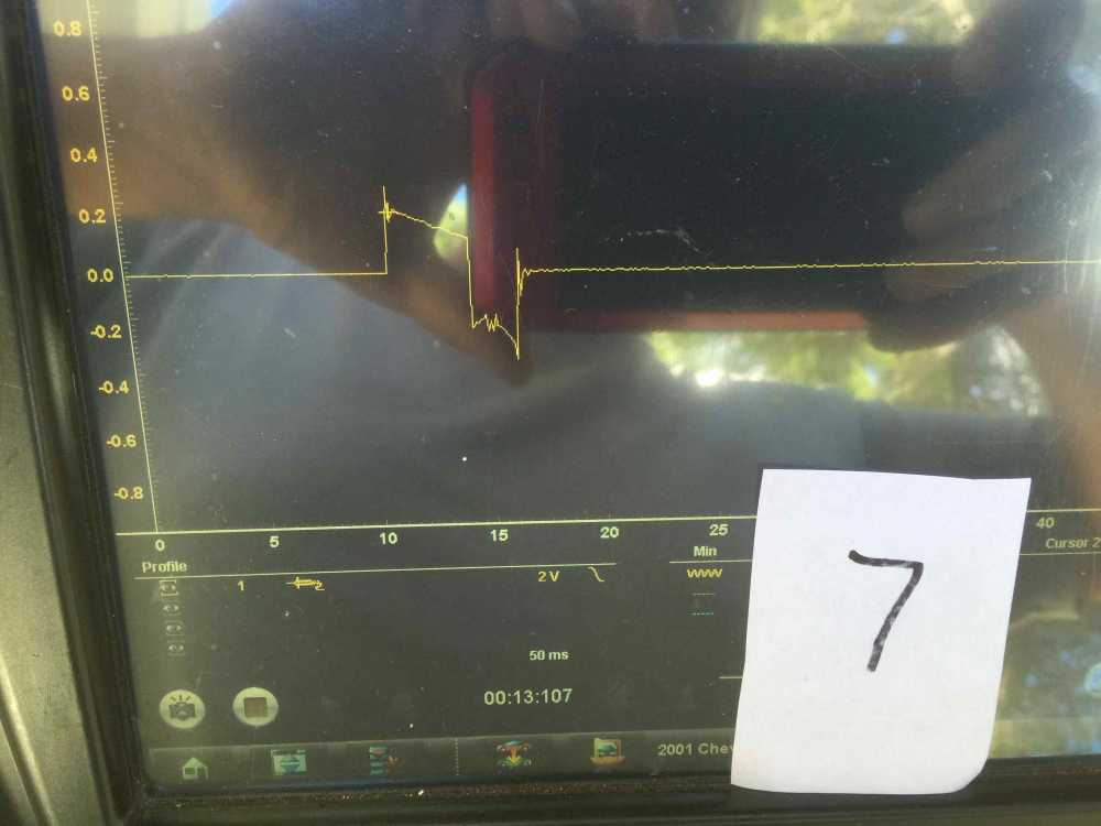

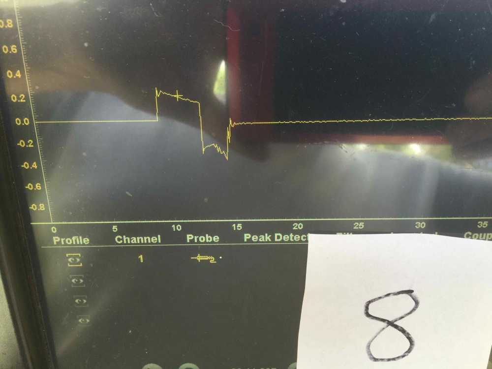

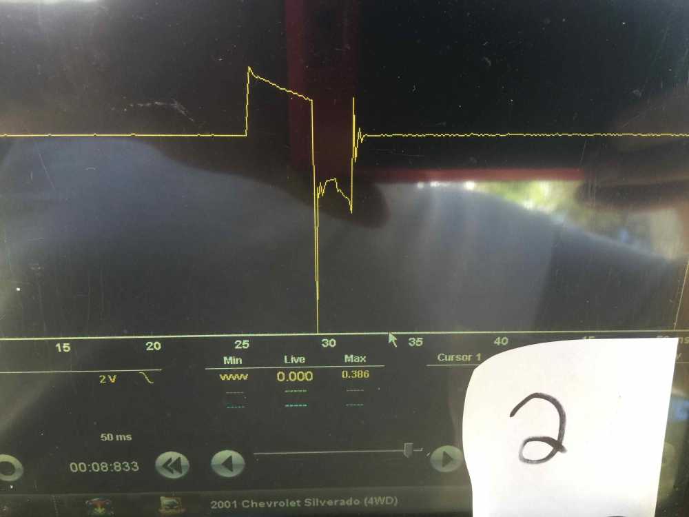

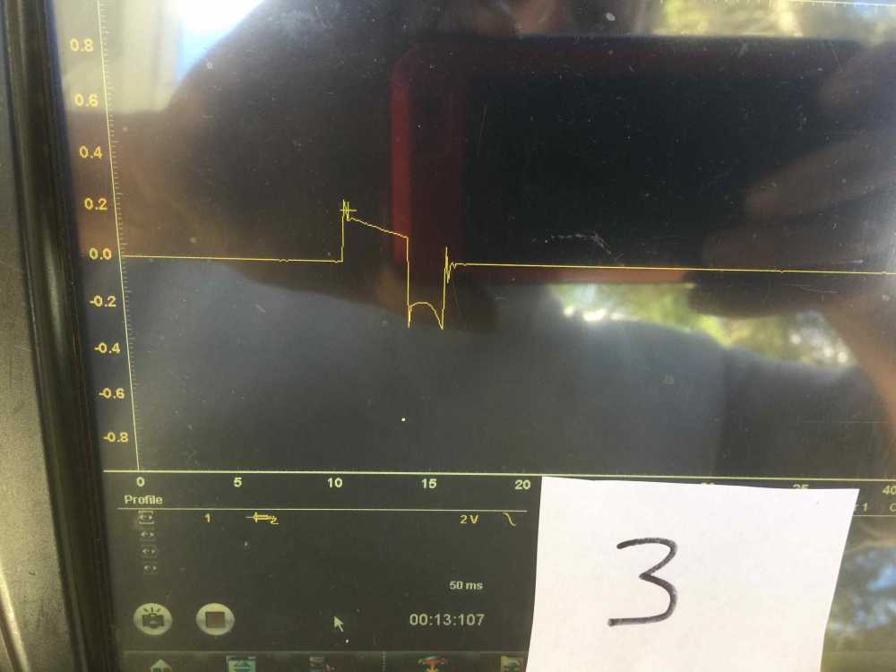

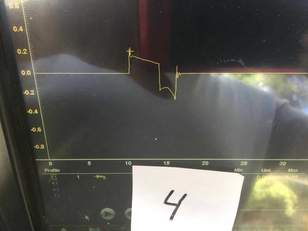

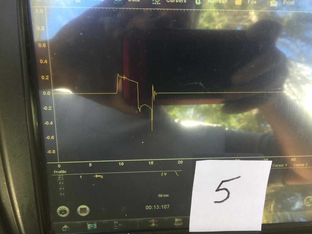

Any ideas on how to post pictures on here I tried 4 times and nothing happens. After spending all day trying to figure this out with no luck. as a last ditch effort I swapped plugs and wires from my Tahoe and it didn't change anything, I didn't think it would but I am at the point of saying F it I cant fix it, But I cant do that I have never given up on anything.
The most misfire was on #6 then 5 and 1. The other cyl had a few of them but not that many.
I checked the crank and cam they have no drop outs
I checked amps on bank 2 with a 1 min frame rate and I could see drop outs but not sure if that was scope aliasing because when I went 50ms I didn't have any drop outs.
Not sure where to go from here I have secondary waves that I have questions about I dont think they look good

I sent you the pictures of the waves
Thanks
9 years 11 months ago #1900 by Tyler
Replied by Tyler on topic o4 chev truck misfire
Got 'em, thanks sir!
It looks like the firing line is missing in some of the shots, but I think that has more to do with the scope's sample rate. Turning peak detect on will improve the level of detail in your ignition captures.
Aside from that, all these seem to be fairly normal secondary waveforms. I'd totally welcome a second opinion if someone sees something I missed. Was the misfire taking place when you took these?

I sent Paul a picture last night on Facebook and he said that it was inverted, but its not, I thought the same thing when I took these and I inverted them and they look really weird.
Yes it was misfiring when this capture was taken if you look at 6 5 and 2 the cyl I am having problems with the most, they have a downward spike, not sure why, it should go up. And if you look at cyl 6 scope settings I don't have it inverted.
If it will help I will retake them.
I tried taking primary side but can only do 1 bank at a time if I connect to the fuse its a mess with the fuel injectors in there to
I knew it wouldn't make a difference but I swapped the 3 plugs and wires with my Tahoe and didn't make a difference
Thanks
