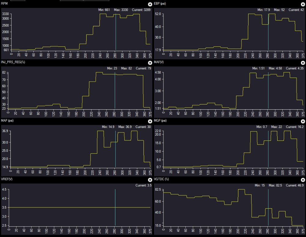

So, now that we know what the problem was, could we see it in the data? Genuine question. I thought this shot might be a clue.
Wondering if the VGTDC% swinging back and forth is the indication that the PCM is chasing it's tail. :huh:

8 years 8 months ago #18039 by Ben
Yes I agree with you, the manifold pressure and vgt do show the lag but without a known good I wasn't sure if this was just turbo lag or a turbo issue. As far as how hard to sell I actually just purchased this truck from a dealer that didn't know what was wrong with it they thought it had a transmission issues.... it just had very low power with the boost issue and it also had 2 bad injectors for reference cylinder contribution showed them at worst about -6 while it was misfiring (with cold engine) warm only showed about -2 .

Ben wrote: Yes I agree with you, the manifold pressure and vgt do show the lag but without a known good I wasn't sure if this was just turbo lag or a turbo issue. As far as how hard to sell I actually just purchased this truck from a dealer that didn't know what was wrong with it they thought it had a transmission issues.... it just had very low power with the boost issue and it also had 2 bad injectors for reference cylinder contribution showed them at worst about -6 while it was misfiring (with cold engine) warm only showed about -2 .
Ahhhhh OK, well congrats on getting your ride fixed! :cheer:
Did you happen to get an after shot of the data? No worries if not, I just wanted to compare for my own curiosity.

8 years 8 months ago #18045 by Ben
I will get a shot of it within a couple days and another after I get the tuner on it
