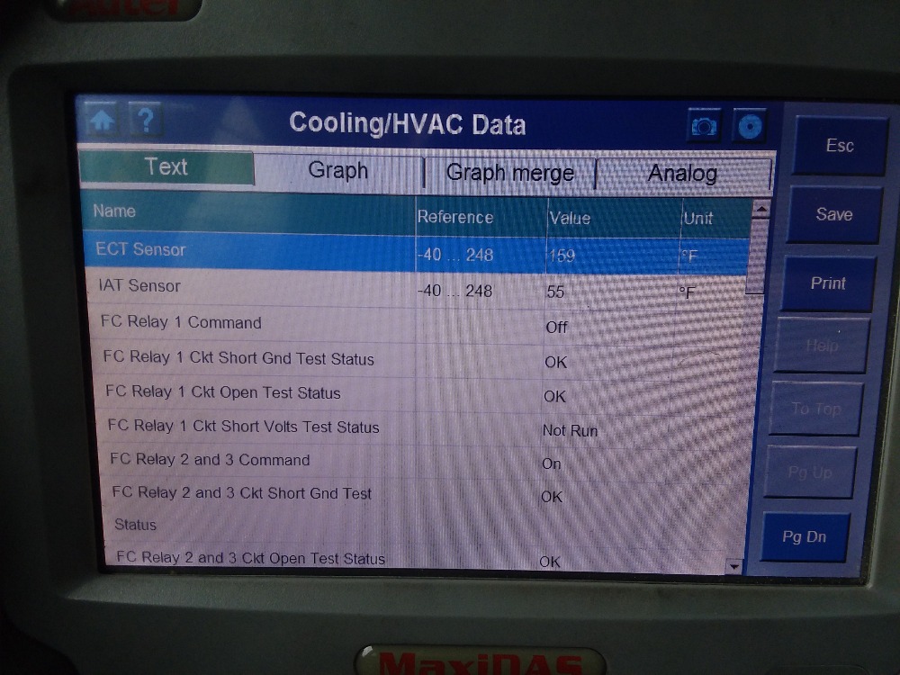

This is cooling/HVAC DATA
  • romeo.resendiz
  • romeo.resendiz's Avatar Topic Author
8 years 8 months ago #17761 by romeo.resendiz
Replied by romeo.resendiz on topic 2008 silverado cooling fans not working
I post a picture from data I got I like you to check it the weird thing is that the relay 2 and 3 command shows ON all the time of course the fans are off.
Not sure if that's something normal

8 years 8 months ago #17762 by juergen.scholl
Replied by juergen.scholl on topic 2008 silverado cooling fans not working
Your scan data shows the pcm commands the fans' highspeed on .This would be normal with a P0118, as a preventive step to avoid engine damage...
Do the fans come on during the condition your scan data is showing?
Your scan data does not show the ect, what is it reporting.
If the fans do not run in a situation your scan data describes : Check for proper relay function and wiring integrity from relay to fan...
If the P0118 is a hard code you have to attend this first!!

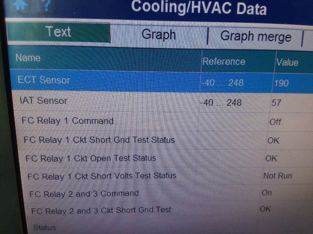

About the ECT readings it is the top one I know is hard to see it I will post a new picture.
And no the fans are not coming ON
At any time and the ground command from PCM is not there
8 years 8 months ago #17765 by romeo.resendiz
Cooling/HVAC data

8 years 8 months ago #17769 by juergen.scholl
The fact that the driver side hi speed fan does not come on when commanded to points to the relay that is called "fan contro relayl".This relay is pcm ground side controlled, together with the "cooling fan 1relay".
The cooling fan one relay controls the passenger side hi speed cooling fan, whichis working correctly as you state.
So probably the fan control relay does not switch properly between 87a and 87, youmight want to check this relay.
