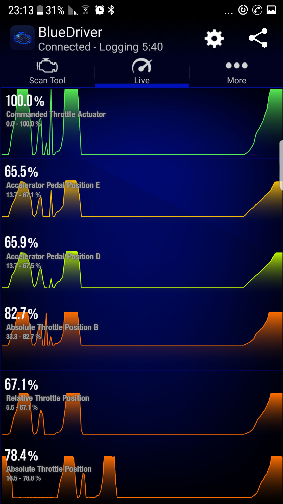

hi guys,
i have a very disturbing issue and i almost gave up on it. please bare with me as i will describe everything about the history of the car from the moment i bought it.
current status- i have absolutely no normal mechanic or car shops around me. i am not a mechanic, in fact up to 6 month ago i didn’t know how to change oil.
the car: subaru b9 tribeca 2007 100k base
symptoms: 1. serious hesitation when pressing the pedal from ideal
or during driving.
2 . 100% engine load on 2000 rpm with no power
i bought the car with cooling fan bypass, no thermostat ,blown head gasket, bad alternator and a/c system.
the symptoms of the hesitation was there as well.
i did :
head gasket
water pump
new radiator
new alternator
new a/c system
new fuel pump complete original subaru
cleaned the injectors
2 new a/f sensors
4 oil solenoid
cleaned camshaft and crankshaft sensors
new maf sensor
removed cat convertor form 2 sides
new pcv valve
all the parts are from subaru dealer in the state.
fuel pressure is 56psi ideal and at wot.
am using blue driver app for scanner and i have autel scanner .

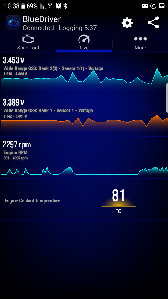

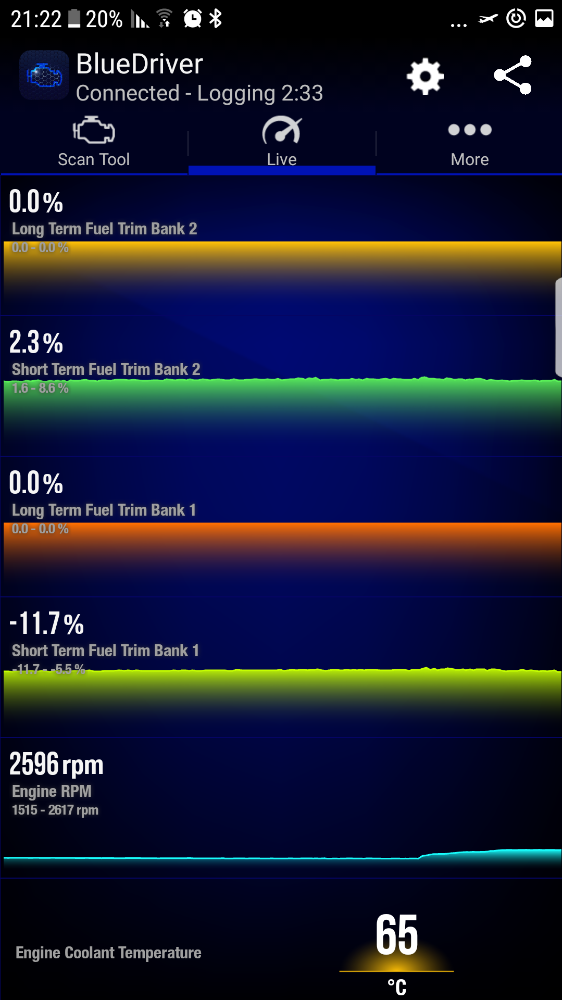

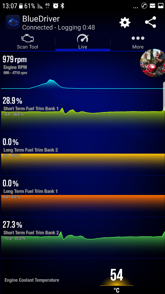

the problem is , the car runs very lean . on ideal there is no problem and after 2200 rpm when the gas is steady the car moves fine, but if i press the pedal its chocking and after 3 second its starting to get some power again.
also there wasn’t any reading on the long term fuel trim its always on 0%
short term on ideal are ok but when pressing the pedal can go up to 30% once from bank1 once from bank 2, so i know its not something like faulty injector because its affecting both sides.
i didn’t find any vacuum leak.
important: if i disconnect the maf sensor, the car will run normal.
important: the isn’t any dtc on. nothing
remember the bypass i told you? so i removed the bypass and now the fans are working as should , the car reach 95 c and the goes down ,not overheating.
but, i didn’t install the thermostat back, once its on, the car get overheat, i believe because its running lean.
at this point i don’t know what else to check , if you could ask me questions or direct me what to check, i will do so imidiatly and will update.

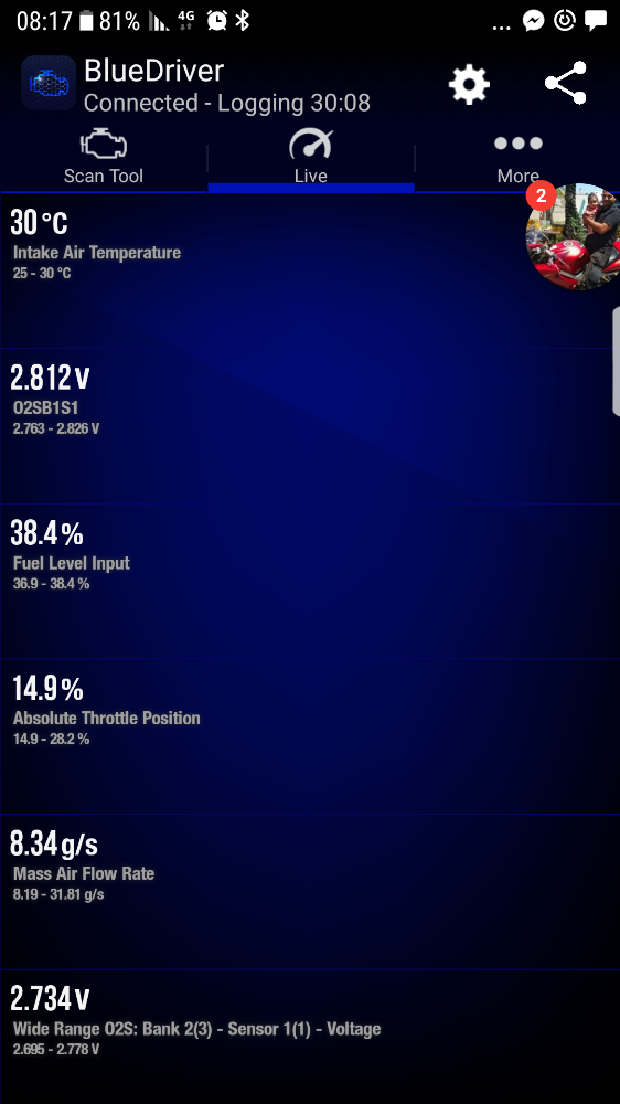

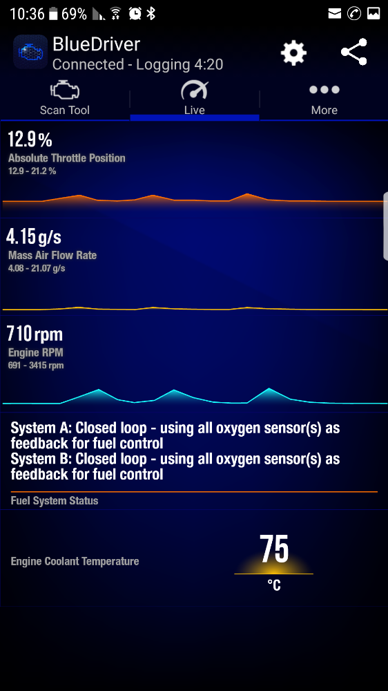

i am uploading some pictures taken from the scanner for you to see.
thank you in advance

You mentioned everything is fine at idle. Your third picture attachment shows your TFT at 28%to 29% for both banks at 979 rpm.
8 years 8 months ago #17821 by dkggpeters
Replied by dkggpeters on topic subaru tribeca very lean condition
If the car runs fine with the MAF disconnected I don't see how it could be the TPS. I would do more diagnosis on your MAF and its circuit.

about the short term, when i on the car, no touching on the gas pedal, ideal is good , short term both banks are between -3 to -8. the moment you hit the pedal, not even fully, it will jerk ,chock, hesitate and engine load will show 100% and the stft will be between 22 to 33 ,once on bank1 and once on bank2 never together. if you press the pedal slowly, rpm will rise slowly both smoothly .

here is a test i did yesterday engine off key on

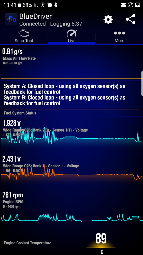

so i changed the tps, no fix.
removed the maf and its close loop.

Does your scanner read maf sensor flow rate ? If so give me warm engine idle numbers and a highest number on wide open throttle run in 1st or 2nd gear I prefer grams per second but I can convert if your scanner reads other increment
