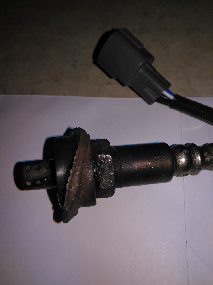

8 years 7 months ago #18981 by robert.lesaca
Hey Tyler, Andy...this is a followup on the Lexus PO430. After erasing the faultcode, I asked owner to drive the car around fo about a week and if the check engine light would come on again to drive it to my place. He called after about two weeks driving. I jacked up the vehicle and listened for some leak...I could barely hear any. At any rate, considering it had 192 + km and sensors never changed, I decided to remove the B2S2 and lo and behold, the whole sensor and where it was plugged in gave as I was trying use unplug it !!!
I am attaching a picture of the sensor and where it was plugged. Apparently Andys hunch of a leak was correct. Owner will have the entire catalytic system and B2S2 replaced. As soon I get the car back I will scope it and compare with the old waveform and inform you guys. In the meantime this is headed for a fix...
8 years 7 months ago #18982 by Tyler
I see what you mean! :blink: I'd say there was definitely some kind of leak there - enough of one to confuse the O2, anyway.
I bet you'll have a completed Cat monitor and good looking signals afterwards. B)

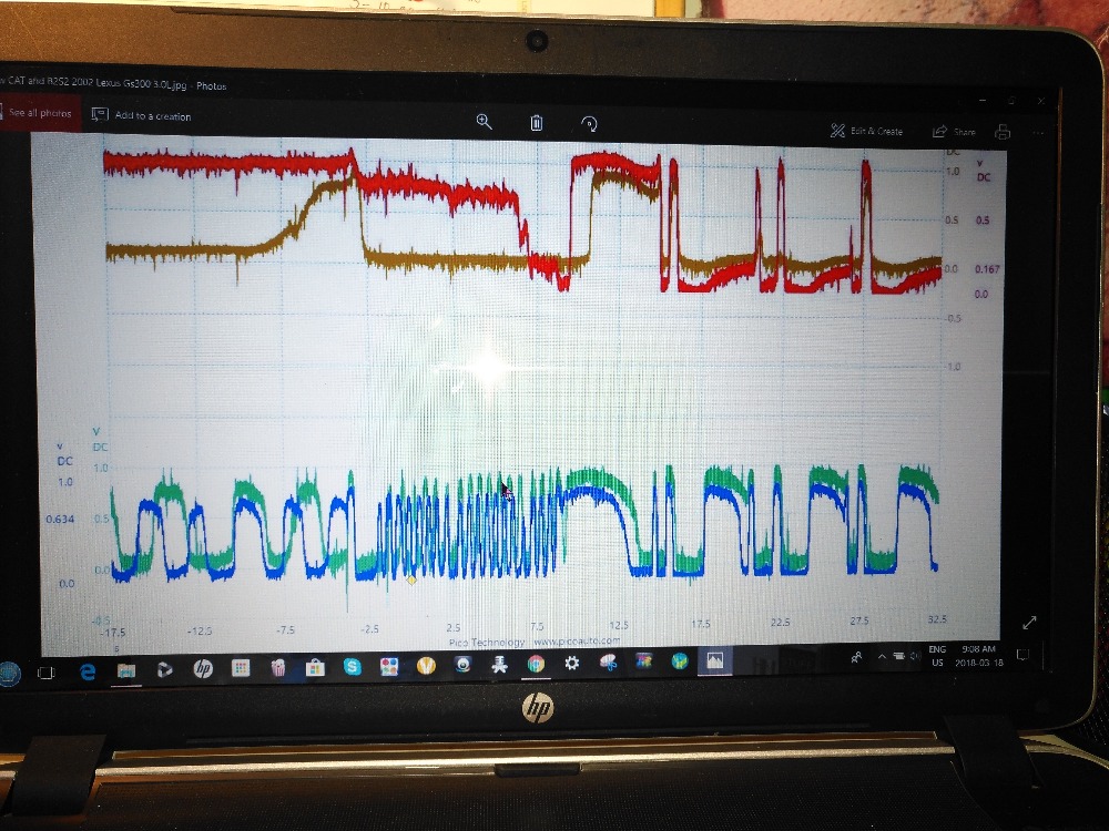

8 years 7 months ago #19043 by robert.lesaca
This is the new waveform after owner had the rear CAT and its corresponding B2S2 replaced and installed. It seems B2S2 (yellow trace) is now reacting accordingly indicating CAT threshold okay. I would appreciate your comments on this waveform...thanks
8 years 7 months ago #19050 by Tyler
So the red trace is upstream B2? And green/blue is B1? I'm sorry to say, but I'm still not sure the downstream is reacting well. :blink: Has it passed the Catalyst monitor? In the end, it doesn't really matter what I think, as long as the car is happy! :lol:
8 years 7 months ago - 8 years 7 months ago #19064 by Andy.MacFadyen
If the upstreams are car carbon copies of each other for each bank the down streams should be similar but even allowing for a bit of aging this isn't the case.

8 years 7 months ago #19091 by robert.lesaca
Honestly I dont know how to make of this waveform except that B2 (yellow trace) reacting better than before; when superimposed, both B2 sensore react almost identical on the snap segment (last portion of waveform) and almost opposite in the idle and 2500 RPM. Owner confirmed B2S2 is an after market NGK brand as well as an after market rear CAT. I guess as Tyler mentioned, as long as the engine is happy and no check engine recurring.
8 years 7 months ago #19108 by Tyler
I definitely see more of a reaction in the B2 downstream, but I'm still surprised at how much time it spends lean. :blink: Was this taken with the vehicle cold? Warmed up?
Pretty sure TID $01 is the catalyst monitor on this Lexus. If you get a chance, see if the Cat monitor has run/passed? And what TID $01 has to say.

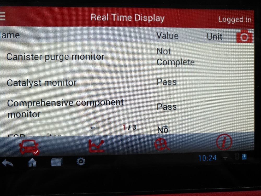

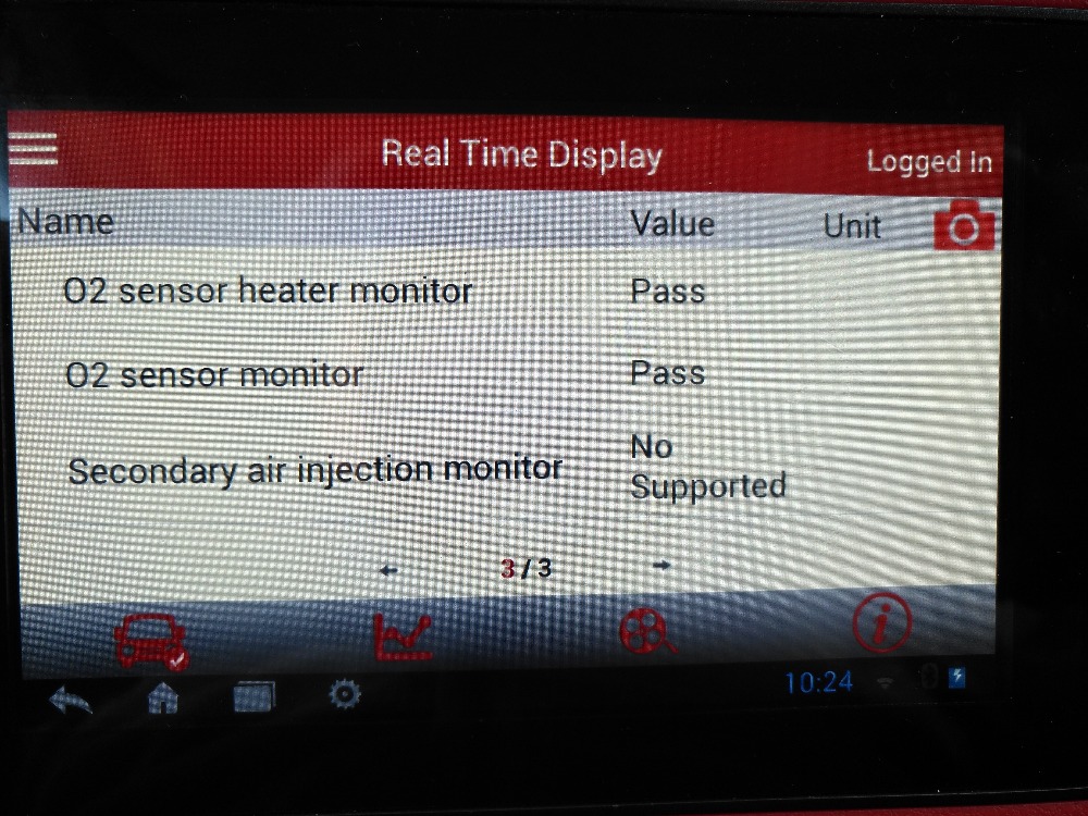

8 years 7 months ago #19133 by robert.lesaca
thank you Tyler for replyinh.
yes, all test are done with engine hot; it puzzles me why B2 would stay lean. scanned PIDs using EOBD and from $01, catalyst monitor showed pass as well as both O2 sensor monitor and O2 sensor heater monitor passed and no pending DTCs (attachment). I told owner to pick up the vehicle this morning and should anything come up to give me a call. in the meantime i would consider this a fix...
8 years 7 months ago #19156 by Tyler
Looks good to me. B) Well done on the fix, sir! I'm sure the owner will be happy to have it back with the CEL out.
