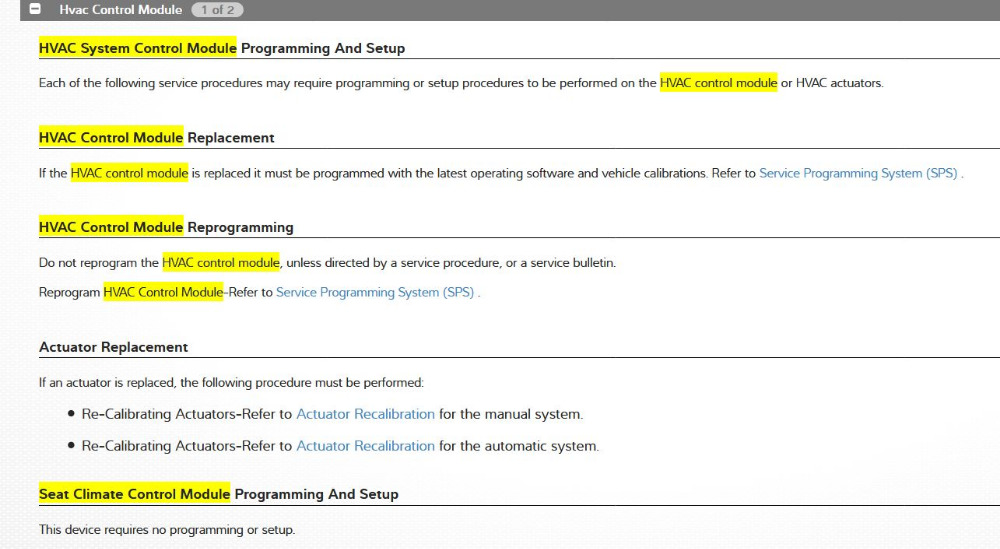

If the Body Control Module was replaced, It has to be programmed. The stealerships are not the only ones that can do it. However, most independent/non-dealership repair shops do not have the necessary hardware.
first flag was that they had to replace the body control module again because it had to be reset by dealer when it was installed
A BCM can be flashed, and re-flashed. Having to be "reset" does not require replacement, unless there is a fault/defect.

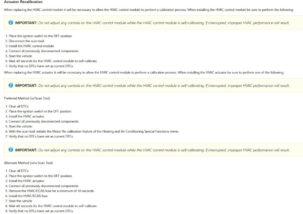

If the HVAC Control Module was replaced, it needs programed, too. The actuators can be recalibrated, without being "programmed".

8 years 6 months ago #20063 by Dave B56
Replied by Dave B56 on topic 2012 Chevy Silverado
Here's an update on this thread. This project was put on hold till recently anyway the blower motor and door actuators where replaced. The blower motor module did not need programmed or calibrated the actuators needed calibrated which I could do with my Solus Ultra.
This truck is fixed.
