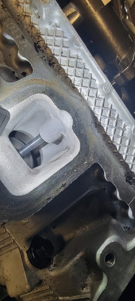

Well, fellows, it seems the plot thickens. I performed leak-down tests on two more cylinders. Same result, as in out of 90 lbs., I get 10 lbs. pressure on the other gauge. Air is coming out of the throttle body. No compression at all. I then looked at the valves using a borescope and saw that ALL the intake valves were open at the same time. Pretty unbelievable. Now I am thinking, did I install the long pushrods on the intake side?
I decided it was too much and we took the engine out again. Once the intake manifold/plenum was removed I confirmed that not only were all the valves open on bank one, but ALL also on bank two. Can't be possible, right? All at the same time? Also, a valve on each bank looked like it was open about 7/16 to 1/2"!!!
I thought that for sure, I had reversed the pushrod installation.I observed carefully, all valves went up and down as the engine was rotated. I breathed a momentary sigh of relief, thinking I had found the problem. But of course, I doubt that the pushrods could be installed in the wrong place. They were in the right place, short intake, long exhaust. Well then, maybe I was sent the wrong pushrods. I still had the ones I had removed and the length on both were the same between old and new. The pushrods were not bent, no deflection at all.
Well then maybe I got the wrong lifters. I compared them to the original and they were identical. That's where I stopped.
Now I am thinking, could it be the wrong cam? The valves? What the heck is going on here? Any ideas guys?

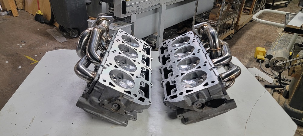

Well, Gents, back again. So, I removed the engine, took off the heads to get to the lifters to bleed them. I tried pushing on the lifters while still in the engine with a push rod to see how much "give" they had.    Some had about 1/4" or so and others had none. All of the lifters had oil, some more than others. I thought I had the issue solved. NOT.
I put the heads and rocker arms back on but the intake valves are all open still. One at least 1/2". The headers are mounted so I don't know about the exhaust valves but it seems that is a moot point, given the intake valves issue.

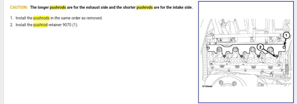

1 year 9 months ago #81818 by Tyler
I saw that you checked earlier, but are you certain you have the pushrods in the correct locations? I grabbed this from service info for your truck:

1 year 9 months ago #81836 by Mars928
Replied by Mars928 on topic Hemi 5.7 Just Rebuit engine, Crank no Start
Tyler, thanks for chiming in. That retainer sure would be sweet to have. I did manage to install and check that the pushrods were seated properly.
I have been mulling something else. Up to this point, I have not considered the valve height to be the problem, although that certainly could be. I had the heads done (seats replaced, new valves, guides, seals, springs, etc.) at a local shop with a very good reputation, so I trusted their expertise. At this point, I am having my doubts.  Just maybe.
 I have just now become aware that the difference in installed height between the early 5.7 and the later Eagle 5.7 is .20". I will check tomorrow what the height of the spring in the closed position is.  As far as I found out, the early engine's valve height should be 1.80 and the newer ones 2.0" high. It's possible that .20" difference (if it's there) could be the problem. I will check the manual for reference to be sure.
So, the hunt for a solution grinds on.
Mario
  • Mars928
  • Mars928's Avatar Topic Author
1 year 9 months ago #82123 by Mars928
Well guys I will be...
The height of the installed springs is 2". The specs call for a 1.81" height. I admit I should have checked that myself. Nevertheless, I got royally screwed by the machine shop. They have been in business 50 years, the ultimate pros. NOT! This is what I get for trusting the so-called pros.
I will see what they have to say.
Looking at the pictures of the intake valves I took with the rocker arms installed, the valves that should have been closed look like they were open about .20".
Seems to me the mystery has been solved. Now the grind to put it all back together properly.

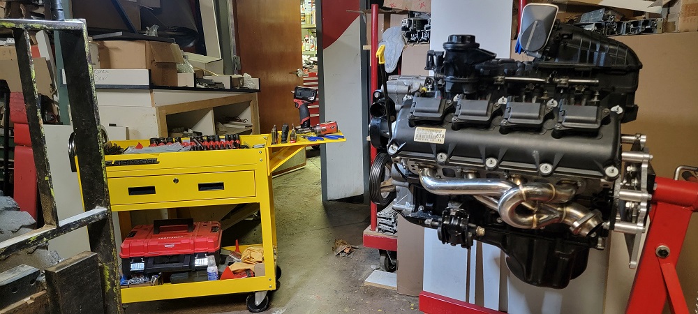

  Well guys, the machine shop changed the valves and assemblies to the correct ones. Put it all together this Saturday. I will shoehorn it in later this week.

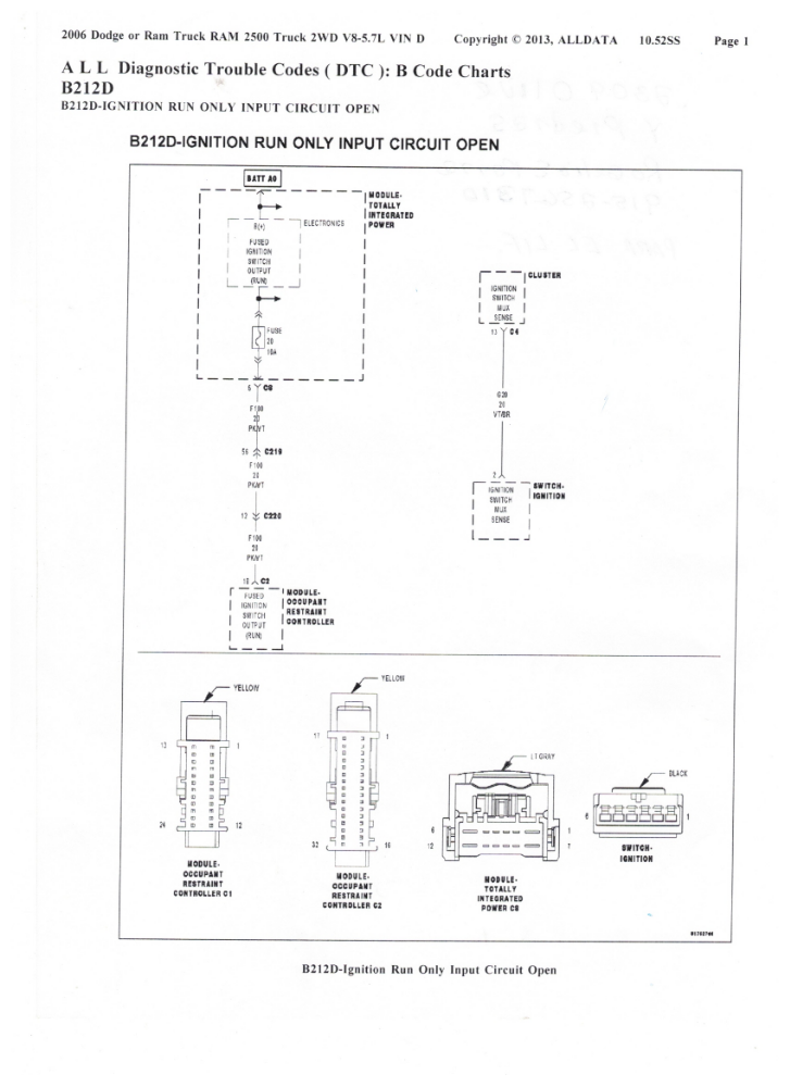

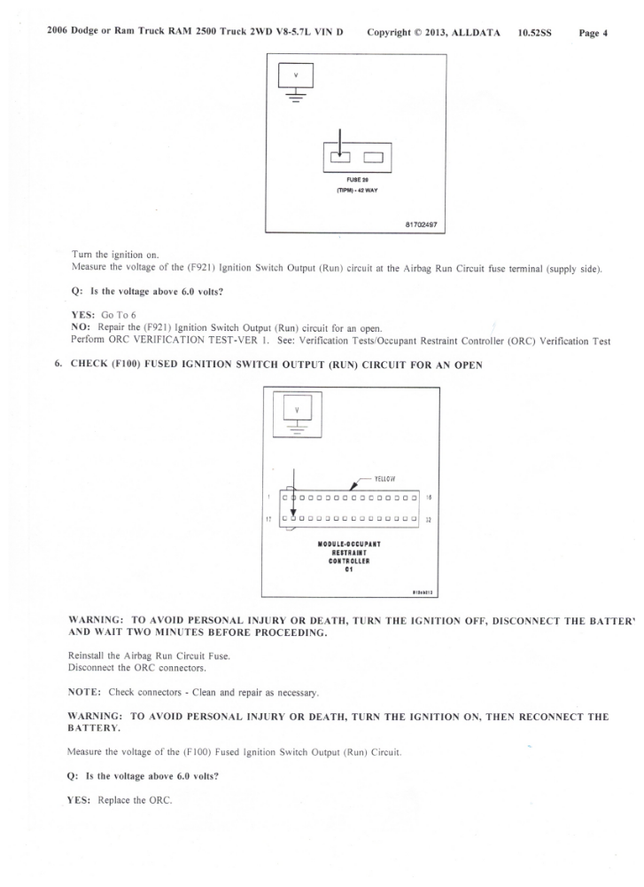

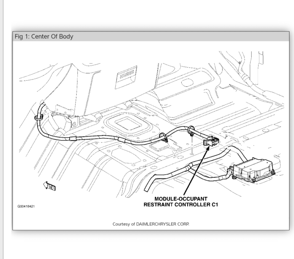

Hello all, back again. Now, it seems something went wrong with the security control module, if it even has one. Or a problem with the ORC (occupant restraint controller) The good news is, the engine did start for a couple seconds before dying. It only did it a couple times in many tries. It did sound good, for those few seconds.
I am getting code B212D, Ignition Run Only Input Circuit Open. I went through the repair procedure but I am stuck on step 6. It's asking to check (F100) output. I have not been able to locate the Module-ORC (please see the first diagram), to test.
Anyone have information on this?

1 year 8 months ago #84100 by Noah
While an ignition run voltage output missing could certainly cause an issue, this code seems to only effect the ORC module.
If you aren't getting a similar code in the engine control module, I don't think this is going to be the cause of the no start condition.
Back to basics: spark, fuel and compression.
