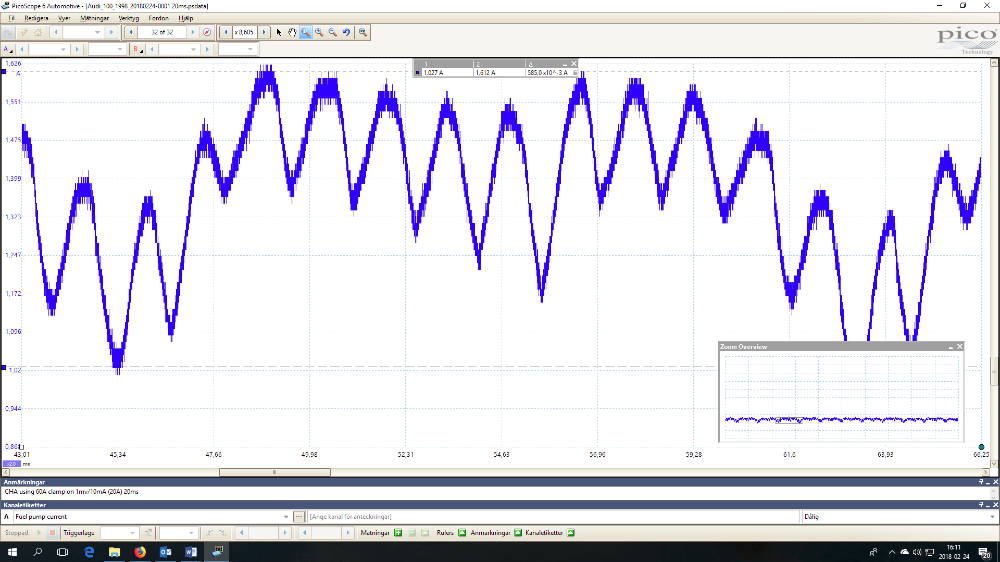

This waveform I guess is the fuel pump that is on its way to going bad, cars run great no problem just waveform analyze. It is a Mono jetronic system TBI. Max 1,6A Min 1,027A

I would have no problem with replacing that pump. It will have a dead-spot, soon.

Yes I will order one before I get stranded
