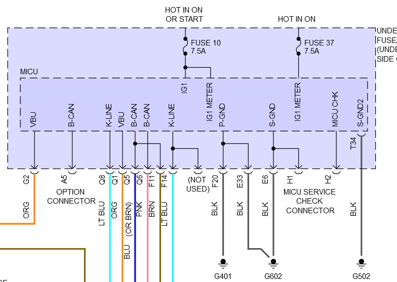

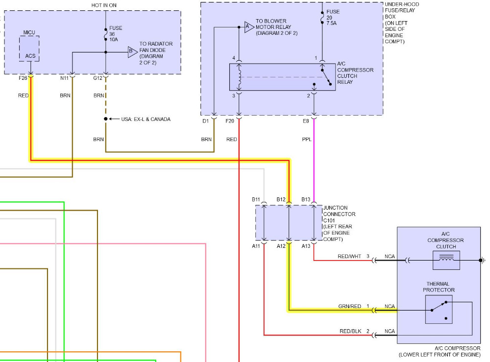

The car came in for a broken belt due to a faulty a/c compressor. Tech replaced the ac compressor, the car started but compressor was not engaging. I am not sure what the tech did but i saw him poke around with a power probe and now the car does not start.
Symtoms are
No start
No Spark
No Com
i do have a 5v ref.
I am probably going to be stuck figuring out what went wrong and could use any direction on how to tackle this,.

Best thing is to get the whole story.... try it.
Meanwhile check fuses, power and grounds to the pcm, then com lines, the usual stuff..
I take it the engine cranks.....do you have com with any module?

all fuses are good, MIL comes and stays on, 5v ref is present the car cranks. No coms with any modules what so ever. and he said all he did is try to engage the a/c clutch by putting 12 volts to it.

What is going on at the can bus, any voltage measurements done or scoped the bus?
And don't forget power and grounds...

Maybe he touched the wrong pin while he tryed to engage the compressor manually and grilled the ECU with this!
Try to disconnect the ECU and see if you have communication to the other Systems after?!
