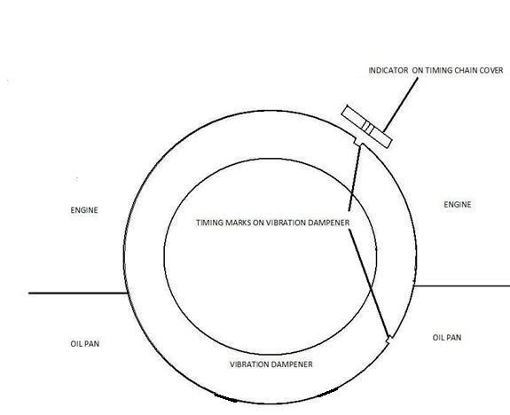

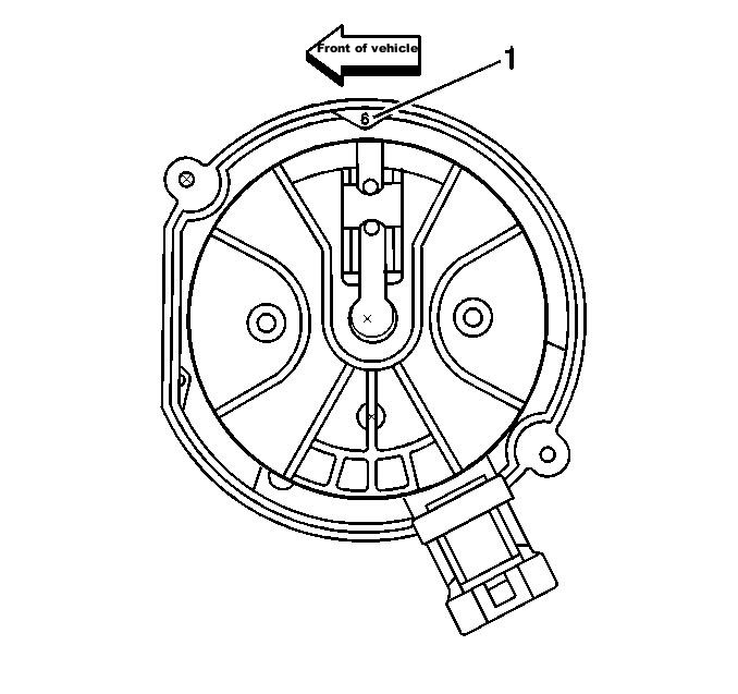

To further illustrate what I'm saying about the timing , or should better be put as distributor out of phase:
Line your timing marks up on the balancer
Remove the distributor cap, rotor should be pointing at the tiny "6" stamped into the passenger side of distributor (not the cap)...or pointing opposite of the "6" (crank turns twice for every rotation of rotor).
Option A: If the rotor is pointing at the "6", rotate the crank one full revolution until the timing marks are lined up again. Rotor will now be pointing opposite the "6". Remove the distributor (should be able to just lift it up) and turn the rotor until it points ALMOST to the "6". Reinstall the distributor and as it seats and the gears mesh you want the rotor pointing right at the "6".
Option B: If the rotor is already pointing opposite the "6", skip the turning the crank part and just remove the distributor and turn so it lands pointing directly at the "6".
Button everything up and try to start. It it starts, problem solved and the distributor was installed out of phase on the exhaust stroke. If it's no help, then you do want to insure that the crank is definitely on the compression stroke and rotor is pointing correctly before moving on to further troubleshooting.
