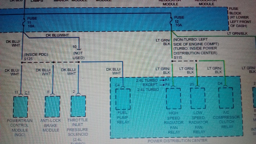

Hy.on à pt cruiser 2005 2.4 turbo,im getting p1604,ive check all Powers and grounds on m'y pcm but on connector c1 pin 12 key on engine off connector plug in,im getting less than 100 mv and connector unplugged im getting système voltage 12.5.now is this à shorted pcm input Power or is this à normal pcm pulling m'y voltage to ground
8 years 8 months ago #18498
Replied by Tyler on topic Pcm p1604
Diagram shot for anyone else:
I don't think that's normal at all, and I don't believe it's a shorted input. I believe you're witnessing a voltage drop across that circuit. It shows good voltage when unloaded, but can't handle a load when applied.
My next move would be to do the same check with a voltmeter at the instrument cluster itself. Monitor that same circuit with the PCM unplugged, and plugged in. If it stays at 12V either way, there's a voltage drop. If it still goes to zero, then there may be a fault in the instrument cluster.

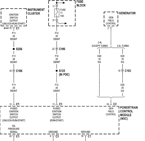

Gee Tyler i made à mistake,i wrote pin 12 c1 its pin 11 on c1 pcm connector i check m'y fuse 11 on lower left of dash ok,check Power to throtle Inlet pressure ok and abs module ok,im going nuts on this one

Diagram
8 years 8 months ago - 8 years 8 months ago #18563
:lol: No problem! That actually makes this a whole lot easier, IMO.
Were the checks done at the inlet solenoid and ABS module done with the circuit loaded? If so, then we know that S125 is OK. That only leaves the wire in between, which your readings indicate has excessive resistance.
Before you start digging into that, I'd suggest connecting a fused jumper wire to pin 11 at the PCM, and see if your code goes away. If it does, fantastic! Track the wiring problem, OR run a new wire. If your code persists, you still have another problem.
