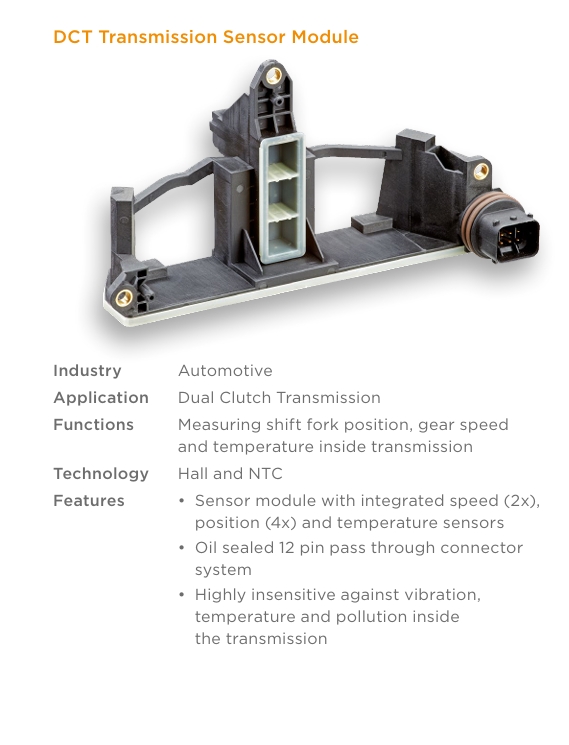

Hi! Reaching out to the community to see if anyone has any service info pertaining to the overhaul procedures for the valve body assembly on these transmissions?
I have found overhaul info on transmission assembly but nothing on valve body. I am looking for parts breakdown diagram, hydraulic circuit, disassembly and reassembly w/pics- illustrated diagrams, also torque specs for separator plate bolts. Purchased an overhaul kit by Precision International #KP31900H from Buffalo Engine Components but does not come with any instructions. Backstory of this is it threw a P1C99 code, "Gear shift position sensor 1 circuit. " This sensor module lives inside on backside of valve body. Sensor 1 was bad. Sensor 1 is part of an integrated sensor module that to my understanding has 7 sensors total. 4- gear shift actuator sensors, 2- speed sensors for both odd and even transmission shafts and 1- temp sensor. FYI Dodge to my knowledge does not sell just the sensor module they want you to purchase whole valve assembly with reservoir and pump $2500 +, I stumbled across  mlreng.com  they sell new and used sensors, only company I found that does. Any info would be appreciated. Thanks
