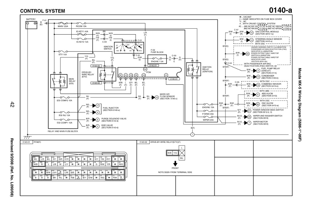

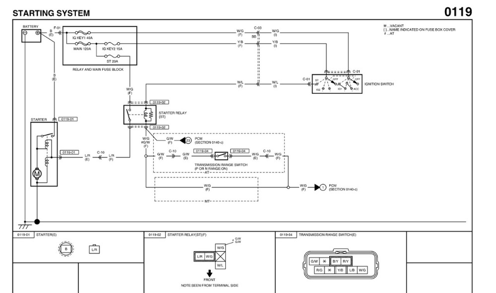

Hi all, I.m new to this forum and appreciate any help given.
I am UK based and have recently changed my NC Miata (MX5) engine. I have done this before - and last time went without a problem. This time was also smooth but when I connected it all up and turned the key to the first AUX postion it started cranking - without me turning the ket further. After about 4 seconds it cut off and it blew the number 19 15 Amp ENGINE fuse. And it does it every time. I have swapped over the relays. I don't think it is the starter - as it works - it's just getting its START command early on the key somehow. The ignition switch and wiring look okay - it's obviously getting a command from it - so I don't think it is that or the immobiliser - or key recognition. I have checked the 02 sensor wiring for chafing - incase it's grounding on the exhaust manifold.
It is really awkward to see the starter and the wiring around it - but I feel there must be a short somewhere around there. Perhaps part of the loom got pinched when I lowered the car onto the subframe. I can't say I remember anything out of the ordinary happening when the two were reunitied.
I therefore feel that the only way is to go through the hassle of lowering the engine again - that way I will be able to see the wiring around the starter.
Is that a premature thing to do? Any ideas about anything else I can try before that major surgery happens? I'm about to call a therapist.
Thanks for any help
Adam

Hi - thanks for getting back. It's a 2010 - so I guess an NC2 or Mk 3.5. Manual. I've attached a starter circuit diagram.

The car runs before the swap, we should put the ignition switch at the back of the list. The 15 A fuse along with the wiper and the power window fuses ties into the feed going into the ignition relay. Do you still have wiper and power windows operation when the fuse blows?

Hi - yes lights, wipers, horn, radio etc all work

I forgot to check ProDemand to see if I could get more info. I would know what the 15 A ECM fuse feeds. Maybe the 15A fuse that says Engine in the diagram that I refer to as the ECM fuse is not the ECM fuse. If you know what the ecm fuse feeds, you can ohm the side of the fuse that has zero volt( blown fuse) to ground and start disconnecting one after another until the meter reads a few ohms. With a short circuit, you will probably see less than 1 ohm.
