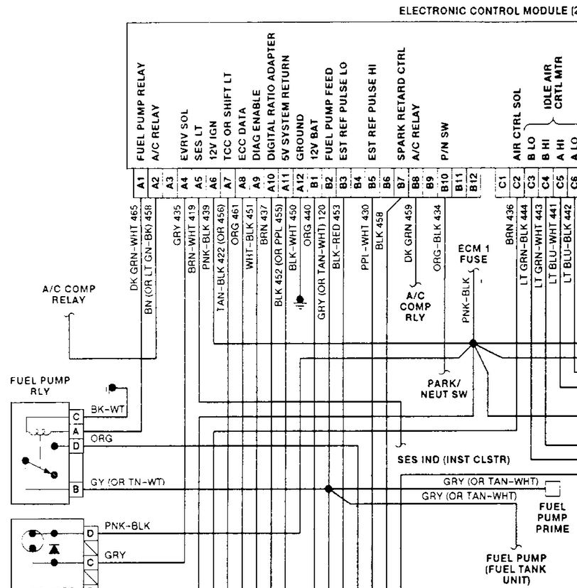

Hi with key on the ecm green white wire has 11.70 volts w/o relay. With relay same wire is only reading 0.07 volts. Black and white wire is good ground.fuel pump works when org and grey wire is jumped. Any ideas?

It sounds like you have a voltage drop on the DK GRN-WHT wire. With the relay removed, you have 11.7 volts on the DK GRN-WHT wire. Will it light an incandescent test light?

If you are showing a voltage drop at the ECM, then we need to check the power feeds INTO the ECM for a drop. Pins A6, B1, and C16.

pole71, I'm really not trying to be a jerk here. :blush: But, don't the GM fuel pump relay control circuits work this way by design? There's a bias voltage present on the dark green/white wire, as a circuit check on the control side of the relay.
This video is what I'm referring to:
Or, is this old news? 'Cause I'm sorry if it is! :silly:
Will the dark green/white wire light a test light during cranking? Or, during the key on fuel pump prime.

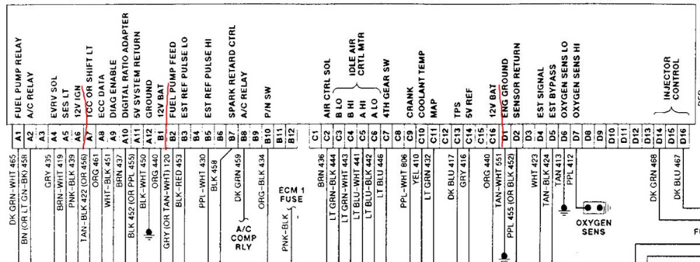

Ok there is no light at grn/wht wire when cranking. There is power at b1 a6 c16. Hopefully you get this old how other person is on my thread. Thanks Greg

When you first turn the key to the "On" position (without cranking), the ECM should power the g/w wire for 2 seconds, then turn off. Does it?

grn/wht wire doesn't light up at all when key is turned on.

Since you have power on A6, ,B1, and C16, but get no power on the A1(g/w wire) when the Key is first turned on, or while cranking, I believe this is pointing to a bad ECM.
As a final check, I would verify good grounds on A12 and D1.
