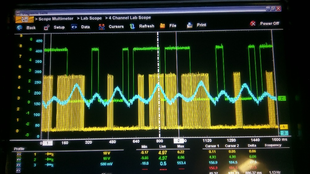

I hope you are referring to the gdi when you say it's easy to pull the plugs I'll do it tnite, does anyone have a Cam crank correlation waveform for 3.6L

I'll see if I can dig up a known good cam/crank. ;-) In the mean time, any codes? These are usually very good about setting correlation faults if the chains jump/stretch/fail. Likewise, if you had an actuator stuck, you'd get a code.

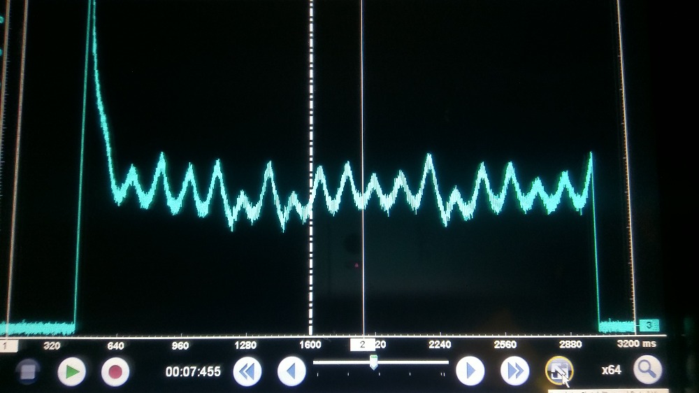

Totally agree. Even vehicles with stuck solenoids or actuators will still start and idle with a little throttle work. I'd be very interested to see the relative compression waveform, as it sound like one bank is completely dead. :ohmy:

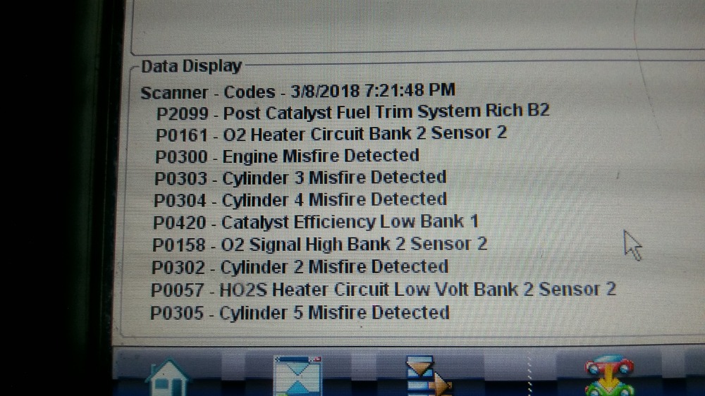

The only other codes were O2 heater codes and cat codes maybe I have plugged exhaust, I only ran basic test Tuesday and it's been to cold lately, I watched that video below but it isn't the gdi or it's just old as the crank is analog and this 2009 traverse is digital, ill get ya the answer, or more waveforms if I don't solve it Saturday.

Check out the post of codes and let me know how you would go about this does the O2 codes give you any direction in a start stall
8 years 7 months ago #18772 by Tyler
Replied by Tyler on topic VVT Start Stall?
Personally, I'd ignore the O2 and codes for now. I wouldn't be surprised if you found a bad sensor, or the wiring to it, but you can chase that later. The catalyst code might suggest a problem IF the catalyst has broken up or plugged.

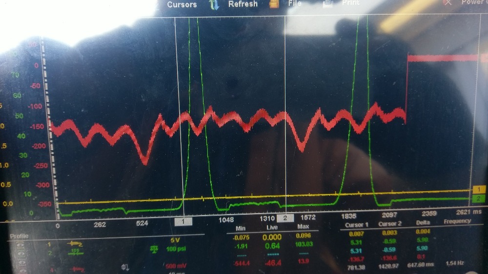

I'd suggest checking the history misfires next, in the Misfire data list. See which ones have high counts, and which ones are just getting incorrectly counted by the monitor. Knowing that might help you put together a better picture of the problem.
I'd also suggest revisiting the relative compression waveform. Disable the fuel so it doesn't attempt to start, otherwise you'll get wacky waveforms. I'm thinking you're gonna see three low cylinders. ;-)

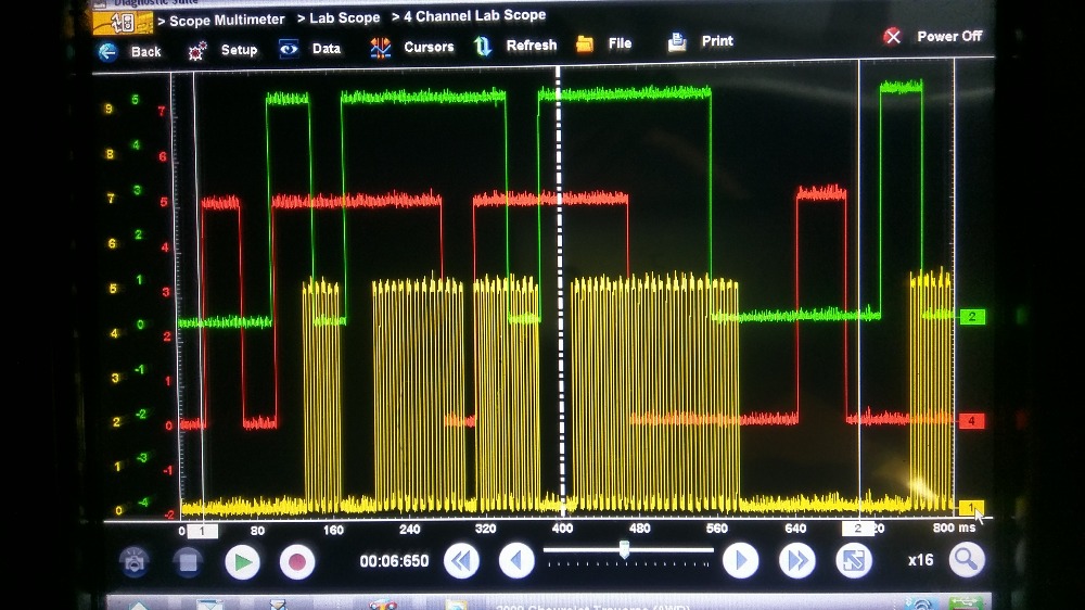

The red relative compression is inverted. All three of them look different, I wonder if the Cam actuator locking pin broke and it's flopping around.i really need some know good cam crank waveforms.

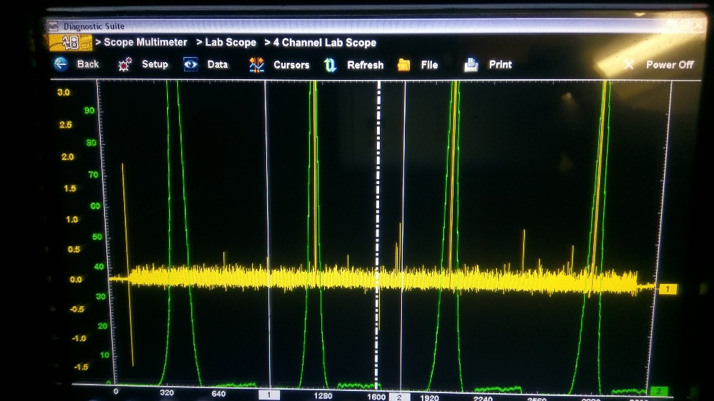

Also check how the timing changed from being slightly retarded to slightly advance on those 3 cylinder pressure waveforms that's a square wave so firing event
