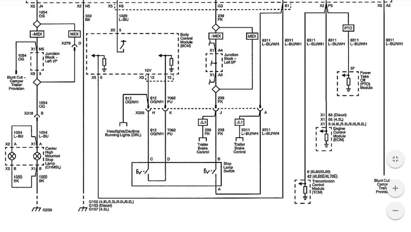

Hey chief! You didn't say exactly which Chevy truck you've got, but I figured it's a K2500 or the like. Here's the diagram with the brake switch:
File Attachment:
File Name: 6.6brakeswitch.pdf
File Size:82 KB
Based on your test at the light blue/white wire, we can say that half of the switch is operating correctly (at the time you tested it, anyway). This is your basic pull up switch input - the light blue/white won't have power on it until the switch is closed. The other half of the switch works the same way. With the switches closed, pin D purple and pin A light blue/white should show 12V or close to it.

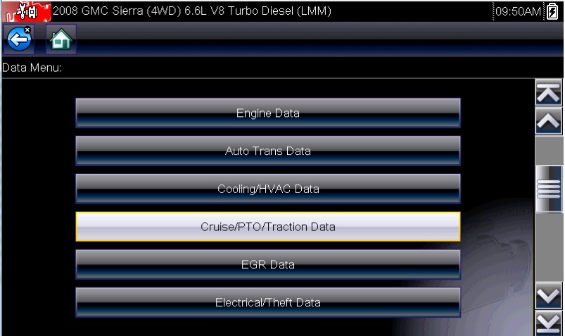

Before you go too far in your pinpoint testing, you might have a glance at scan data. Both of these switches have corresponding PIDs which may be beneficial. Here's a shot off a known good '08 GMC 3500 that uses the same switch:

You can totally go to the ECM and BCM if you want. :cheer: But, I'd honestly suggest keeping it simple and starting at the switch itself. Knowing circuit design, it'd be very easy to verify module and circuit integrity from the switch. If you end up finding a circuit issue, then you can totally dig whichever module out that you need at that point. Don't worry about the IGN 1 voltage for now.
For example, if you end up finding a failed brake switch, you can do bypass testing. Watch those two PIDs on the scanner, and short across pins C and D, or pins A and B. One PID or the other should change state as you apply the short, as this is exactly what the switch does.
Don't let the diagram make this look more complicated than it is. ;-) Observe the scan data and the switch behavior when the fault isn't there, so you know what to look for when the fault happens. I'd suggest leaving the Modis hooked up to the scan data, and watch the switch with a DMM.

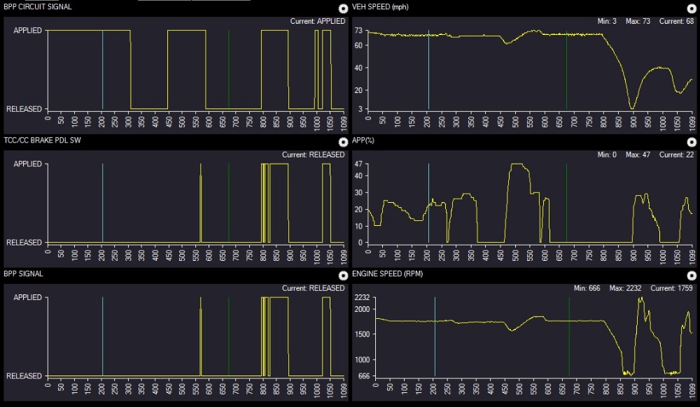

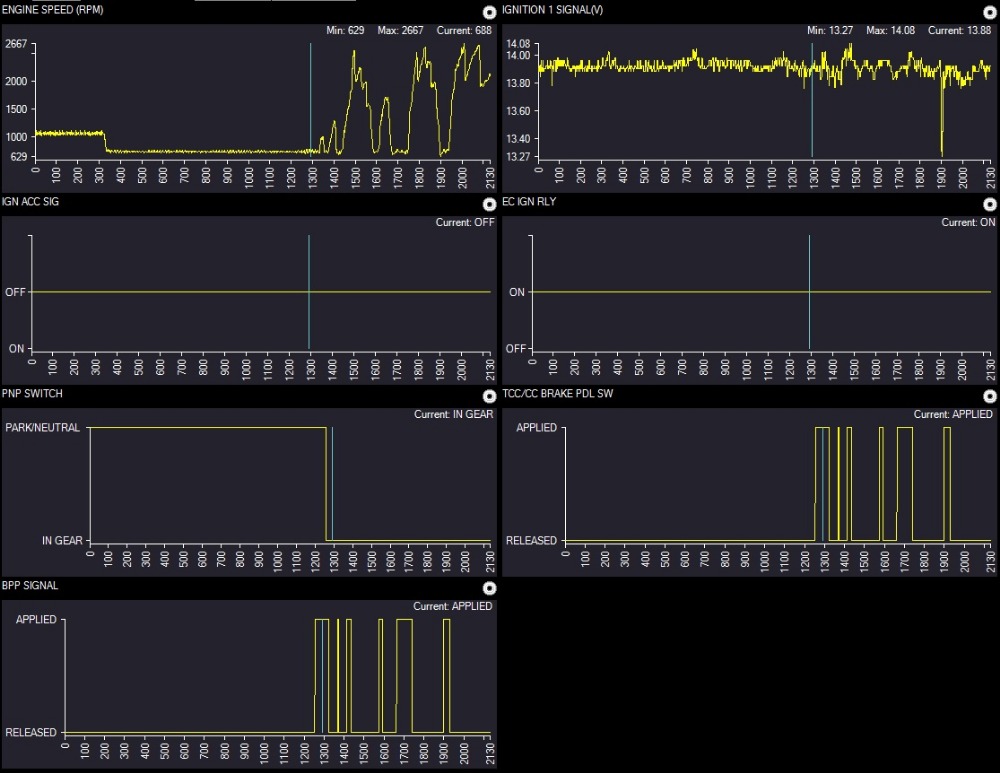

On the '08 2500 I saw last week, I found the right data list to watch:
I finally caught it acting up when I'd tap the brake pedal the right way. CC would kick off, wouldn't engage again, and the code would go to 'Current DTC'.
You can see the 'BPP CIRCUIT SIGNAL' shows applied up to frame 300, while the other brake pedal PIDs show released. :silly:
