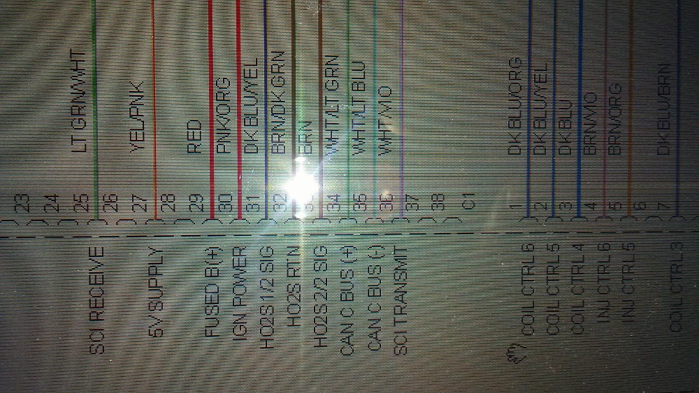

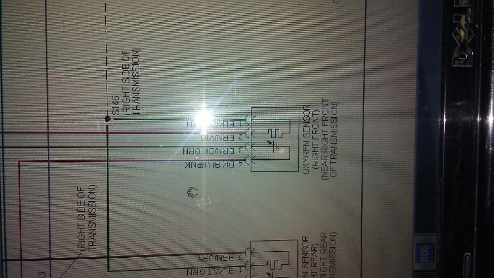

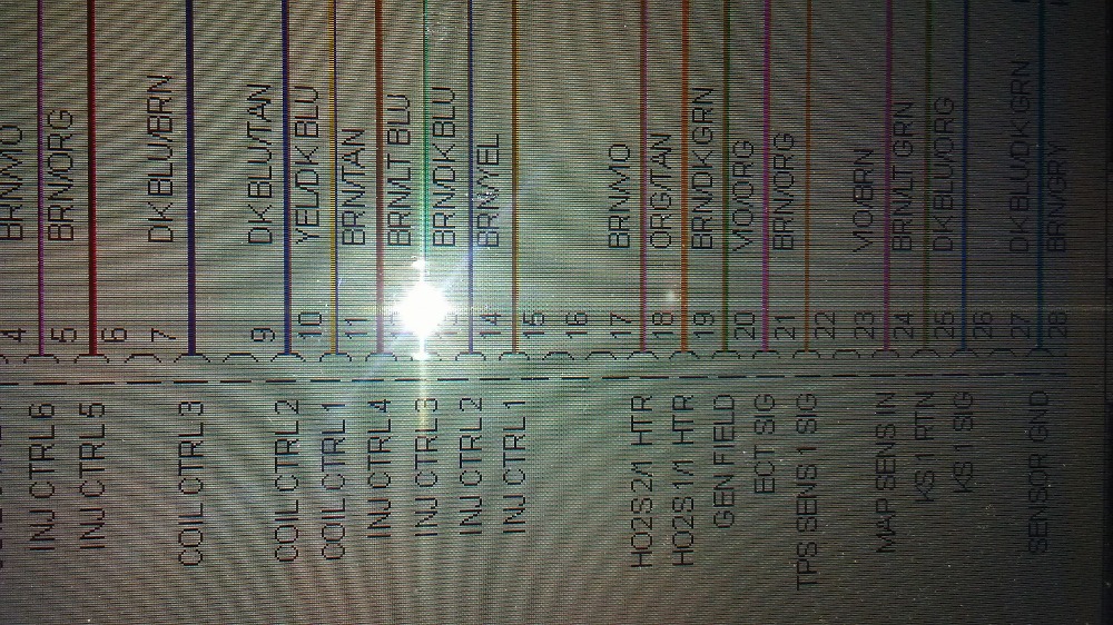

I got this jeep with o2 codes and not charging. After checking somethings I found that it did charge at times only at high idle so i figured the pcm was good. It turn ed out to be the alt. replaced it and it's charging as it should. Now getting to the 02 I check bias voltage just like brother danner did on one of his videos that was good. I check grounds and heater wires to the pcm and found no short to ground the only thing was that when the 02 is plugged in on the brn/vio i do get ground from block. Is this normal? is it being grounded through the sensor? I unplugged all sensors even thou they, on the wiring diagram don't cross. I put a new sensor and code comes back it is an after market 02 from A/Z I know that thees sensors don't take . How can i make sure I'm making the right call and have the customer bring me another sensor I have installed NGK sensors and they do work on Chrysler.

Dk/Blu and pink is the signal pin # 33 at PCM and at 02 sensor it's the bk wire. The brn/dk grn is the return the brn/vio heater power I think and last is blk/lt grn is ground .When I plug the 02 sensor I also get ground on the brn/vio is that normal?
The fuel trims are maxed out if I read them right. Thank you for your help.
