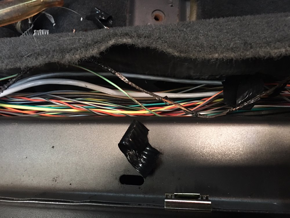

I got a strange on in today. I have a 2004 Ford Mustang with a 4.6L Mach 1. The complaint is when you turn the left blinker on, both rear lights blink as well as the parking lights, dome light, radio, odometer. When right blinker is turned on, it works correctly. Turn on the hazards, it goes crazy again. I've traced down most everything on the circuit, and everything is pointing to the Generic Electronic Module(GEM). My question is, does anyone know any inputs/outputs to be checked on the module or any test to confirm? Also does anyone know if this module is a module that has to be programmed when putting in a new one?

8 years 7 months ago #19103 by Dave101
Replied by Dave101 on topic Generic Electronic Module **FIXED***
I came in today to the shop with a clear head. First thing was to be positive the bulbs were correct. I then moved to the multifunction switch and was able to take that out of the equation. Bottom line is I went back to electrical troubleshooting and was able to find the wires shorted together (melted) in the harness on the drivers side. It was shorting the green/orange wire ( left turn signal) to the brown wire (park light). That was causing all the headache. Thanks everyone for the help with this!

8 years 7 months ago #19127 by Ben
Replied by Ben on topic Re:Generic Electronic Module
Good find
The following user(s) said Thank You: Dave101
8 years 7 months ago #19150 by Noah
Replied by Noah on topic Re:Generic Electronic Module
Seriously, nice catch.
What lead you to that location?
  • Dave101
  • Dave101's Avatar Topic Author
  • Show me what it's not!!
8 years 7 months ago #19157 by Dave101
Replied by Dave101 on topic Re:Generic Electronic Module
Noah wrote: Seriously, nice catch.
I started from the multifunction switch(making sure it was good) then I started isolating the lamps. I then isolated the front lamps from the rear lamps. Front lamps worked fine, everything worked correctly. Back lamps in, problem persisted. Then I just started following connectors, until I found it.
