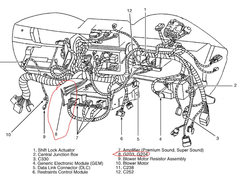

2000 ford mustang GT 4.6L so there are no trouble codes and the problem im having is the battery drains over night the battery is ok i tested it with a load tester so then i did a parasitic draw test and in the under hood fuse box i found that the I/P fuse is the one thats draining the battery so then i took the fuse out and did a voltage drop test it showed 0.00 but then i put a load on it with an incandescent test light then my dvom showed 12.33 and i took the test light away and it dropped to 0.90 volts and slowly kept dropping tell it hit 0 volts again and my question is is this a bad wire or is this a bad ground the test light does light but takes a second to light and is vary dim need help finding pcm location and ground 204 and 400 cant seem to find them

8 years 7 months ago - 8 years 7 months ago #19110
This is the back side of the dash.
All it says for G400 is "At Left Rear of Vehicle".
PCM "Behind right kick panel"
Replied by Chad on topic need wiring help
Derick wrote: need help finding pcm location and ground 204 and 400 cant seem to find them

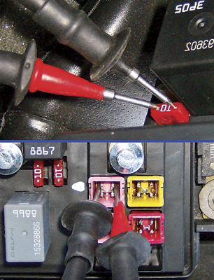

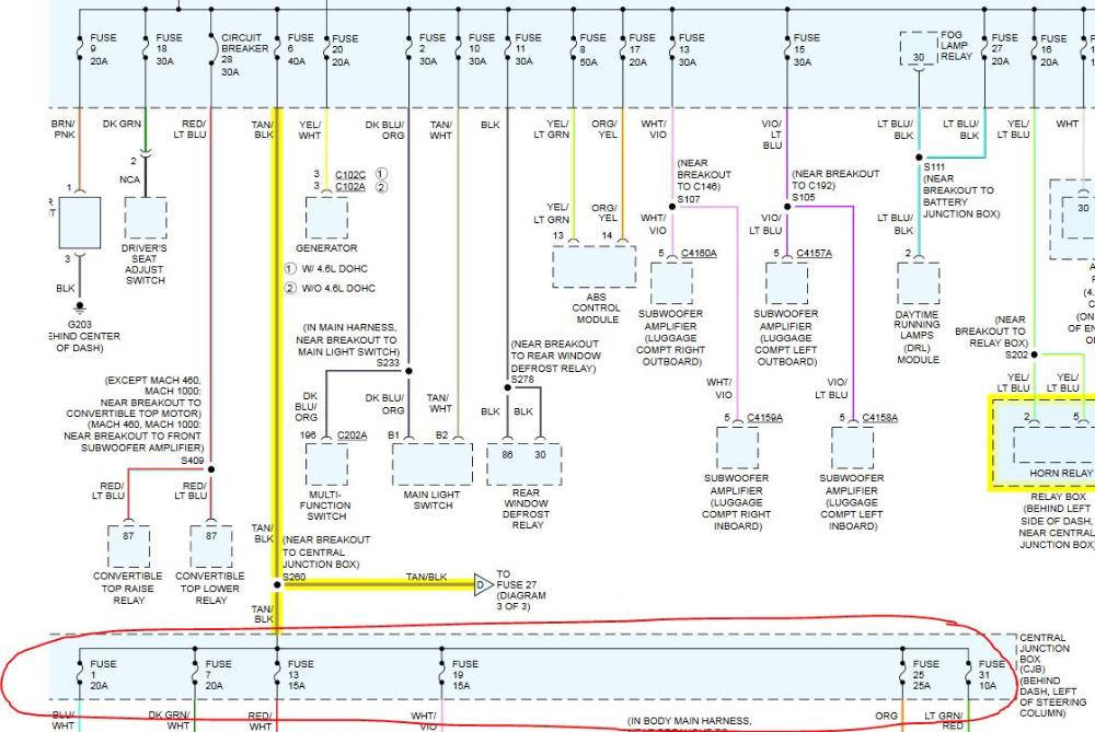

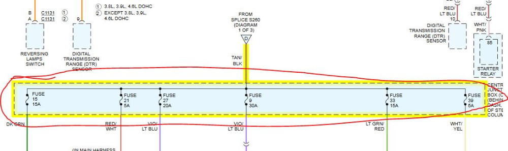

- Posts: 2222
8 years 7 months ago - 8 years 7 months ago #19217
That 40 amp fuse feeds many more, smaller fuses. Let's see if we can narrow it down a bit. If there is current flow through a fuse, there will be a voltage drop from one side of the fuse to the other. The drop is very small, but it will be there. Set a multi-meter to Milli-volts and, with one test lead, touch one of the test point of the fuse. With the other test lead, touch the other test point of the same fuse. You would expect to see 0.0 milli-volts and, if there is NO current flow, that is what you will see. BUT, if there is current flow (i.e. a parasitic draw) you will see a reading of something higher than zero. Maybe .10 mv. Maybe, 100 mv. The bigger the draw, the higher the voltage reading will be.
Here are the fuses that 40 amp fuse feeds.
