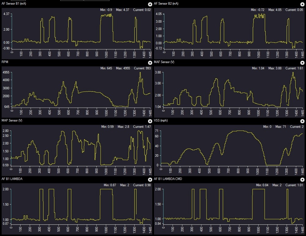

What scanner are you using? I ask because the upstream O2's on these engines are air/fuel ratio (wideband) sensors. They don't produce a voltage signal like conventional O2's do, but rather a current reading in mA. Global OBD data can sometimes make this confusing and unclear. :(
The upstream sensors will read 0 mA with a stoichiometric mixture. Rich will produce negative readings, lean will produce positive readings. Here's an example from ScanShare:
www.scanshare.io/share/SkAQl0NLiE6ixdCbU...,14,15,74,75,114,115
One very quick check that you can do is to compare the upstream air/fuel ratio sensor and the downstream O2 on the same bank. If the upstream sensor has negative (rich) readings, then the downstream better agree (over 800 mV).
As for the MAP sensor, there's a couple quick checks you can do there, too. At idle, fully warmed up with no electrical loads, the MAP should read less than 1.00V, usually closer to .9V. WOT will usually show 2.7 - 2.8V. You can also check rationality here by reading the MAP at KOEO. Again, should be around 2.8V.

If your scanner shows the mA PID for the upstream air/fuel ratio sensors, then you can probably get by with the scanner you have! I've got a thread going on this type of sensor, if you're looking for more info:
www.scannerdanner.com/forum/diagnostic-t...-testing-thread.html
Here's an example of the PIDs you're likely to see during a test drive. 'Lambda' in this case translates to 'Equivalence Ratio' in Global data.
www.scanshare.io/share/OrtyMv5LFkWuOWHfTccMZw

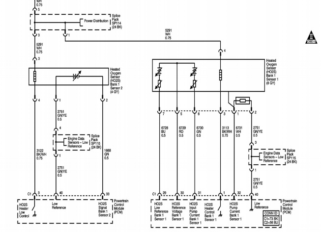

I am not primary tech on this vehicle but am providing support to friends who run junkyard body shop but I do have access to it I was also gonna ask if this engine does have af sensors the bbb diagram shows o2s upstream
Last edit: 8 years 7 months ago by chief eaglebear.

Which diagram did you find on BBB? This is the one I found for the 3.5L engine:
File Attachment:
File Name: vueaf.pdf
File Size:387 KB

OK I had a different diagram
