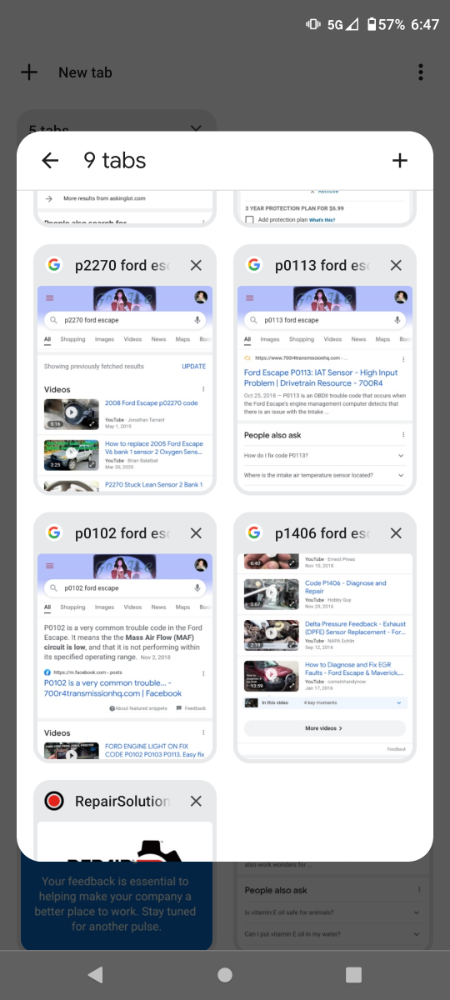

Hey I found this thread while researching a very similar problem with my 05' Ford escape 3.0l V6 Limited. I had basically the exact same issues as you're describing. Poor throttle response. No power. Rpms incapable of exceeding 3000. Feeling sluggish as if the throttle was not opening properly. I do not have the ability to hook a computer up to do diagnostics so I had to rely on a handheld scanner. Clearing codes and pulling them one by one in ACC setting and while idle and when revving. All to get a bunch of codes that had me running in circles chasing sensor codes. Only to test them and find everything is fine... I then stumbled on some research suggesting I may have a problem with my catalytic converter and found a YouTube video that described the exact same circumstances we seem to be experiencing. So i ended up climbing under my Escape and unbolted the catalytic converter from the flex pipe. And moved it aside, securing the muffler and catalytic converters to the subframe temporarily. I fired up the truck and it immediately sounded amazing!! Would no longer stall or struggle to reach 3000 rpm which was causing alot of problems for the transmission sensors to properly shift or shift harder than they should. The truck now hits the 4.2k rev limiter as it should!! I took it for a test drive and the difference is phenomenal!! So basically I've found the root cause of my issues and will be making repairs to the back half of my exhaust system. It cost me nothing to diagnose this problem and was very easy to do. Took me a couple car ramps and about 10 mins to get the catalytic removed.. I hope you can give this a try and find similar success and can stop chasing codes as well!!! Good luck!!!
www.google.com/search?q=2005+ford+escape...ome-mobile&ie=UTF-8#
Edit: here is a screenshot of the codes I was getting while testing with the handheld scanner...
