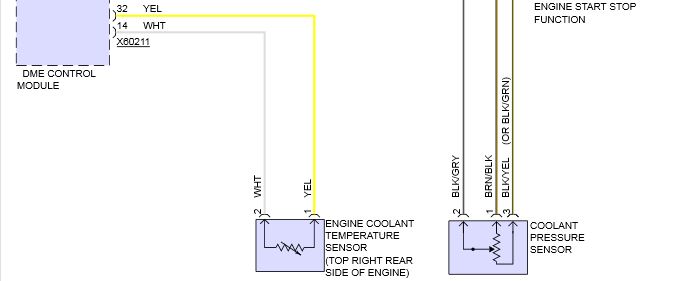

I am looking at wiring diagram for 2008 mini cooper 1.6L, the DME is grounding the fan relay even though engine cold and a/c off, there is 2 inputs for the DME unit one from coolant temp sensor and the other from coolant pressure sensor, any one familiar with Mini coopers chime in and tell me where to find it? I looked alldata, google...but couldn't locate it.

8 years 5 months ago #19317 by Chad
8 years 5 months ago #19319 by Tutti57
chief eaglebear wrote: What is the dme and what input is causing it to keep fan ground side switched
It's BMWs version of ECU, PCM, etc.

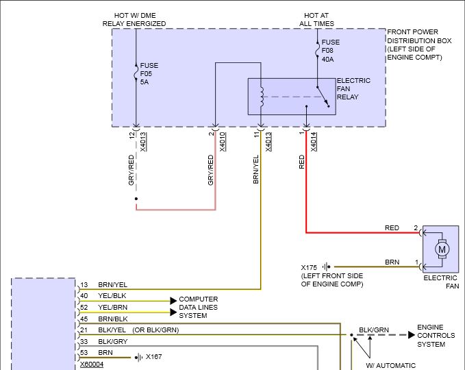

8 years 5 months ago - 8 years 5 months ago #19327 by Pinto
Thank you guys for your input.
Rockp2, I guess the Coolant pressure sensor is just the refrigerant pressure sensor then, I thought it has to do with anti-freeze.
I am still working on this and I will keep you guys updated:
P173b = CAN coolant temp sensor invalid.
P112b = Engine coolant temp low.
Fan works continuously with ignition On or engine running regardless of coolant temperature, fan turns off when removing fuse F05 (5 amp).

8 years 5 months ago #19341 by Ste
File Attachment:

8 years 5 months ago #19356 by Pinto
Ste, your wiring diagram confirms that Coolant pressure sensor is indeed the refrigerant pressure sensor ( B161 ).
