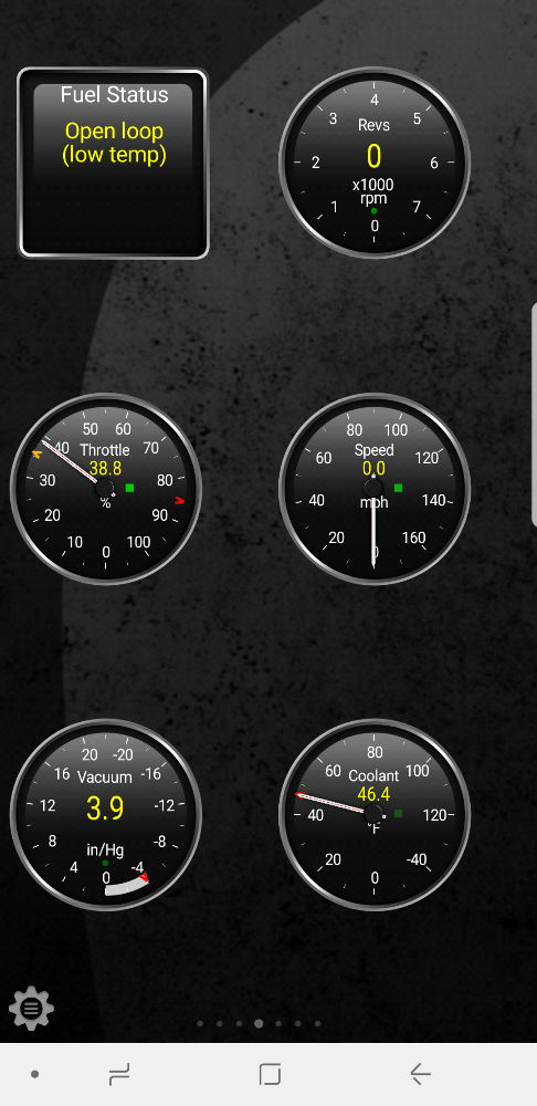

Alright, here is a picture of what my reader says with the ignition set to on.
For the throttle position, it has arrows for the min and max when I pressed the gas pedal. Is that a normal percentage for minimum? Meaning not touching the pedal.
Then the coolant is sitting at positive 46°F
Vacuum is at 3.9 in/Hg
8 years 5 months ago #19340 by Tutti57
Replied by Tutti57 on topic Re:Crank no start
I've seen that too with Saturn's but I think the Viu might have a Honda engine if I'm not mistaken?
You've already replaced a bunch of parts so let's check the basics here. Any codes? How is fuel pressure?

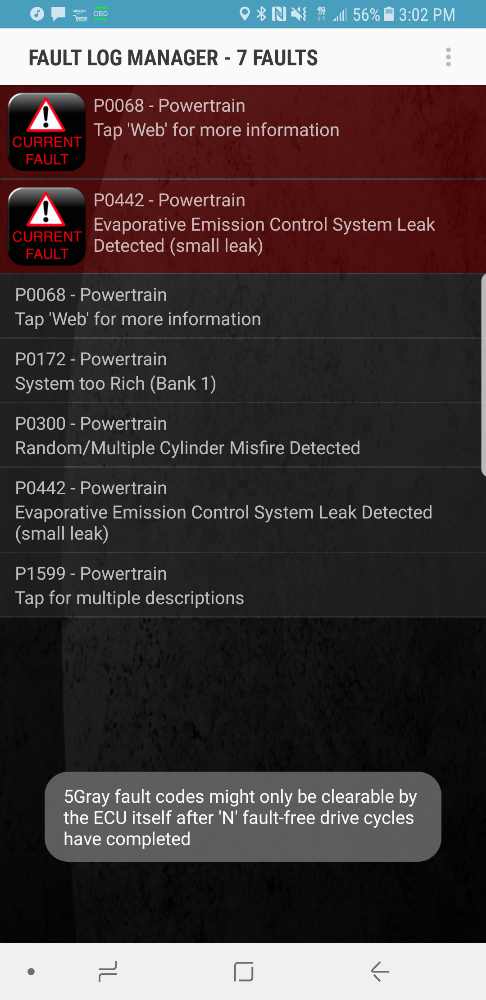

When I check for codes right now, nothing. But last time I checked, it showed these. I replaced the battery which may have deleted the codes.
P0068 powertrain
P0442 powertrain small evaporator leak
P0172 bank 1 system too rich
P0300 random misfire
P1599 powertrain
