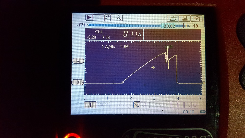

I have problems with the following weveform

I have problems with the following weveform was created by tatocabrera

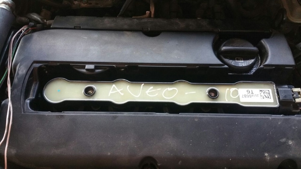

someone can explain to me the reasons why I lose my current limiting section
aveo ecotec 2009

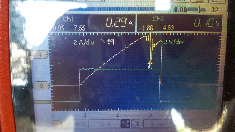

8 years 5 months ago #19414 by Tyler
Wow, I've never seen that before. :huh: Does the other coil do the same thing?
I'd say you're looking at a failed primary winding, but I'd be nice to have a primary voltage trace to go along with it.
The following user(s) said Thank You: tatocabrera

8 years 5 months ago #19422 by tatocabrera
Replied by tatocabrera on topic I have problems with the following weveform
no that is the only one is a coil pack
I changed the coils and for the time I solved the problem

8 years 5 months ago #19448 by chief eaglebear
Replied by chief eaglebear on topic I have problems with the following weveform
Yah I would say that's a messed up coil
