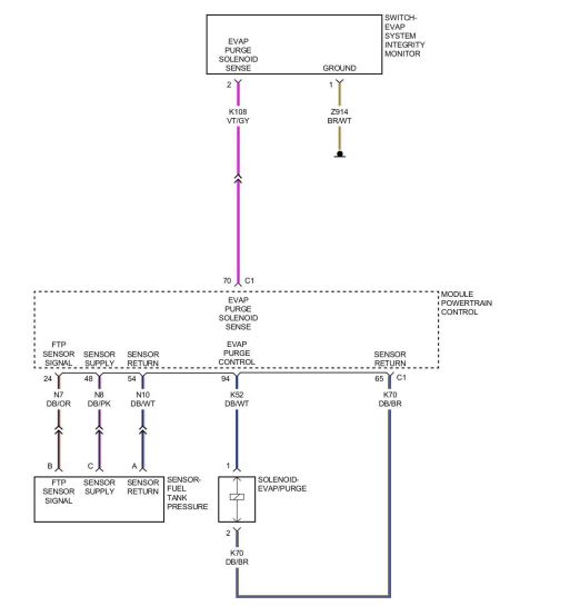

It had a p0440 and a p0441. General EVAP code, and Purge solenoid performance code. So first thing I did was, check the purge valve. So I cleared the codes, and went into a bi directional mode, and commanded the purge to start duty cycling. I did not audibly hear anything. That seemed like something that would cause a purge performance issue. So I chased it. I back probed the solenoid, and was only getting a few millivolts on both the wires. (I was verifying my BAT connections every step) At first I thought maybe the bi-directional control wasn't working. I unplugged it, and found my answer. I had 6-7 volts on one wire, and 0 on the other. Ok so we have a power side switched solenoid. I did verify this on a wiring diagram. The power is being duty cycled, and 6-7 volts was within MFG spec. Ok great. Plug it in, and poof, switched power goes to 10mV. So I unplug it, 7 volts again. Put a grounded test light up to it, and poof, 10 mV. Is it bias voltage? I command it off while unplugged, it goes from 7 to 0. Turn it on, it goes back to 7. Ok, so at this point, I am not throwing a solenoid in it. So I bypass test the solenoid, and it works. With the motor running, I can feel vacuum and a full seal, when I go on and off. Perfect. I know that this is not a bad solenoid. To the PCM. 7 volts @ the PCM. Plug it in, or connect test light, it drops it to 10mV. I unplug the connector, and send power from the PCM back probe, and power the solenoid. It works. I drag tested with a .5mm probe. Drag tested fine. I even bypass tested the solenoid, front probed at the PCM. This PCM driver will not support any current flow. I called a bad PCM.

The P0440,41, are monitor tests the PCM performs using the Purge Solenoid. The code gets set from ESIM (Evaporative System Integrity Monitor) See attached Diagram.
P0443 is a hard fault for the operation of the purge solenoid. You don't see this code more than likely because the PCM believes it to be operational.
Here is a diagram and some INfo
Might be worth to check before condemning the PCM
