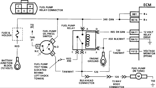

Hey sir! Last question first: The oil pressure switch myth comes from a misunderstanding of the circuit design on these older GM models. Here's an example I found from a '90 Corsica:
The oil pressure switch is wired in parallel to the fuel pump relay, which means that it acts as a backup power source for the pump in case the relay fails. Contrary to the myth, this fuel pump will absolutely still get power from the relay with zero engine oil pressure.
