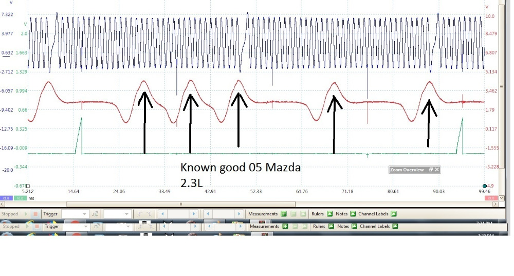

- BseriesBro
- Posts: 2
1 year 9 months ago #80119
by BseriesBro
Replied by BseriesBro on topic Engine swap - crank but no start/no spark
Yes they do. See attached Pic. Even though the check Engine light stays on after cranking it has no dtc's except for the before mentioned u-codes

- ferris48
- Posts: 129
- Thank you received: 47
1 year 9 months ago #80302
by ferris48
Replied by ferris48 on topic Engine swap - crank but no start/no spark
I don't see a pictureYes they do. See attached Pic. Even though the check Engine light stays on after cranking it has no dtc's except for the before mentioned u-codes

1 year 9 months ago - 1 year 9 months ago #80303
by ferris48
Have you seen this:
diag.net/msg/m438upc23y4c4kotyhpzv0upne
cmp rides on 1.5v
ckp rides on 2.5v
Cam and crank signals are biased at around 2.5v
Unplug sensor KOEO, do you have these voltages? it's a quick test to check wiring integrity back to the computer.
ckp rides on 2.5v
