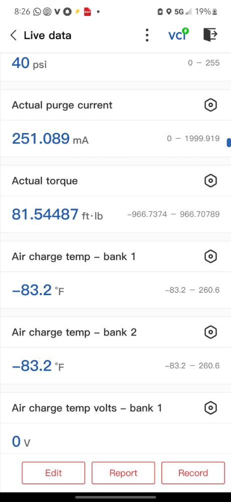

I have a 2015 Chrysler Town and Country. I keep getting p0172 po175 codes. I have changed the O2 sensors, installed new OEM fuel injectors, both camshaft sensors and a crankshaft sensor, a PCV valve, new map sensor and IAT. I recently bought a scanner to see if I could figure out what the issue was. But I'm not sure what I'm looking at with the data I feel like the map sensor and the IAT are not working correctly although I do have voltage at each. I'm going to attach my latest live data report and maybe someone can tell me what on there is wrong. Thanks in advance.
1 year 9 months ago #80554 by Tyler
Replied by Tyler on topic 2015 chrysler T&C po175 po172
Thanks for adding the scan data report.
First, the total trims on both banks in this capture aren't negative enough to set fault codes. That means your lean condition is intermittent and not happening during this capture.
Second, I have a concern with the EVAP purge valve. From your report:
Actual purge current - 0mA
Fuel tank pressure - -.1 PSI
ESIM switch - Closed
The actual purge current indicates that the PCM is not energizing the purge valve. But the fuel tank pressure and the ESIM switch both indicate vacuum in the tank.   The PCM could be doing an intrusive EVAP system test. Or, the purge valve could be stuck open and leaking.
A leaking purge could cause intermittent rich fuel trims, especially right after refueling. Are the P0172/P0175 still present? If so, pull the Freeze Frame data and see what the fuel tank level was when the fault codes set.

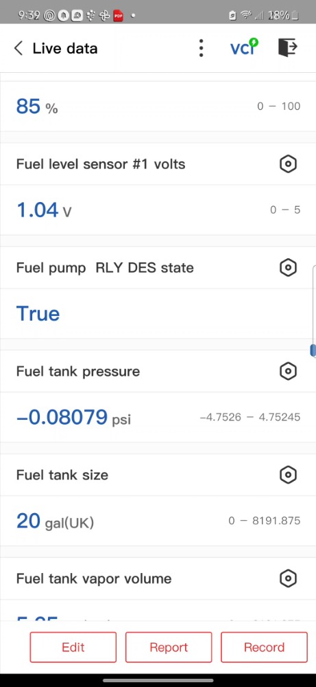

So my current scanner will not read a freeze frame. But I have a new one on the way. But while viewing the live data while driving today under the fuel tank pressure it was constantly like negative.08.07 around there. The parameters on my scanner say negative 4.2 I guess to positive 4.2 I'm not real sure. Is this an indication of something that the purge valve is stuck open and is there another way for me to test that theory. I really appreciate the help. Thanks

No matter what it always shows a negative amount. What does that mean bad purge valve and is that the whole purge canister.
Never mind it will not post the video it's too large. But basically the value never gets above -.08209. As I drove it around and watched it it never got above the negative value.
That may be another indicator of a failed purge valve? It's tough to say without knowing what the commanded purge current was at the time.

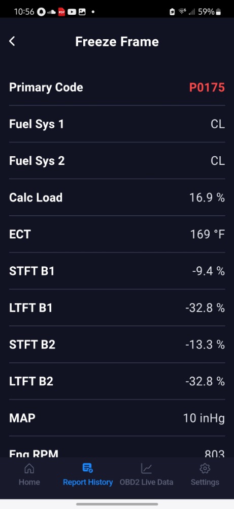

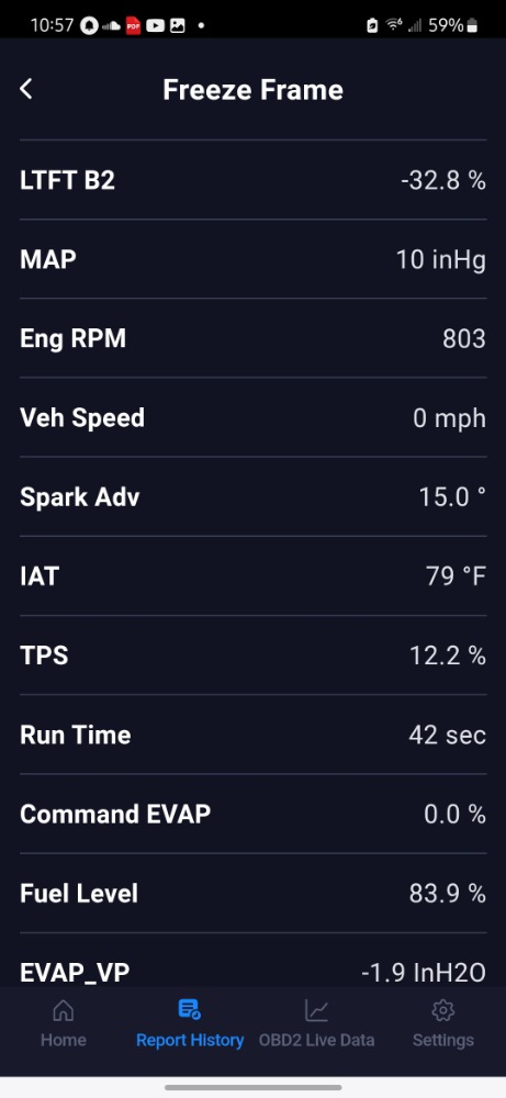

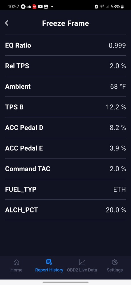

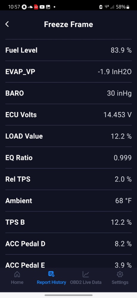

I was able to grab some pictures of the freeze frame from a different OBD2
Awesome, thank you! The fuel level is high but not exactly a full tank. Which scan tool did you use to retrieve this Freeze Frame?

Sorry I didn't see that ,I got the freeze frame with my Bluetooth zulrich

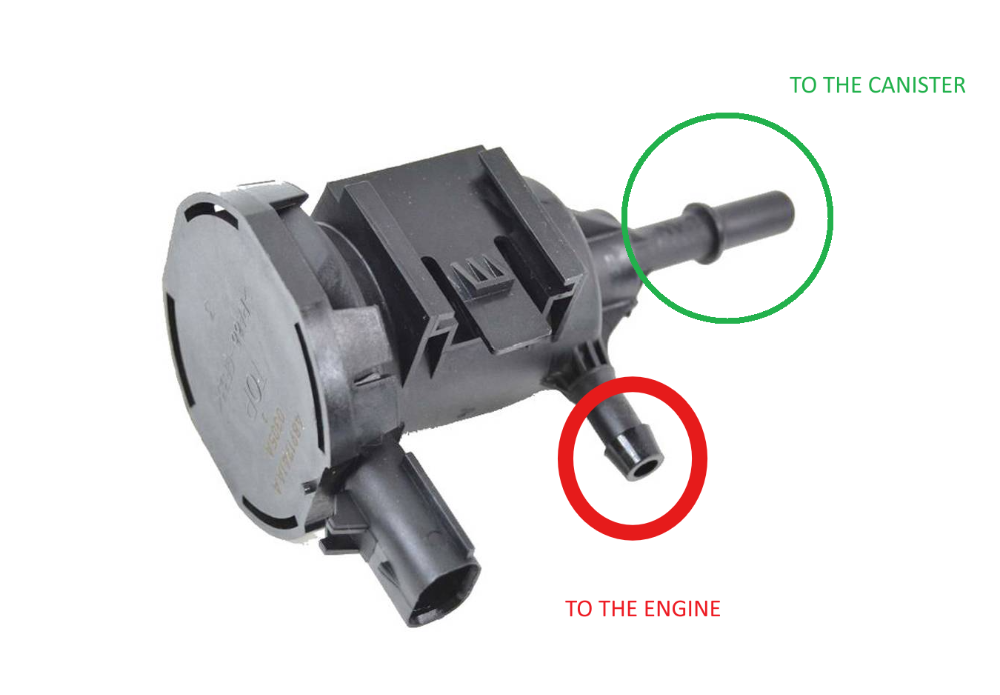

1 year 9 months ago - 1 year 9 months ago #80609 by Tyler
Sorry I wanted to be clear.
No worries! I genuinely appreciate it.
I grabbed a picture of the valve for reference:
The one going to the canister is the one with the quick connect fitting. The one that's a pain to get off.  The one to the engine is the normal rubber hose.
Unfortunately, testing at the rubber hose won't tell you if the purge valve is leaking. You'll need to get the quick connect end disconnected. Sliding the valve off the bracket might help. Leave the rubber hose connected to the valve and start the engine. Check for vacuum at the canister port.
