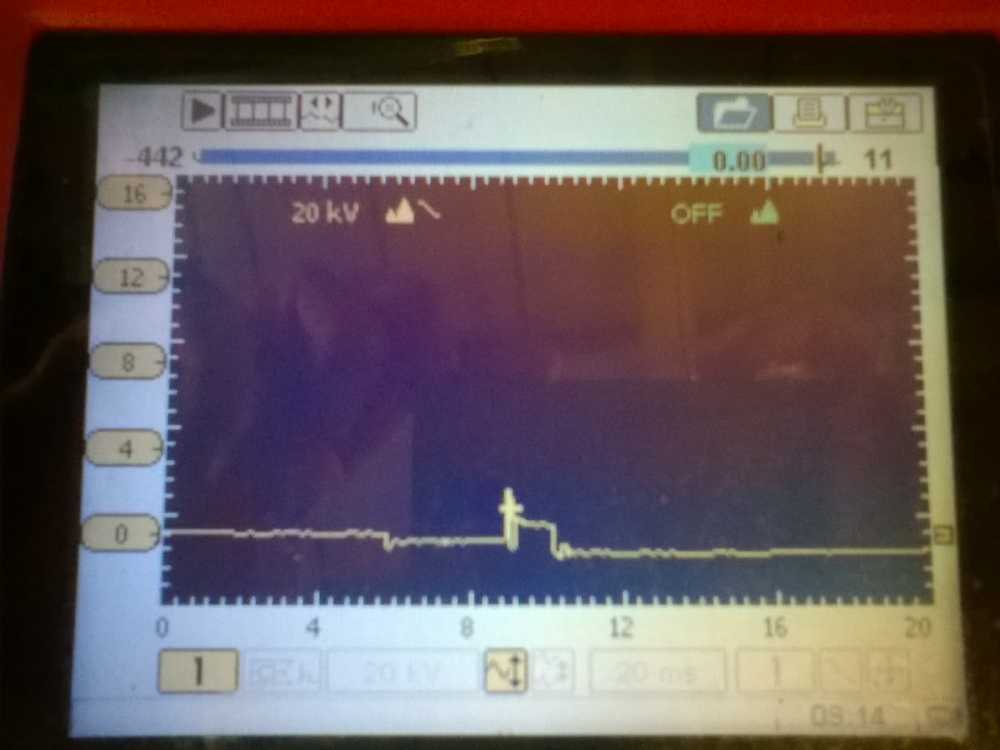

Looking for an occasional misfire on a ford focus at idle and higher rpm. This picture is from cylinder 4, the Kv barely goes over 1k volts but it still looks like a spark is being produced? This is with the engine rpm held at 2500. All the other cylinders have a Kv of around 5k at this speed. I am new to secondary ignition wave forms and this one sticks out to me as the voltage seems low.

Andy.MacFadyen wrote: I am really thinking low compresion due to a leaking exhaust valve on on this one because of the low KV but with a near horizontal spark line
I was thinking if it was low compression I would have a dead miss here but its more a frequent misfire, sometimes it wont do it for 20-30 seconds. I have not checked if the Kv rises on the snap but I will check this out, looking at it tomorrow evening. Nothing has been removed so not checked spark gap. I am thinking a weak coil, I could try stress the coil and remove the lead and see how far a gap it jumps. Sometimes that line was only around 800 volts.

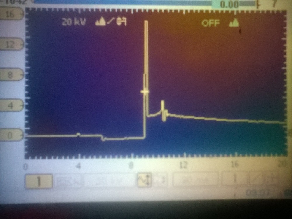

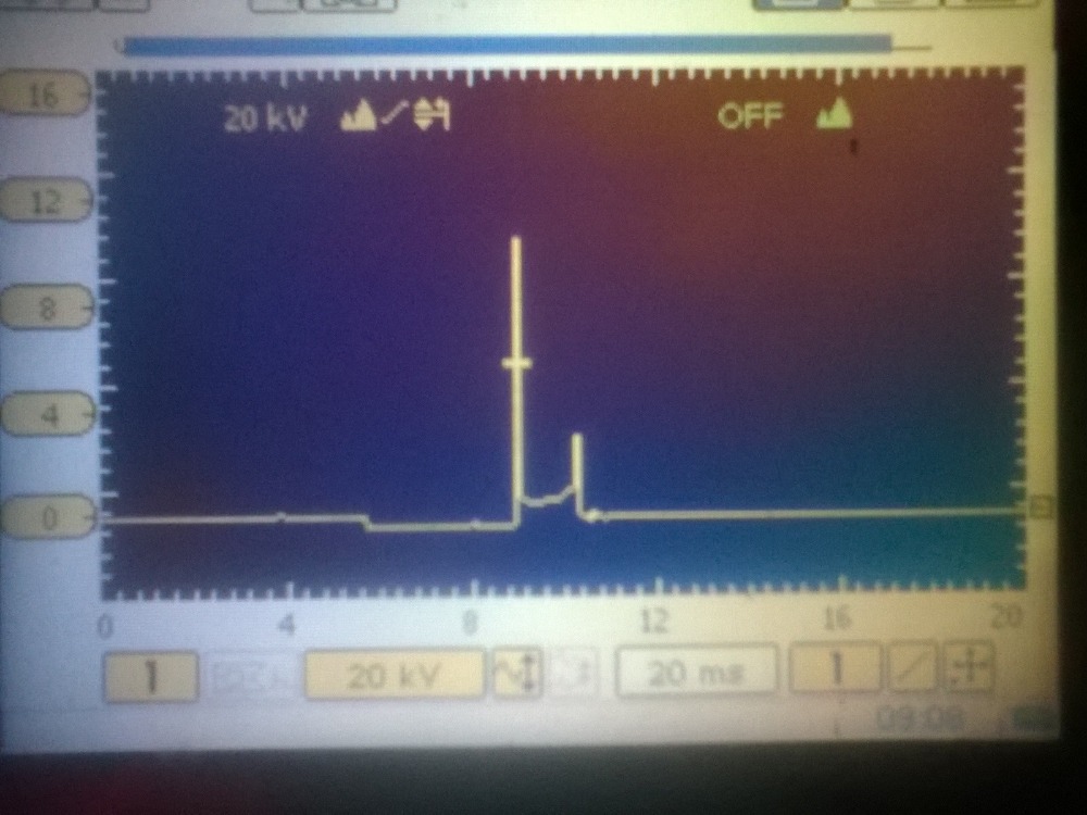

8 years 6 months ago #19979 by jeoff82
Replied by jeoff82 on topic Kv waveforms
Here are a couple of waveforms from other cylinders. NIght and day different from number 4. Also notice how the spark line leads up on the 'good' cylinders but leads downwards on C4. Still learning here so what are your thoughts on this?

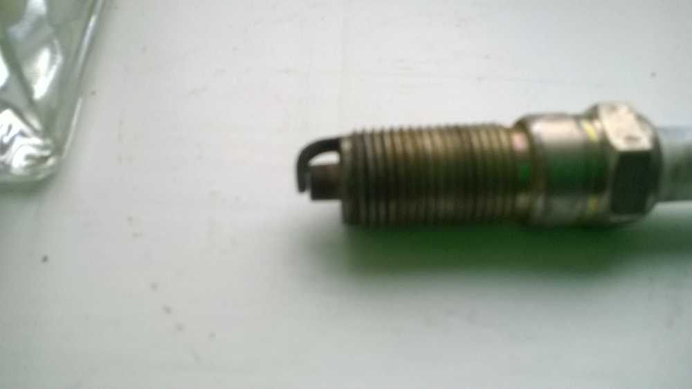

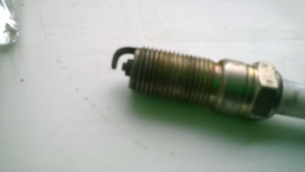

Happy to say I found the problem after looking at this car again this evening. Concentrating on cylinder 4 I removed the plug to find the gap almost completely closed up with the plug in the right way up, when turned upside down the gap reappeared! The sleeve surrounding the electrode had come loose allowing to to move to open or close the gap. Never seen this before, very happy to have resolved this. Thanks for this comments.
