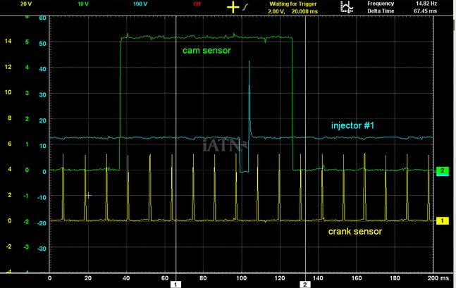

On a 03 dodge dakota 5.9l, dose anyone have a cam crank correlation waveform. I looked at one that had everything and the kitchen sink thrown at. It had new distributor, coil and crank sensor that was not put on it yet. I got a good Ac sine wave on the cam sensor but falling in voltage on the crank, I put the crank sensor last since it also had a odd coil voltage. The coil had a 12v feed bleed down to ground and I had it exchanged under warranty, now it has a steady ground with no control. With the coil unplugged there is a control signal and coil control on the scanner does the same thing. not sure that I stand on it being a pcm or bad correlation being the issue. I messed up saving the waveforms and would have to go back to capture it.

how did you get a good sine wave on the cam sensor?? on the wiring diagram it looks like a hall effect sensor 3 wire sensor. are you saying that you don't have coil control plugged in but you do have it unplugged?

Hey sir! I'm also somewhat unclear about the your coil control. You have control during a bidirectional command, but not during cranking?
Like Cheryl said, I'm surprised to hear that you got an AC sine wave out of the CMP. I borrowed this cam crank from iATN:

bidirectional I get the same as cranking, signal unplugged and full ground plugged in. I dont know what made me look for ac on the cam but did find a even high low sign signal, thanks for the waveform

1mouse3 wrote: bidirectional I get the same as cranking, signal unplugged and full ground plugged in. I dont know what made me look for ac on the cam but did find a even high low sign signal, thanks for the waveform
No worries! SUPER glad you got a good signal out of the CMP sensor, 'cause I didn't have any answers if you were still getting a sine wave :lol:
