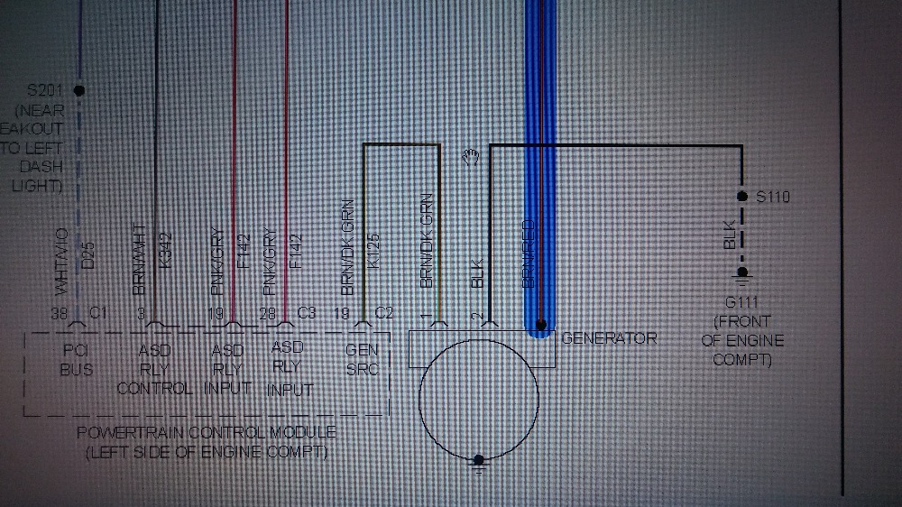

I have a question is the voltage regulator inside the alternator? Does the pcm only control pulse to the regulator? The control wire being 19 on the PCM what does GEN.SRC mean.
Thank you for your help.

Nice. B) Pretty sure this is what they're calling a 'Dual Field B' system. PCM switches power to the field coil in the alternator, and the other side is permanently grounded.

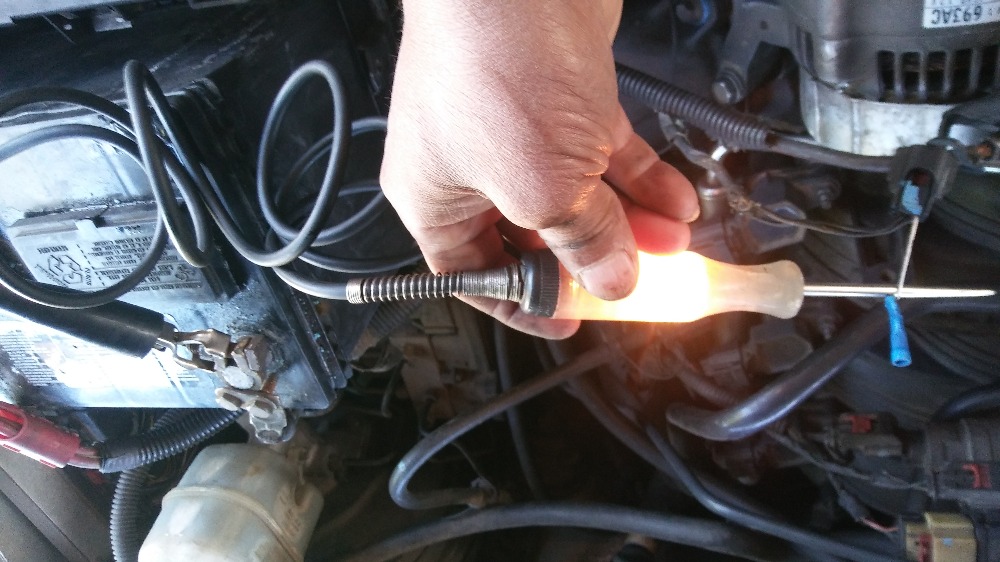

Maybe the next step would be to connect a test light to B- and probe the brown/dark green wire? That'd show the PCM a known good load. If it pulses, then SOMETHING is working. :lol:

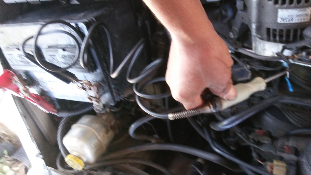

Tyler so you are saying to put batt. neg to the brn/grn with my test light. Engine on and should it be plugged in or unplugged ?
  • gilbert
8 years 6 months ago #20054 by gilbert
Engine on test light on batt. neg. Plug in i get nothing. Plug disconnected light on.

Great to hear, sir! :cheer: Monde called it, too - the PCM sensed the short and protected the driver when connected to the alternator. B) I wonder how a test light connected across the field connector would have behaved? WIth a key cycle in there to let the PCM reset.
