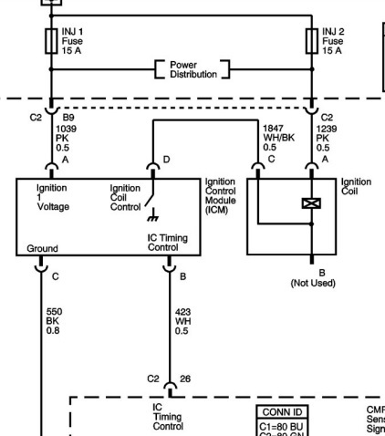

no spark... replaced icm,replaced coil still no spark. tested the icm and 3 other icm's. also not getting a 5v refrence to the icm. stumped. i would like to figure out how to test the pcm.any help would be great thanks

Any codes? Check to see if you are getting a signal from your CKP sensor.

what model is this so i can find a wiring diagram??
8 years 6 months ago #20024 by Matts Auto
Replied by Matts Auto on topic 2005 gmc 4.3
should have 12v on pink wire i believe & ground on black wire to icm
8 years 6 months ago #20025 by Matts Auto
i think 12 v on pink wire to icm comes from inj 1 fuse

he needs to worry about power and grounds at the pcm first before worrying about power to the icm as he said he doesnt have a 5 volt ref. he might have to start unplugging sensors one at a time if his powers/grounds check out to bring back the 5 volt ref

I took a shot in the dark and guessed a Sierra 1500. :huh:
Like Matts Auto said, you're looking for B+ on the pink wire and a good ground on the black, KOEO or KOEC. IIRC, the white wire from the PCM will only have 5V on it IF the ICM is working correctly. I believe that 5V is provided by the ICM, which is grounded by the PCM to command spark. 0V on the white wire would be a strike against the ICM, or a possible shorted wire.

no codes and ckp is recieving 5v

2005 gmc 1500
8 years 6 months ago #20068 by Tyler
Replied by Tyler on topic 2005 gmc 4.3
Ratrod1 wrote: 2005 gmc 1500
Then the diagram I posted is accurate. Let us know what you find with those voltage tests at the ICM, and we can help further! :cheer:
