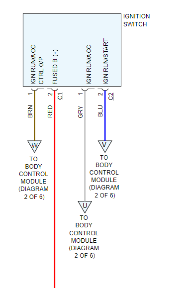

I had a cool one come in today. Took just over an hour to diagnose it and replicate the codes while bypassing the faulty component. I marked this as "fixed" even though I have yet to replace the part but I was able to confirm and replicate the problem. Tomorrow I will install the component.
2015 Jeep Renegade 1.4L Turbo AWD
Customer Complaint: Engine not shutting off when turning key to OFF position and many "service" messages on instrument panel. Electric power steering is intermittent as well. (Service Engine, Service Power Steering, Service Airbag)
My Initial diagnosis started with a code scan and I kept the ignition on with engine running in case the problem would disappear. Well the codes where a bit distracting to say the least. I saw all the communication problems and thought I should check the CAN Bus waveform so I did. It didn't look great, I'll get the snap shot tomorrow. Though the "look" of the waveform could have sent me down the head scratching abyss. I decided that it wasn't enough evidence for me to check power and grounds on BCM (common denominator) so I decided to check the next common denominator which was the ignition switch.
Long story short, there is a brown wire from the ignition switch which seems to only need to supply power during the "start" attempt. For some reason I think It supplies power in run too but I"ll confirm that tomorrow with the new ignition switch. Well issue was that the IGN switch was still supplying between 9-10.5v on that wire in OFF, ACC and RUN and 12v+ in START. I removed that wire from the equation and manually applied and removed power from that wire and was able to get the vehicle working properly. If I supply power to that wire with the ignition in any position other than START I would get all the communication codes again.
My theory is the BCM was still alive while other modules where shutting down possibly yet the BCM was still expecting communication. Seems other modules may have been slightly alive as well.

8 years 6 months ago #20133 by Tyler
That code list makes my head hurt. :silly: Thanks for posting, sir!
While this thing was acting up, how were you/the customer actually getting the thing to shut off? Pull fuses? Mostly wondering if manipulating the switch enough got the voltage bleed on the brown wire to go away.
8 years 6 months ago #20136 by Noah
Nice, good work ;)
Did the cluster and accessories power off as expected with the ignition off even though the engine stayed running?
It's not really important, I've just seen multiple Ford Esacpes latley with failed ignitions. Some won't crank, one wouldn't stop running.
  • graywave
8 years 6 months ago #20148 by graywave
Customer was unable to get the engine to shutdown once it failed. If i played with the ignition switch enough or left it in the off position long enough eventually it would shut down. Later i just found reaching up and unplugging the IGN Sw worked to shut it down when in the off position.
All accesories and cluster stayed on as well when the ign was off and key was out. I think i noticed the heater blower didnt work when it acted up and ign was off.
Replaced ignition switch btw and it works

Is it possible to put a toggle switch on the brown wire to shut off the continuous power flow to the bcm to at least temporarily fix this issue?
