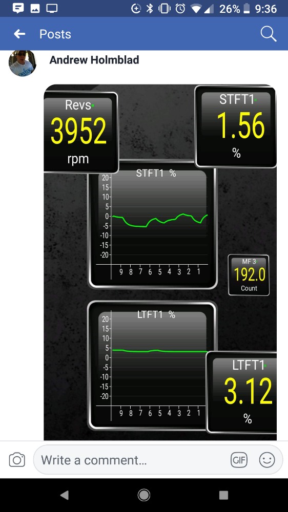

Truck has intermittent cylinder 3 misfire count usually when the engine revs above 3k and comes back down the misfire count increases after rpms settle back down also happens when maintaining speed at higher RPM and step on clutch to coast or slow down the misfire count increases by 1-30 counts.
SEEMS worse on colder days or when I don't allow the truck to warm up.
Sometimes I'll go 20 miles before any misfire counts start happening on cyl 3.
Sometimes it'll misfire at idle frst start in the morning when cold and the misfiee count shoots up to 180+ in 5 minutes of driving and throws a CEL. once warm the misfire count either stops increasing or increases slowly on coasting/decelerating and count goes up really slow by 1-30 each misfire "event"....

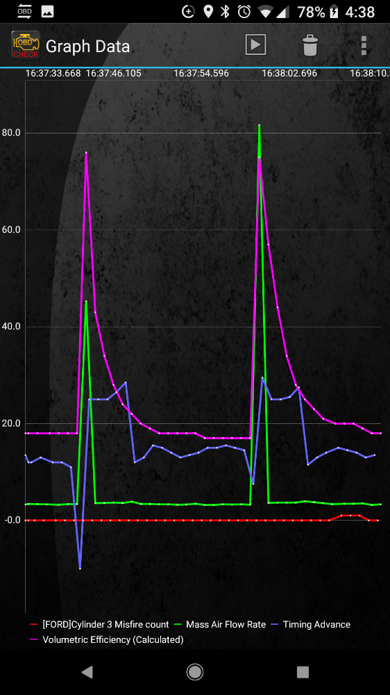

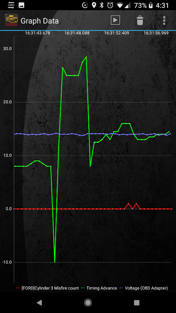

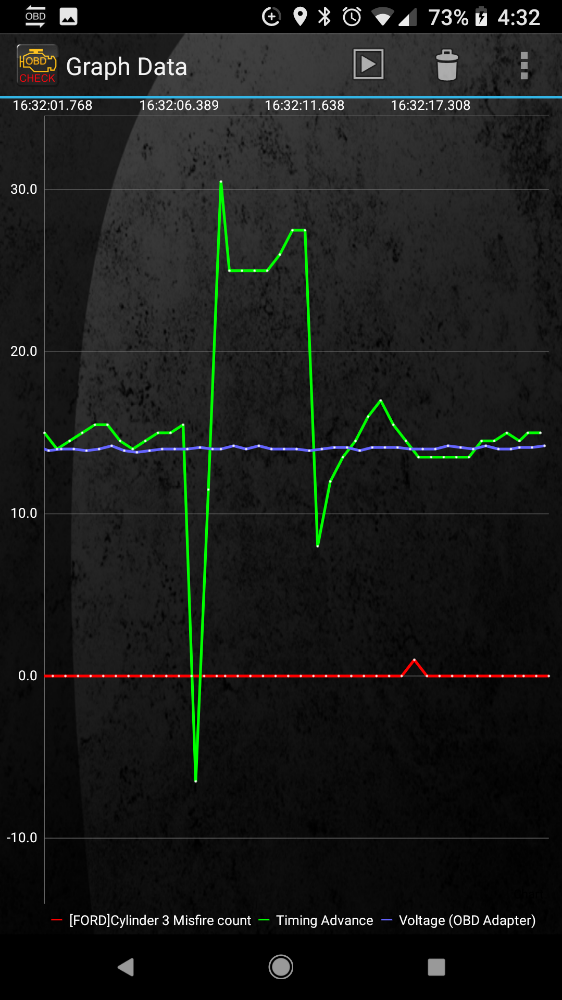

When I goose the throttle I can see my graph of timing advance vs misfiee count and the only coorelation I can see is the timing advance goes up and down and once it goes down and rpms have dropped to normal the engine timing advance had a small/medium BUMP where it blips itself up for a tiny bit and back down... The misfire count seems directly related to that miniature bounce in timing after the throttle blip.
