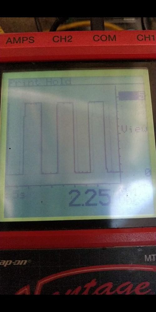

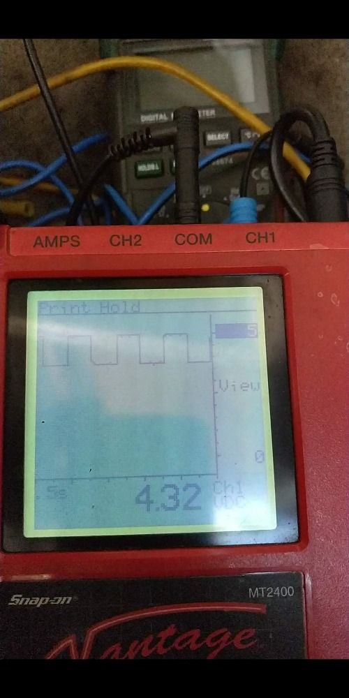

Hello guys I'm back with and update
The problem was the ECU it wasn't grounding the signal all the way to 0. volts and that's way the cluster didn't work
i'm going to put few screenshots of the before and after readings at the cluster.
this is the bad signal
and this is the good siganl

Maybe I should have asked about the specifics on the waveform earlier on? :blush: Speaking of, it looks like the ECM is varying how far down it's pulling the signal. The Verus capture shows it going down to 2-ish volts, but the Vantage shows about 4V. :blink:
