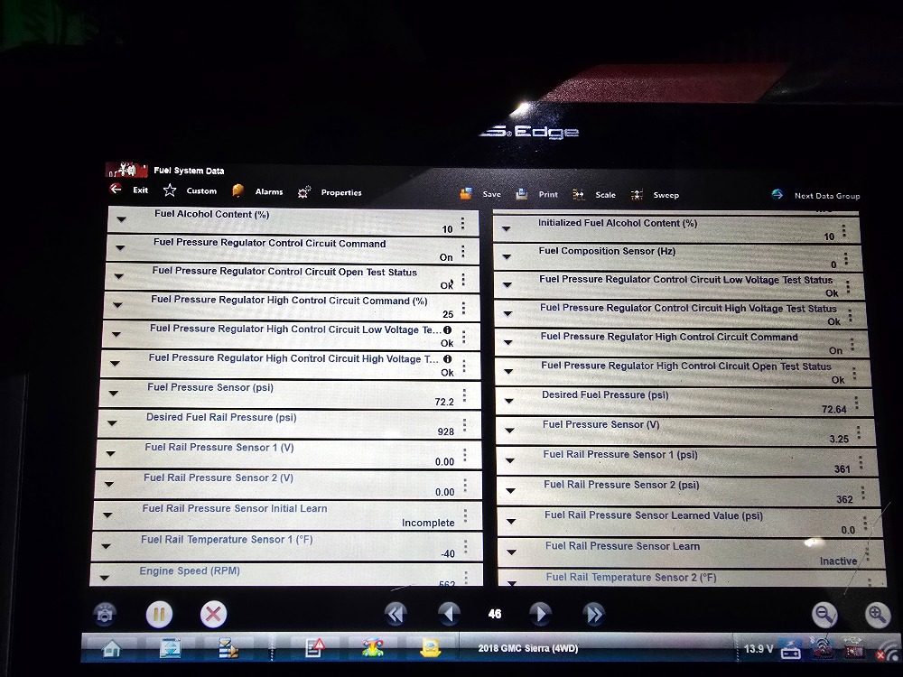

Hello, I have a 2018 GMC Sierra 5.3 engine code C Gas with a 8 speed transmission. Check engine light and engine power reduced are turned on. Scanner shows 1 code, P228C, which says fuel pressure regulator 1 exceeds control limit - pressure too low. When i chech the live data you can see that the sensor does show pressure on the fuel rail, but the voltage on it remains at 0. This sensor also detects the fuel rail temperature and that is at -40. Truck turns on and idles but has little to no power. I checked the wiring and everything has continuity. I replaced the fuel rail pressure sensor, the high pressure fuel pump and the ecm and it does the same thing. The sensor is a 3 wire sensor. Both the ground and the 5v reference are good, but when it comes to the signal, the wire remains at almost 5v and the scanner shows it has 0v. Even with the sensor unplugged the scanner still shows the same 0v on the sensor and the pressure ready raises to 98,000 i believe. I cant remember the exact pressure but it rises a lot. Also the scanner says that the fuel rail pressure sensor hasn't been learned and thay learning is disabIed. I would appreciate any help with this issue, thanks!

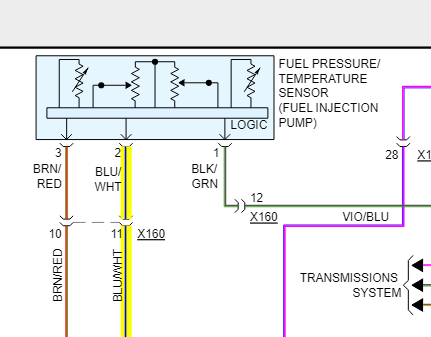

The fuel rail pressure sensor transmits fuel pressure and temperature information by serial data using the Society of Automotive Engineers (SAE) J2716 Single Edge Nibble Transmission (SENT) protocol. The fuel rail pressure sensor internal microprocessor allows 4 separate sensor outputs from one 3 wire sensor. The ECM supplies the fuel rail pressure sensor with a 5 V reference circuit, a low reference circuit, and an asynchronous signal/serial data circuit. The asynchronous signal means communication is only going from the fuel rail pressure sensor to the ECM. The ECM decodes the serial data signal into separate voltages which are displayed on a scan tool as the voltage inputs from the Fuel Temperature Sensor, Fuel Rail Pressure Sensor and Fuel Rail Pressure Sensor 2.
Identifix testing procedure states the signal wire should have 5 volts with it disconnected.

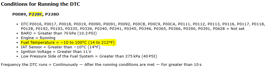

I don't know why the fuel temperature is showing -40 degrees F because then it wouldn't run the P228C check if that was true.
Keeping it simple, the high pressure pump can't produce the high pressure or there's a leak somewhere.

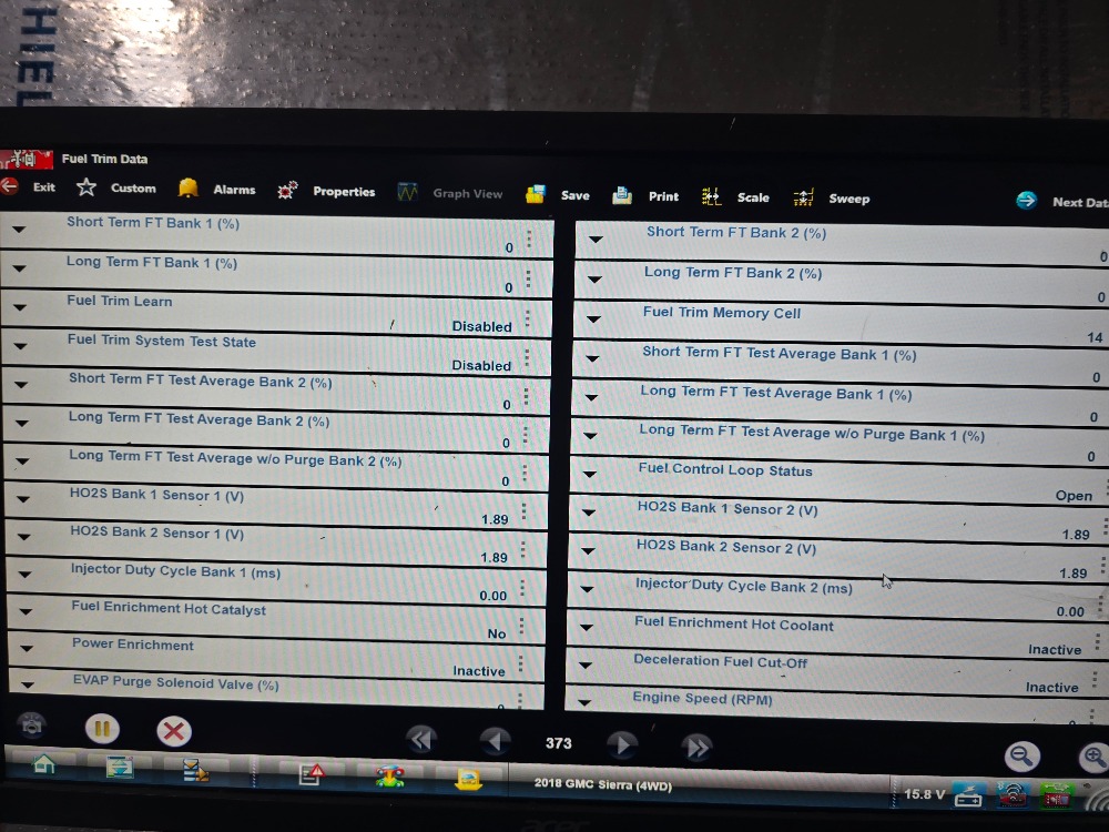

I was checking all the vehicle data while it was idling and i found a O2 sensor that does the same thing as the fuel rail pressure sensor. It displays data but doesnt shoe voltage. Do you know how both sensors are calibrated before initial start if engine? I read that the FRPS is calibrated every key cycle. So I was wondering what takes care of the calibration. I know its the ECM but what gives it that command, or what wires are the ones that power that action?

I'm inclined to agree with ferris48 about the high pressure fuel pump. The ECM asked for a specific amount of pressure and didn't get it. What's the highest fuel rail pressure you can get out of the pump while commanding it with the scan tool? What brand of fuel pump did you install?

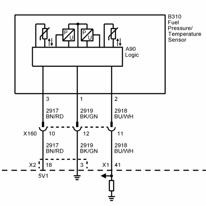

About the fuel rail pressure sensor and temperature voltages - those PIDs may be invalid. From service info regarding the B310 Fuel Pressure Temperature Sensor:
The control module uses the fuel rail pressure sensor to constantly adjust the high pressure fuel pump's feed rate so that the ideal pressure is permanently maintained in the high pressure section (between the high pressure fuel pump and the injectors) by means of a closed loop control. The fuel rail pressure sensor transmits fuel pressure and temperature information via serial data to the control module K20. The sensor's internal microprocessor allows 4 separate sensor outputs from one 3 wire sensor.
In other words, the sensor doesn't generate a normal analog sensor signal, therefore there's no voltage value to display.
It doesn't help that previous versions of the L83 engine actually DID have a fuel rail pressure sensor with two analog outputs. Your Snap-On scanner may be incorrectly displaying those PIDs because it uses the same PID list for both versions.

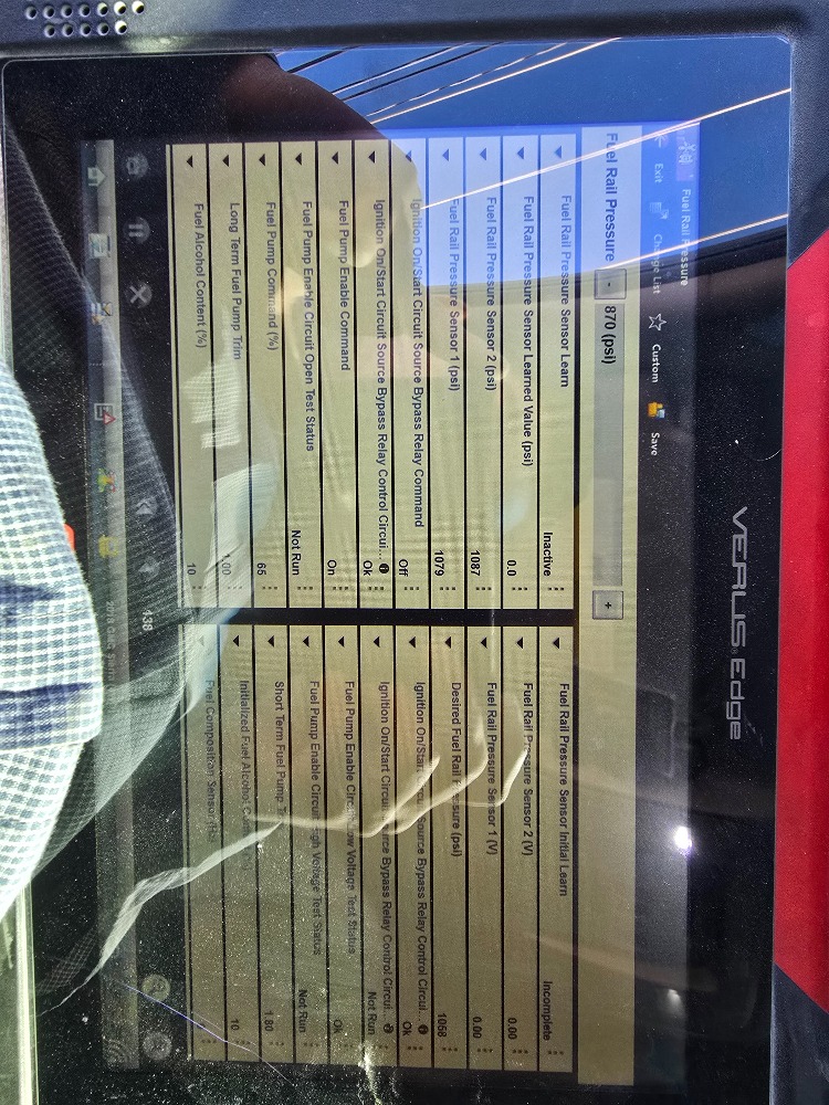

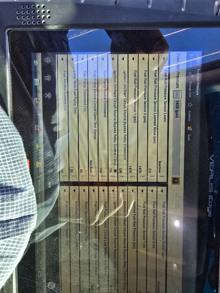

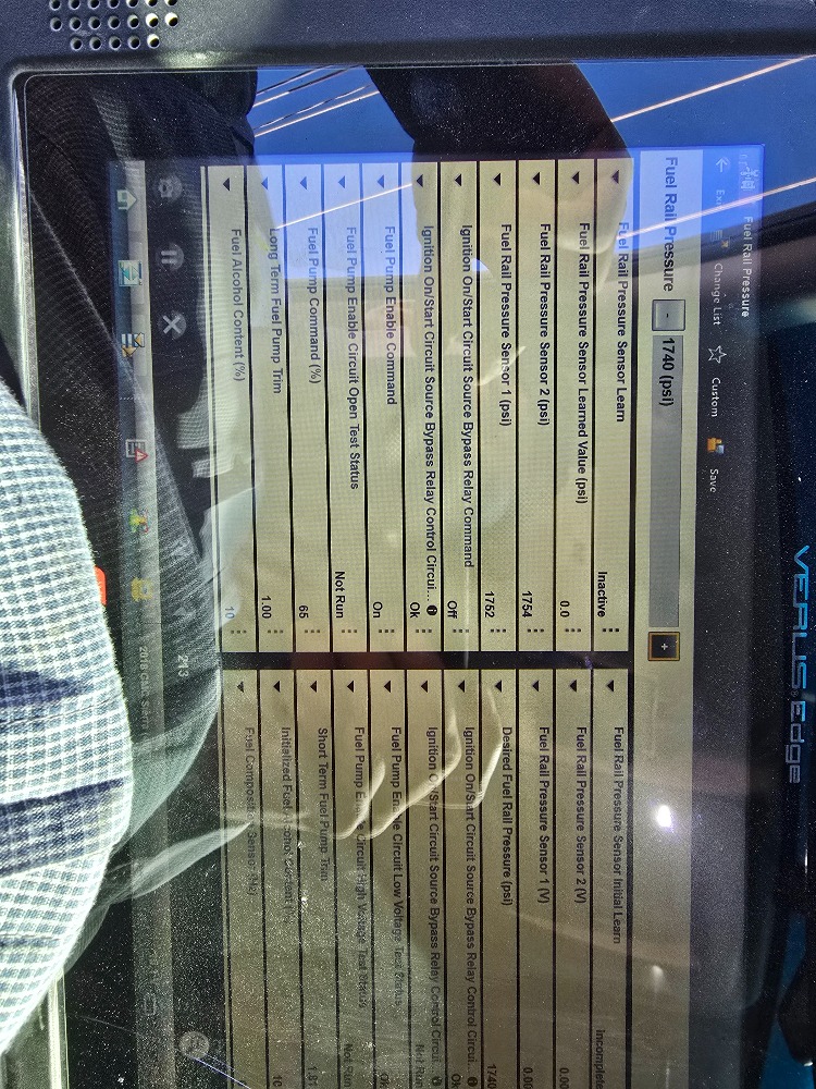

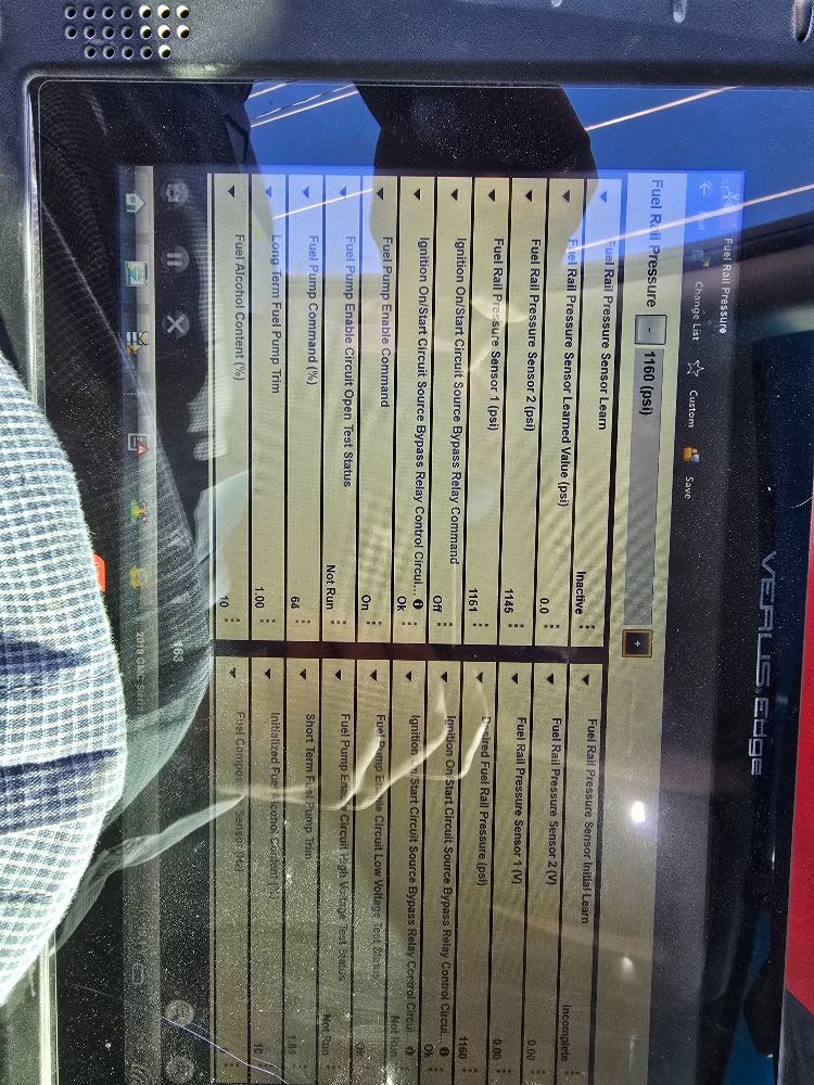

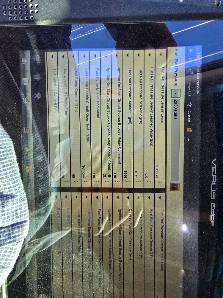

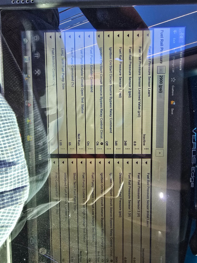

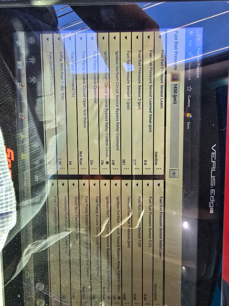

I attached some pictures, with some information. When i accelerate it for a little while and let it idle i can adjust the pressure to whatever i set it to, but if i just turn it on and idle it it will just remain at 350 more or less. After a while of idling after accelerating pressure drops down back to 300. After i accelerate it for a little while, i can adjust the pressure for about a minute. If i keep accelerating it and adjust it, i can reach almost 2,000 psi before it drops down to 350ish. We are currently in our 4th pump from Orreylis. I checked the injectors as well and they dont seem to be leaking. I added pressure to the injectors and they held pressure. I dont smell any gas on the oil either
1 year 9 months ago #81263 by ferris48
Now I'm inclined to check the low pressure side. Check for fuel volume and verify with a gauge. This problem is present at idle, so no need to drive it around with a gauge on the window I think.

1 year 9 months ago #81264 by Christian9000
I just checked it and it is as the sensor reads, pressure does not drop past 70, and when i accelerate, pressure rises to about 80ish psi. Also since the last testing i did, the pressure does not want to go above 800psi. Pressure will go to 800psi and drop down in less that a second to 300. Even if i accelerate like i was doing before, pressure stays at 300ish. In addition, the last test before this happened, i was commandind the pressure to be at 2400 psi( only ever reached about 2000psi never any higher) i started hearing a wine, kind of like a supercharger wine, and then a pop. Pressure hasnt gone up since. My guess it that i blew the pump, furthermore, now there is a slight ticking sound on the top end. I hear it under the intake. Im going to remove it once again and check. Either the pump when out and something happened to the spring, or the roller for the pump when out. Im hoping thats the issue.
