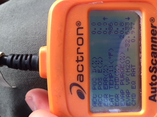

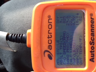

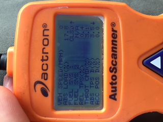

Hi all, I am investigating an issue on a 3800 series GM. Unfortunately I recently lost access to my Mitchell on demand account so I have been shooting in the dark while troubleshooting an intermittent throttle actuator problem. Does anyone have a pinout of the connector going to the Throttle actuator controller? It has 13 wires coming out of it (although the connector has more pins that are not used and have dummy plugs in them). In addition, if someone could help me out with a little systems operation that would be great! I have multiple PIDS on my scan tool all relating to throttle control but im not sure which ones relate to the pedal position sensor and what relates to the actuator itself. I figure there is an input from the Accelerator Pedal Position sensor and then some kind of signal from the ECM... also i figure there are multiple potentiometers inside the controller to provide feedback from the stepper motor??? Just guessing though. Anyway just looking for some solid information, I appreciated anything you got!

Ok I think your highway hiccups and your no throttle control are two separate issues well deal with the throttle control first since that is most important. you should have app1 app2 app3 related to your accelerator pedal if any of them doesn't agree you will lose throttle control, I don't remeber what there values should be but it's logic is something like this 1 will start out under 1 volt and climb to almost 5 volts moving pedal from closed throttle to wide open at the same time #2 will start at up close to 5v and come down to under 1 volt at wide open throttle both 1 and 2 should always add up to 5v total (combine 1 and 2 voltage) and I can't remember what 3 done it was a lesser number I believe all on its own . These throttle bodies are pretty picky about being dirty if you haven't cleaned it now would be a good time to go ahead and do that the absolute throttle position is cut and dry it's just the position of the throttle blade at idle I believe were somewhere around 12% I don't remember exactly but a dirty throttle body will have a higher %at idle than a clean 1.

Thanks again for your input. I figured there were at least two separate potentiometers in the APPS for redundancy, and I had seen in the past that the two operated inversely of each other. I was able to dig a little deeper into some internet research today and came across this awesome video (see below) that verifies your thought that there are 3 separate pot signals in the APPS; however, I have the Type 3 system. Which it does not explicitly label the corresponding APPS signal picture, but I assume when they say "early systems had 3 signals" it means my Type 3 will have the 2 signal sensor. I was also amazed that they are pulling the Vref signal to ground at a fixed frequency on the second APP signal! I can only assume that they are doing that to more or less create a Digital input from an Analog one because they are effectively "sampling" the signal value at that frequency... not sure what benefit that provides but cool to see! I am going to probe my APPS in the next day or two to confirm this but I also noticed today on my scan data that there is only two PIDS labeled ACC (D and E) while the other PIDS (ABS TPS and REL TPS) seem to be the pots built into the Throttle Actuator Controller up at the valve itself. Anyway, I actually did clean my whole throttle assembly about 10k miles ago for no reason other than just typical maintenance when I inherited the car. I believe at the time my idle TPS reading was somewhere between 9-12??? I think I wrote it down in my service notes but I will have to double check for you. Regardless, once I conducted the cleaning (which it needed) I actually brought the idle TPS reading down to about 2 or 3, so it definitely made a difference. I have attached a photo of my little scan data read out from this morning (car hot and idling at the end of my commute). I guess my question at this point is, do I go after the APPS for an intermittent drop out? Or does it seem like an issue on the TAC side? Keep in mind monday afternoon was the very first time it had trouble idling at startup and for a few minutes had little to no response to the pedal input... just acting wild and crazy for a few minutes before I cycled the key off and it came out of it. One other little tidbit is that monday afternoon it rained extremely hard while my car was just sitting out in a parking lot, which doesn't seem like a big deal but I do park it in my garage every night so it doesn't see a whole lot of moisture for the most part... just something that crossed my mind. I also came across a post on a forum today about a fuse that powered the TAC being corroded and creating kinda similar symptoms to what I have. I guess the TAC was effectively turning on and off intermittently from the high resistance on the power supply, but I just breezed over the post so I forget the details. Again thanks for your time, hopefully we can make some progress on this thing!
PS. One other thing I was looking into today was the difference between REL TPS and ABS TPS. From what I gathered Relative is the learned value, or the calibrated value I assume. Im not for certain, but when I used to work in the heavy equipment world we would have to calibrate a new tps when we put it on so that the computer could see the whole pedal sweep, and I was told that was because the linkage of the pedal may not allow the pot to sweep entirely the length of its carbon strip, which would mean you could be at full throttle demand but only read 80% or something like that. But once the calibration is conducted the computer learns that 80% of the pot is physically 100% of the pedal travel. So I assume its similar to this but if you have any input Id love to hear it!
