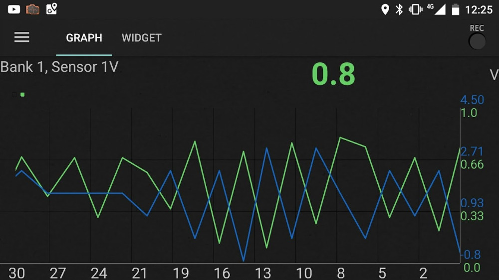

Has anyone ever seen short term fuel trim jumping from positive to negative very quickly (as fast as the Snap-on computer can update, approx every 1/3 of a second)? Pos 5, pos 18, neg 3, pos 23, neg 14.
What could be the reason for this?

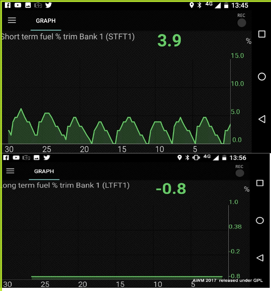

Replied by Andy.MacFadyen on topic Short term fuel trim
STF closely following the upstream O2 is pretty normal but the numbers seem a little big what manufacturer and engine ?
With STF you have to pick an average value and look at that in relation to the longterm fuel trim.
This the only screen cap I have to hand of STF

8 years 6 months ago #20242
I took this screen shot today it shows how the Short Term Fuel Trim almost mirrors the upstream O2 sensor
B1S1 Voltage output is green trace STF1 is blue trace.
