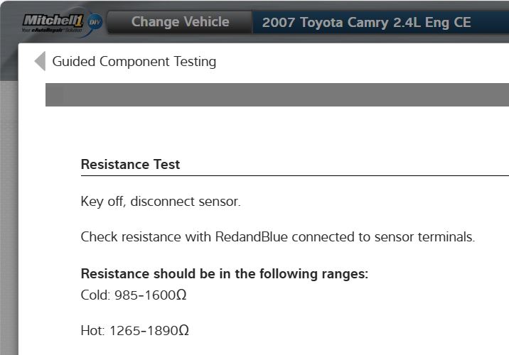

Anyone who has a subscription to Identifix or All Data have time to look up the resistance spec of the crankshaft position sensor on a 2007 Camry 2.4L? I have Mitchell and just want to verify what other sources say it is, to make sure it's not a misprint.

Thanks. What source was that from? That's very interesting. Here's what Mitchell shows. I wonder why different sources show different values? I would have thought there would be 1 spec from Toyota, no matter what service data source we use.

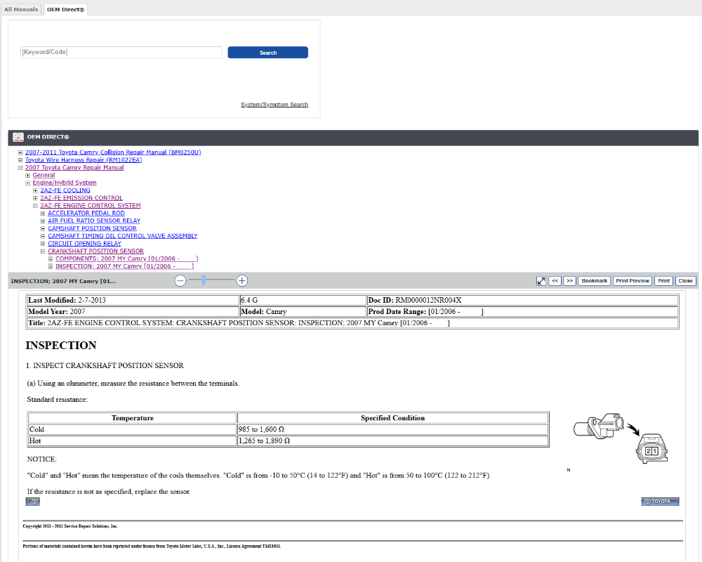

If I dig into OEM DIRECT I found what you found on Mitchell:
Replied by ferris48 on topic Crank sensor resistance?
I'm using Identifix and searched for p0335 typical crank sensor code.Thanks. What source was that from? That's very interesting. Here's what Mitchell shows. I wonder why different sources show different values? I would have thought there would be 1 spec from Toyota, no matter what service data source we use.

Check out this PDF
pdfhost.io/v/NHtE7oZjO_2AZFE_Engine_Control_System
Type in the page number in the upper left to jump to them.
Page 377 shows the Mitchell specs and the one from OEM DIRECT on Identifix
Page 185 shows a different resistance spec when you search for P0335
Hmmm, interesting...
