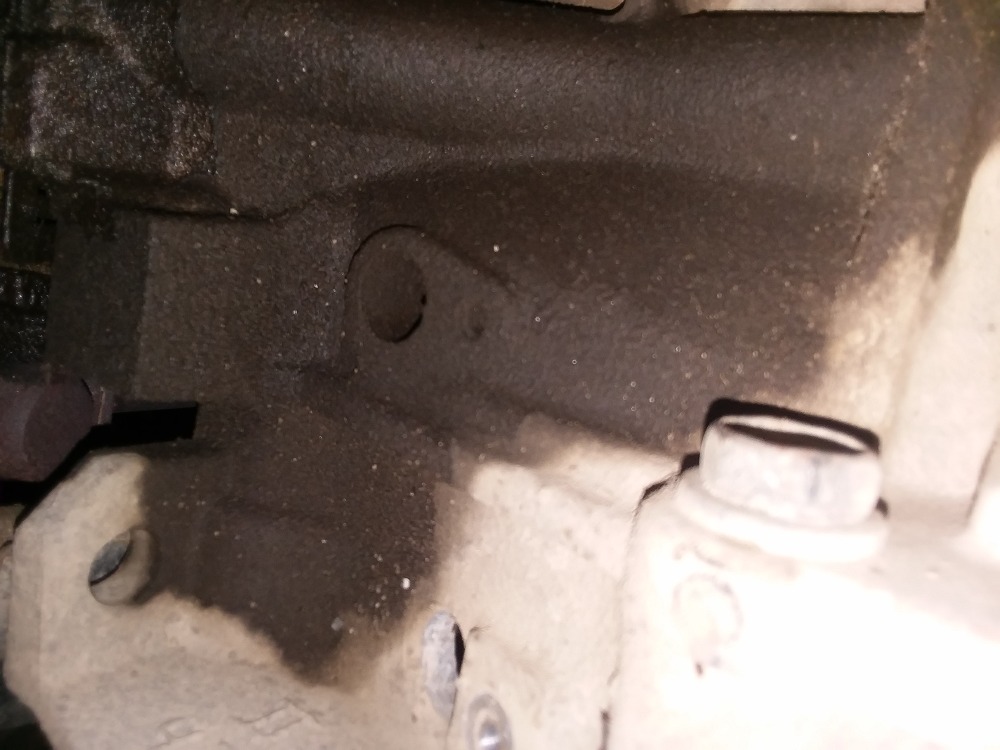

8 years 6 months ago #20365 by landlordsunited
p0335 was created by landlordsunited
I have a Chrysler 300m 1999 3.5 high output engine in a 2004 300m. The car has never ran good since the engine was installed. I took it to a retired Chrysler mechanic. He was going to replace timing belt and water pump and said it probably needed a crank sensor. I bought one but couldn't get it in the hole so I put the original back in. I took it to him to install when he was to replace the timing belt. When I picked the car up he said he had no problem getting it in. The car would start misfiring and shake and I would stop on the side of the road and turn the engine off and back on and it would run good for hours until it happened again. After talking to another mechanic, he said replace the crank sensor. I removed it and the plastic cover over it was half gone. I went to NAPA with it and got another like it. I couldn't get it in the hole. It was for a 2004 they said. Got one for a 1999 and it won't fit either. Went to junk yard and searched thru half a dozen 300m's and only one had something in the hole and it was a 115v 400w heater. That car was tagged a 2001. Don't know where the crank sensor is on that engine. The car will finally start with or without a sensor. Any ideas would be appreciated.

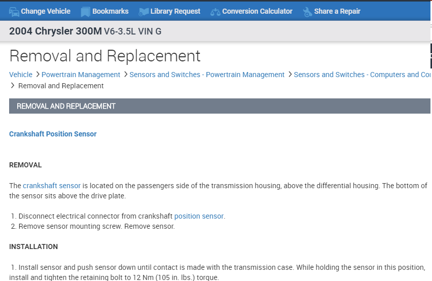

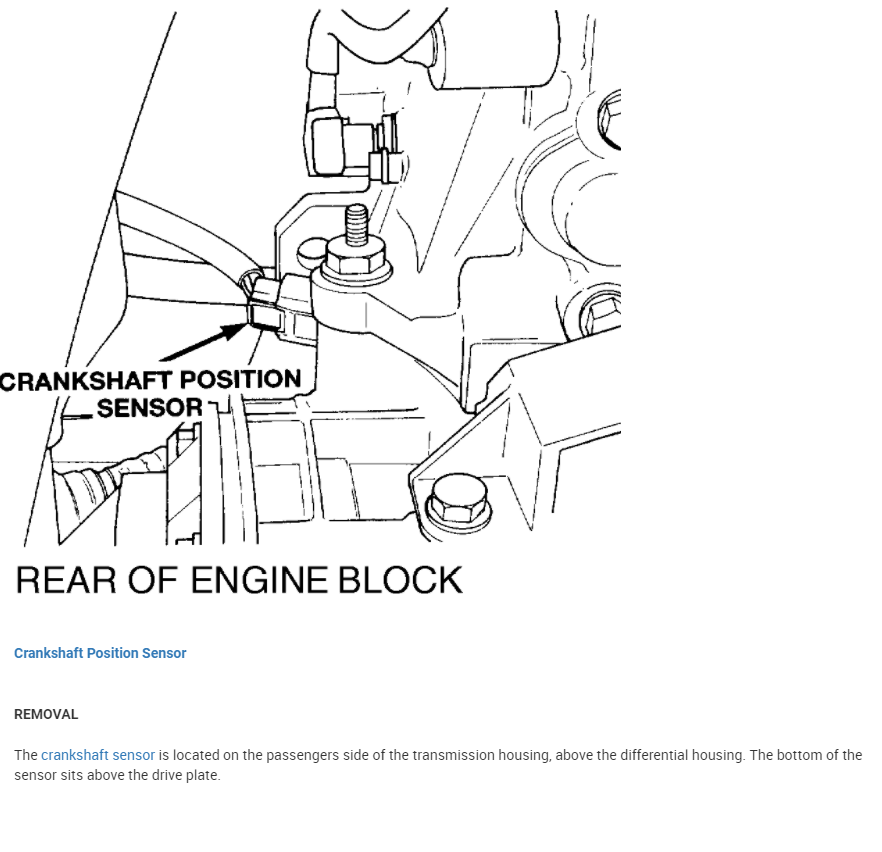

8 years 6 months ago #20391 by Noah
Replied by Noah on topic p0335
[quote="landlordsunited" post=20365 I bought one but couldn't get it in the hole so I put the original back in. I took it to him to install when he was to replace the timing belt. When I picked the car up he said he had no problem getting it in. Went to junk yard and searched thru half a dozen 300m's and only one had something in the hole and it was a 115v 400w heater. Any ideas would be appreciated.[/quote]
This is making me think maybe you're working in the wrong area? Not trying to insult you at all, but a block heater is in the engine block. Usually in the place of a freeze plug.
The crank sensor on these cars is in the transmission bellhousing.
Can you maybe post a pic of what your working with and where?

Hey Noah when I looked it up it showed it as going in the timing cover on this engine and not at the flywheel what info do you have ?
8 years 6 months ago #20397 by Noah
Replied by Noah on topic Re:p0335
That's from alldata, i checked for the model year of the car and the year of the engine he's got.

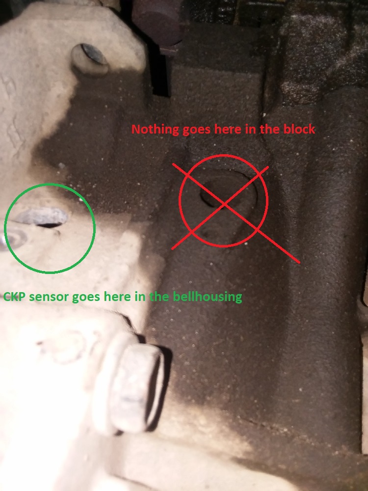

8 years 6 months ago #20406 by Noah
There's a dummy hole that nothing goes in inches away from the crack sensor cavity that looks like it's meant to hold a sensor.

8 years 6 months ago - 8 years 6 months ago #20410 by Noah
All data shows the location is the same for an 04 and a 99. Are you using Mitchell or Google or BBB or something?
At a minimum the installer had to have changed the harness and very likely the flywheel and camshaft reluctor to make everything kosher with PCM.

8 years 6 months ago #20411 by Noah
8 years 6 months ago #20441 by Ben
Replied by Ben on topic Re:p0335
Ha you are right Noah I don't know what I looked up the other day that said it was in timing cover I must have had another vehicle open. Sorry for the confusion.

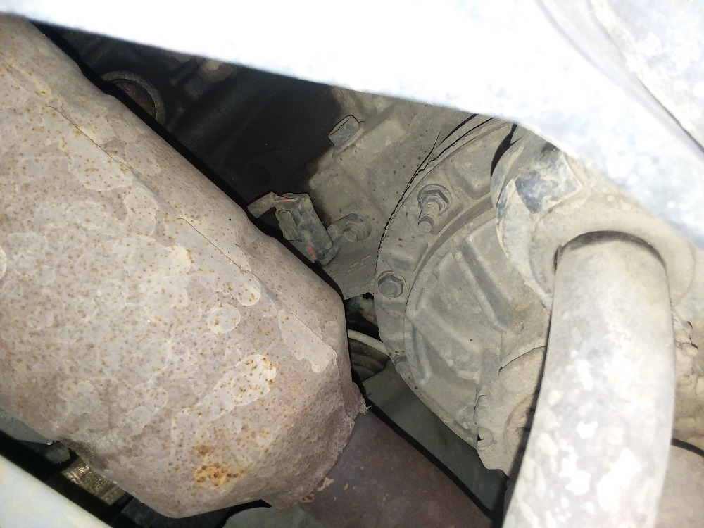

8 years 5 months ago - 8 years 5 months ago #20568 by Noah
Just so we're perfectly clear... And even if you did remove something from the hole on the block, it was not the crank sensor.

8 years 5 months ago #20587 by landlordsunited
Replied by landlordsunited on topic Re:p0335
Boy what a difference when you are in the right hole!!!! Thanks Noah

8 years 5 months ago #20607 by Noah
landlordsunited wrote: Boy what a difference when you are in the right hole!!!! Thanks Noah
You're welcome. Does it run better with the new crank sensor?
